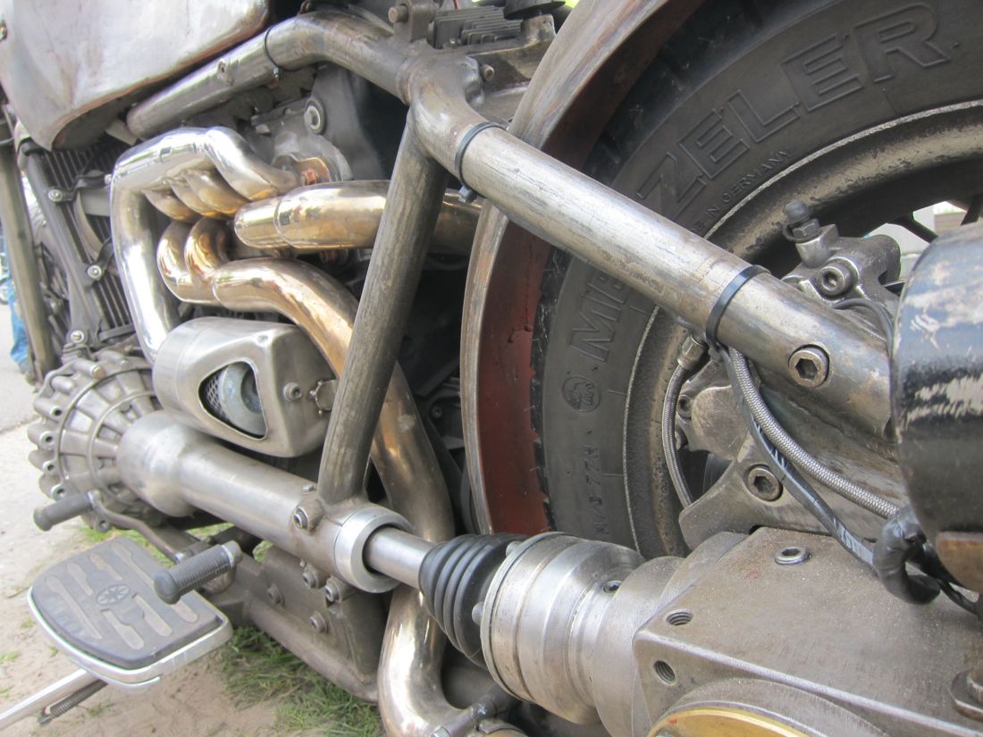

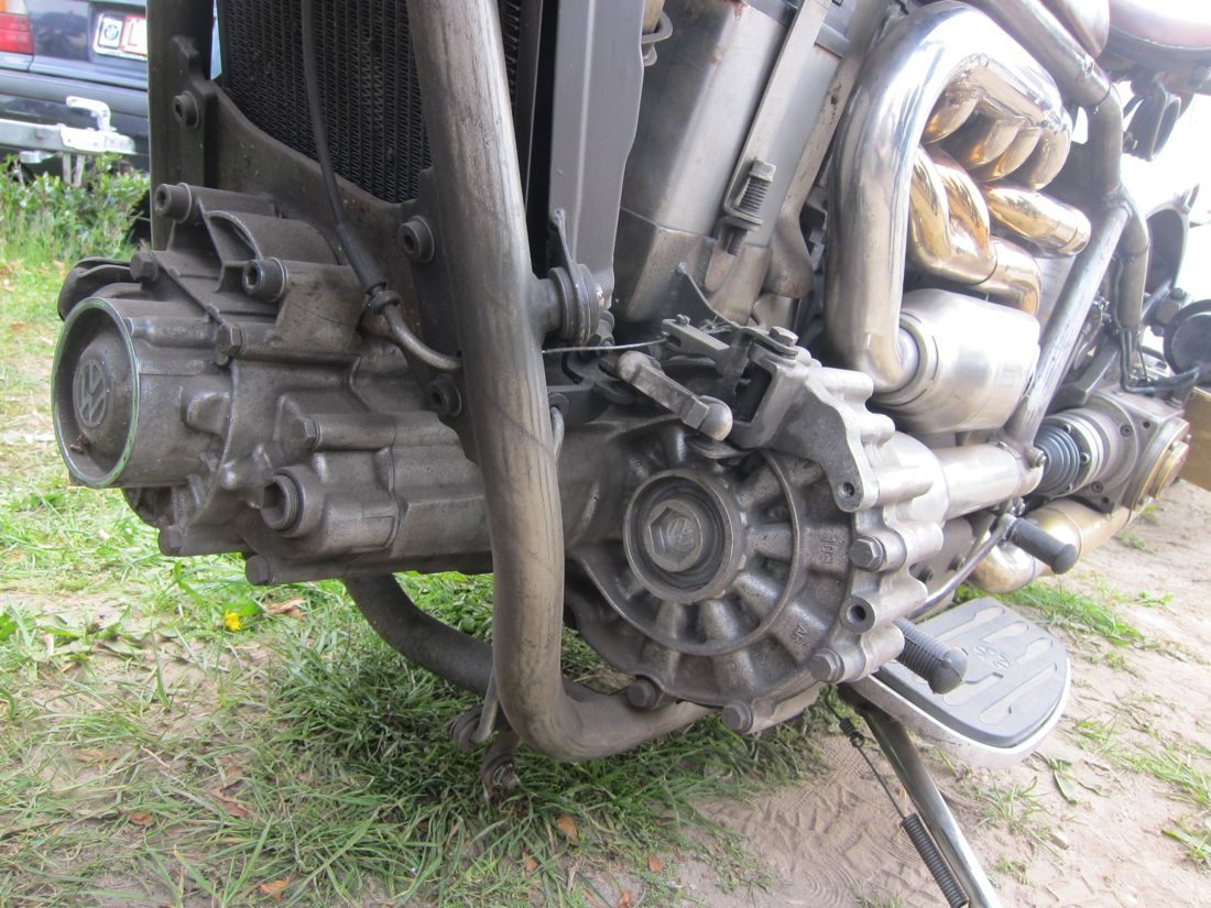

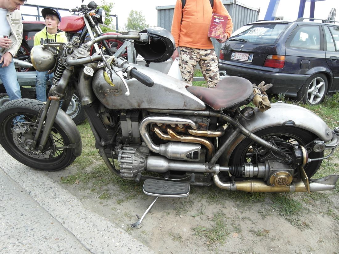

If you've not seen the ultimate mother of all VW diesel bikes, check the pics below. I believe it's the 1.6L. But, no small bike. Likely the most compact form one could conceive, short of an east/west orientation. And utilizing a right angle gear box for the final drive solves the ratio dilemma as they can be had in whatever ratio you desire. It does however leave you with a hardtail and having used little of the original Wing frame.

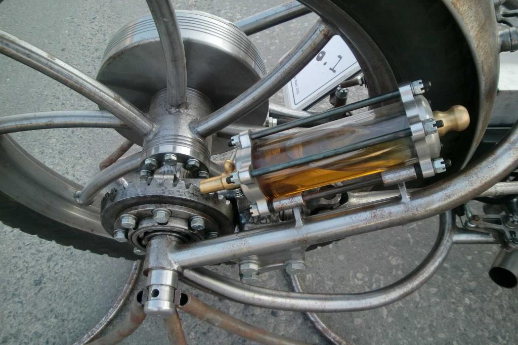

Of course you could always cut your own final drive gears. But then, oil consumption might approach fuel consumption.

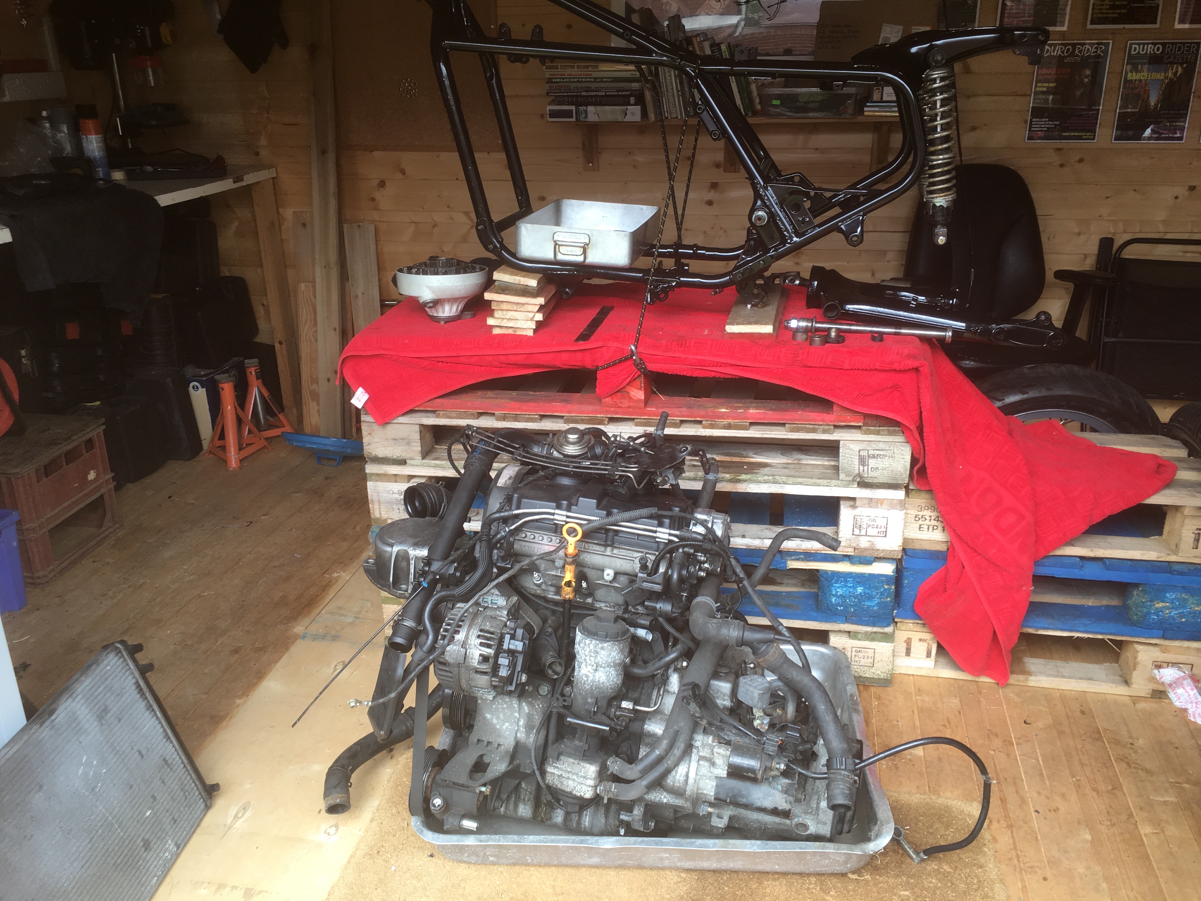

OK have now got the donor bike (bought in pieces) and I'm working through it to make sure I have what I need. Last night I got my VW 1.4 TDi and started to work out dimensions and look at places to chop the frame to accommodate it.
All seems plausible but then I got my thinking cap on and that's where it all went wrong. I started to investigate the electrics of the engine and primarily the ECU and all of the sensors that could stop the engine running properly or prevent it from starting. It seems there are more than I realised and many of them are mounted on the car, that it would have come from, and most of them seem to require a specific component which will not work on any kind of motorcycle set up.

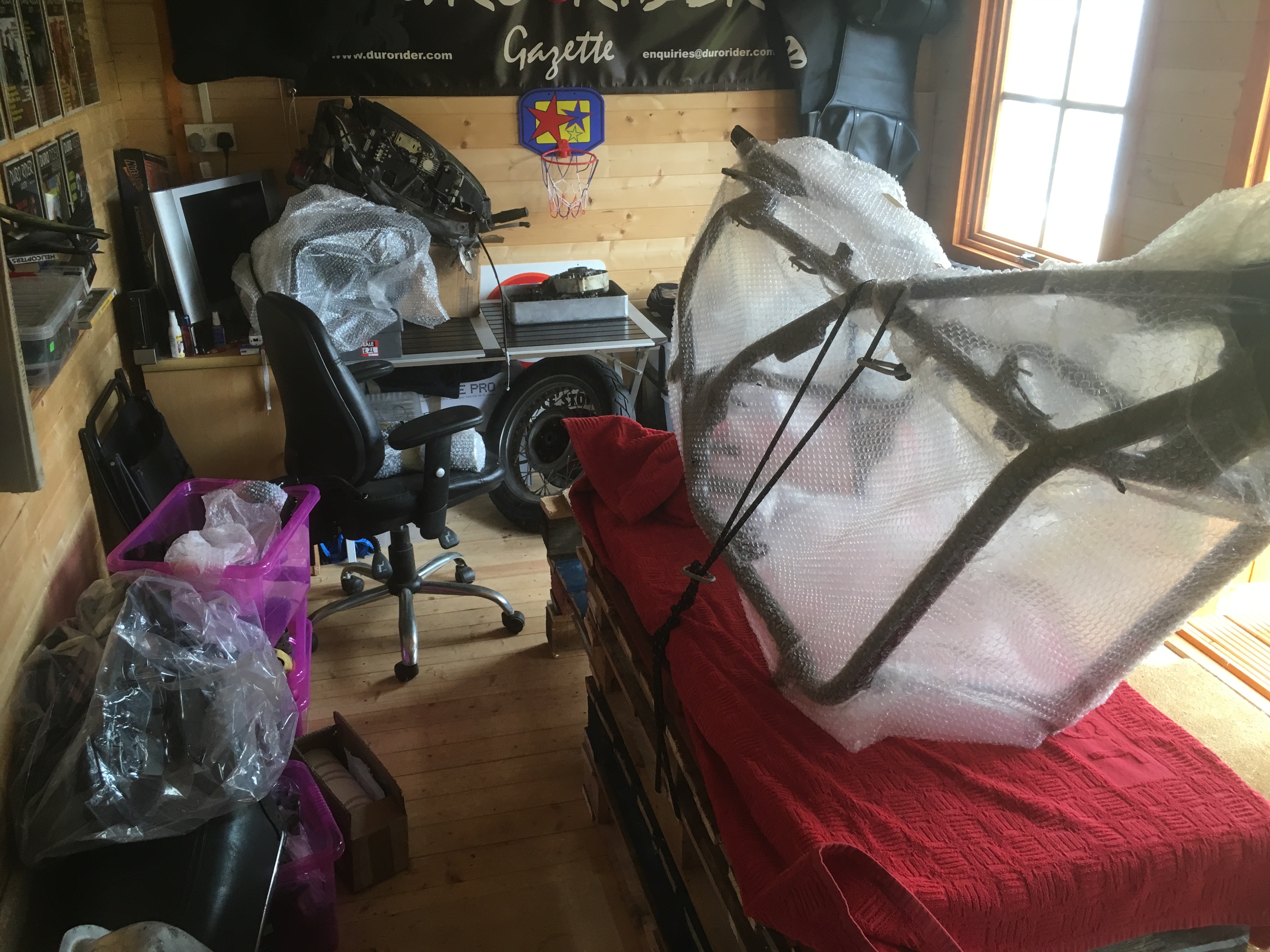

GL1000 bike parts and frame on build platform as I work through all the parts that I need and work out what is missing

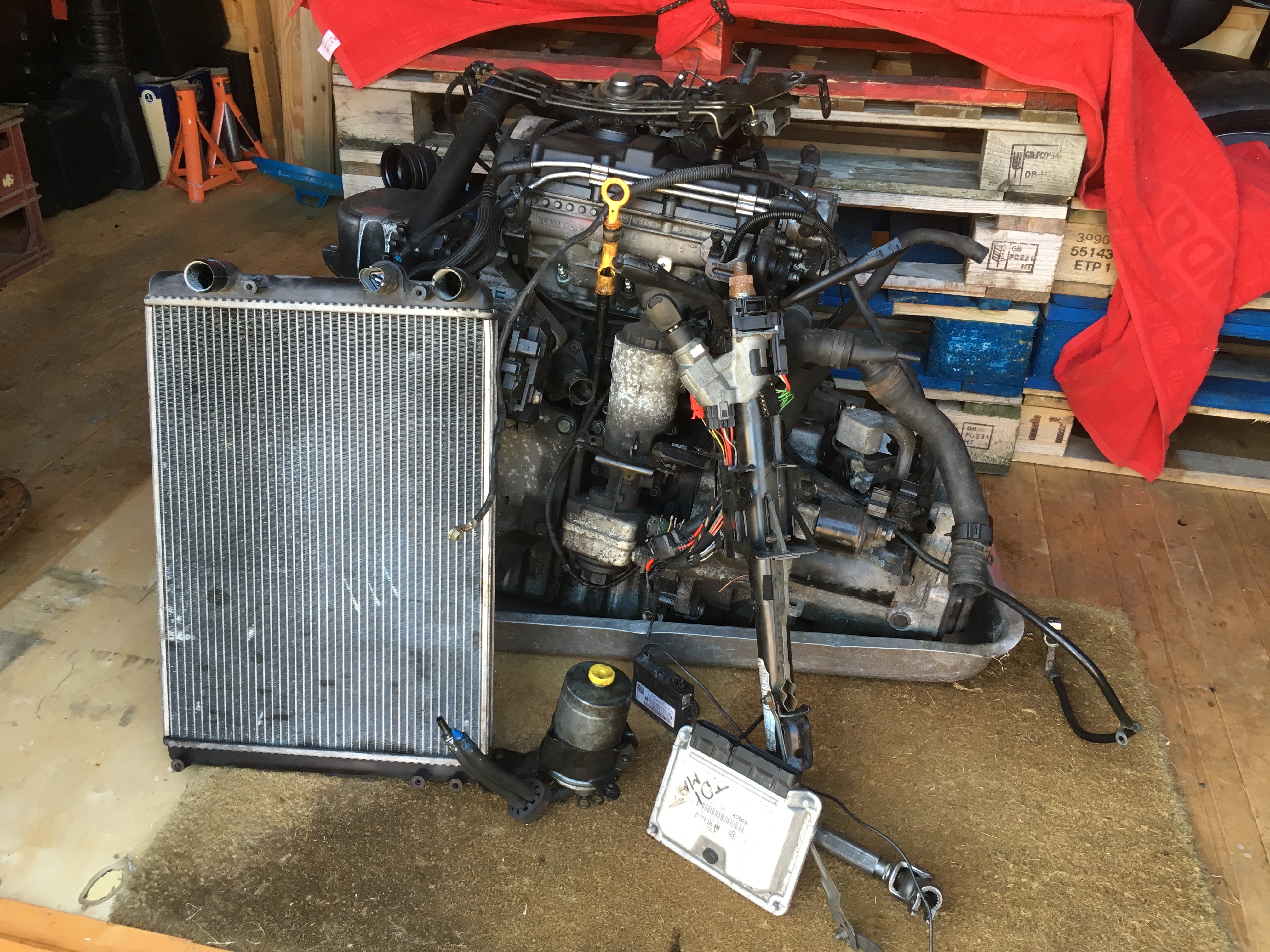

Engine arrived but now trying to work out how to bench test it before I start cutting up the frame

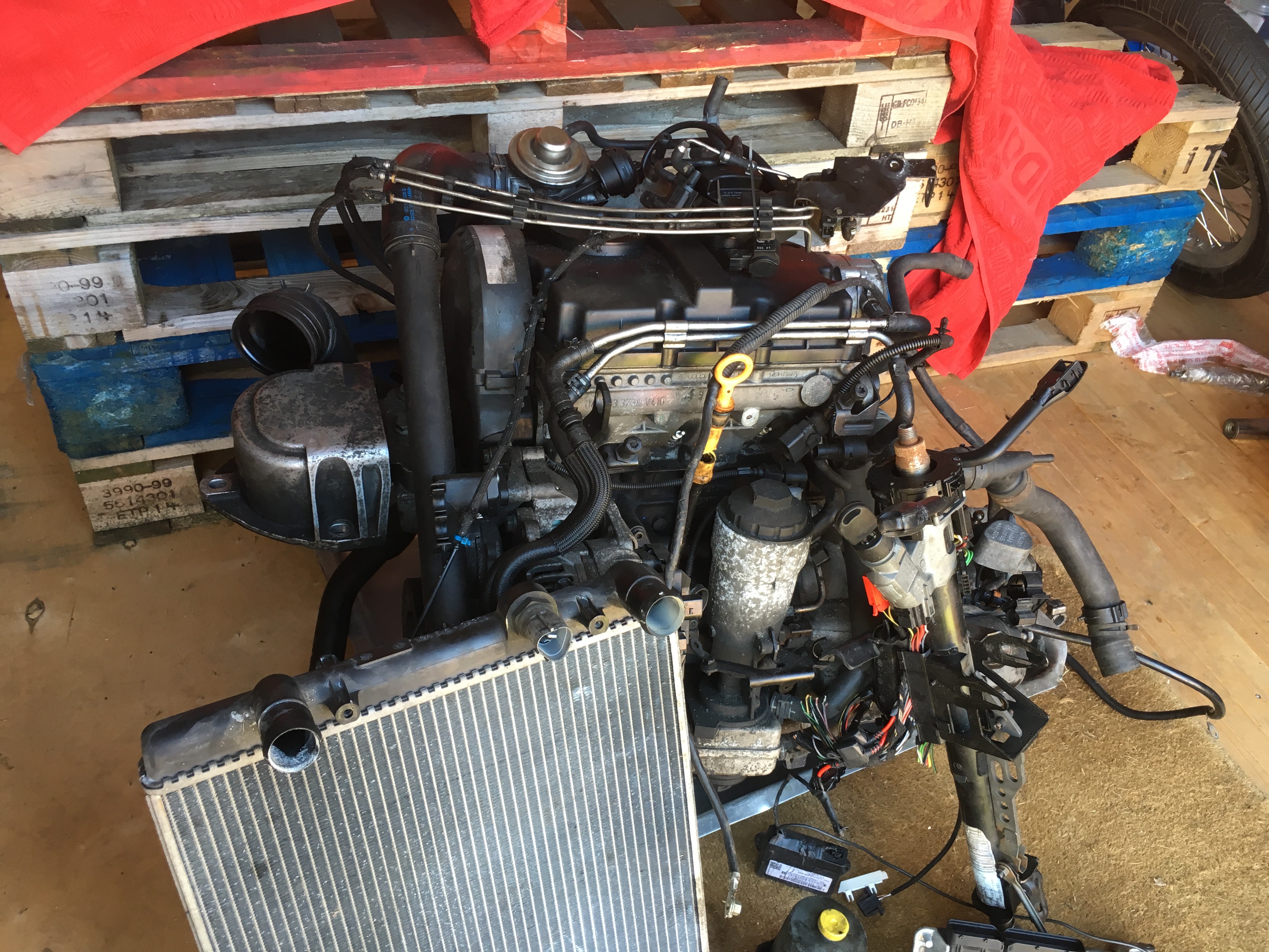

Just a few more photos of the engine. Please feel free to try and identify anything that might be missing...
