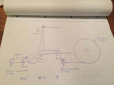

I myself am driving an old MZ Yanmar L100 Comet build. Really enjoy it. however at times it would be nice to have the kickstarter option espessially after i got a bad back last year.
here is what i think could be a solution. I've measured my own pulling length, and its just over 24", i assume 24" is enough espesially when i do have a third of my body mass acting at the end of the pull all the way. What do you guys n' girls think ?
Re: Fabricating kick or rope start for 3cyl D722 etc with CVT
Is this a regular recoil Rope pull starter converted to be pushed with the leg and foot instead of pulled by the hand? If not what happens after the engine starts? with your setupskoleskibe wrote:wonder who gets first.

The idea is that you use the original recoil part (recoil on drawing), and by using the pulley system shown (moving the kickstarter according to arrow), is able to pull the string thats connected to the kickstarter and running over the pulleys, resulting in 24" of pull at approx. 1/3 of ones body mass.
regards
regards

The idea is that you use the original recoil part (recoil on drawing), and by using the pulley system shown (moving the kickstarter according to arrow), is able to pull the string thats connected to the kickstarter in one end and running over the pulleys, resulting in 24" of pull at approx. 1/3 of ones body mass at the other end.
Hope that it makes sense
regards
regards

yes makes since. don't see why it wouldn't work.skoleskibe wrote:The idea is that you use the original recoil part (recoil on drawing), and by using the pulley system shown (moving the kickstarter according to arrow), is able to pull the string thats connected to the kickstarter in one end and running over the pulleys, resulting in 24" of pull at approx. 1/3 of ones body mass at the other end.
