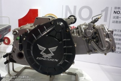

I've watched this thing since it's roll-out back in 2010 or 2011 hoping it might go into production. It appears that's finally the case. At 10 kw it's no powerhouse, but would make a great replacement for the Yanclones. And as it was intended for a 3 wheeler it comes with reverse and an integral differential. So, for what it's worth, and apologies for the less-than-perfect translation.
http://zse.cc/productsdetail.aspx?Produ ... &CateID=51
Zongshen 500 Diesel
Engine commonly known as: DSW500 Diesel
Engine type: Single-cylinder, water-cooled, horizontal
dimensions (mm): 769 × 432 × 417
Net Weight: 85kg
Max Power: 10KW/3800 ~ 4000rpm
Package size (L × W × H ) (mm):
Displacement: 494
Maximum torque: 28N.m/2200 ~ 2500rpm
Compression Ratio:
Bore and Stroke: 86 × 85 Ignition:
Lubrication: Pressure splash
lowest fuel consumption:
Start: Electric Start
Clutch mode: Dry Clutch
Transmission mode: five-speed + reverse (with differential)
Zongshen Power DSW500 engine features:
1, the new diesel-powered vortex combustion chamber structure, better combustion, low fuel consumption (compared with the same displacement gasoline engine, fuel economy 40%); low emissions (Euro Ⅲ standard); Low noise, low speed, high torque characteristics; machine comes with balance shaft vibration, improving occupants comfort.
2, the machine comes with glow plugs, difficult to solve cold start phenomenon.
3, the machine adopts international brands fuel supply system to improve fuel economy; gear box with separate crankcase lubrication, lubrication characteristics to adapt to different needs.
4, using the integrated differential, more compact.
5, detachable wet cylinder, easy maintenance.
6, variable fuel injection timing mechanism, optimizing fuel supply time, improving external characteristics, noise, fuel consumption, vibration and a series of performance indicators.
Zongshen 500 Diesel
Net Weight: 85kg
Displacement: 494
Compression Ratio:

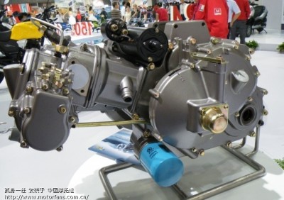

Judging by #4 and the gaping black hole on each side
looks like this has an output on both sides intended for left and right axle for something of a 2wd ATV design. Thus for our purposes we would have to weld up the diff.

Axles coming straight out of the unit the diff must also include final drive reduction. To use it on a bike I'd want to take the whole lot out and so avoid having a 1:1 final drive.

If it had an output shaft instead of a diff, and a vertical cylinder arrangment, then that would be a near straight swap replacement for a petrol engine!

This must be produced for a particular purpose ie. quad. The half shafts that need to fit the diff must be from an existing vehicle ? probably rigid back end quad as each shaft would need two UJ joints if it was to have suspension.
A lot of talk about it just fitting into bike frames. But if it has to be mounted as in the photo have you notice the length.
