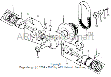

Yes, the clutch/trans could be cut away and sealed therefore maintaining oil sealing integrity. The primary drive on a Goldwing is via a hy-vol chain driving two gears. Mating the engine output to the clutch/trans would require a different gear set for the hy-vol setup. On most gas powered bikes the primary drive ratio is between 4:1 and 2:1. Conversion to diesel power would require a primary ratio of around 1.5:1 in order to be able to attain highway speeds without over revving the engine.
My main concerns are if the drive components are up to the increased rotational force of the Benz diesel. Also......I would need an elegant solution for cramming a rather large engine, complete with radiator, into an area which is designed to have less than half of the dimensional and volumetric area. Having a 10 foot wheelbase is out of the question.
Picture is of a Goldwing crank and the drive chain.
