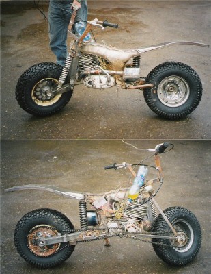

2x2 little bike (NOT Rokon or Racoon)- interesting Critter. Only text was on throttle side of front tire is a CV joint

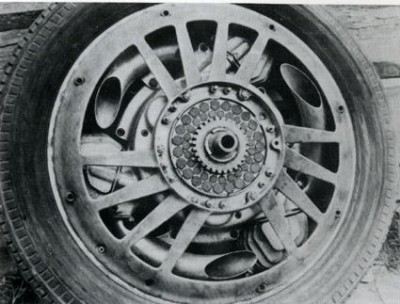

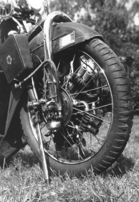

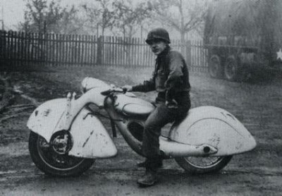

Older FRONT WHEEL DRIVE German Bike with Radial? engine inside front wheel.
http://www.greyfalcon.us/Killinger%20an ... rcycle.htm

on the little 2x2........ the struts to the CV joint/front sprocket appear welded but I think they're not welded to frame but instead welded to a swing joint creating a travel of the front wheel in a more vertical direction instead of in an arch as in BMW's rear Paralever suspension on shaft drive bikes ( Car Bibles: Motorbike suspension types and how they work. )

Now dieselize the first one. :)
