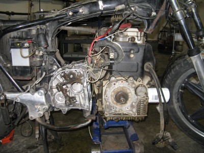

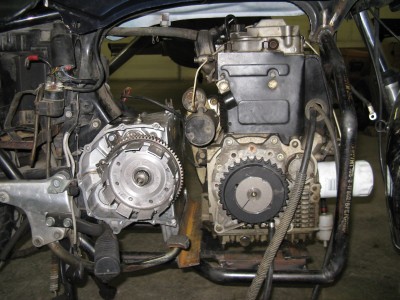

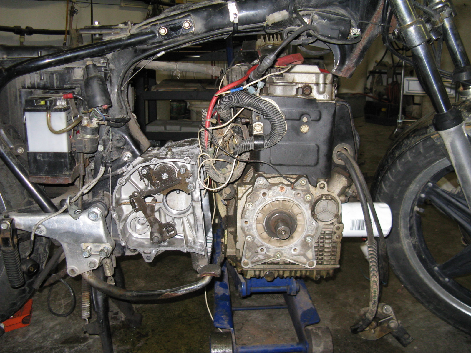

Well, I'm also using the original wet clutch, which I'll be chain driving in a sealed chaincase. The problem is that there is no way to completely seal the clutch side of the transmission case, and hence the chaincase from the transmission. I've attached a picture showing all the holes between the gearcase and the clutch case. I've plugged the gaping holes between the two sides, but oil will certainly seep through the main bearing and shifter rod way down at the bottom. And I doubt that I'll want to have my clutch running half way up in oil all the time, making foam and heat.

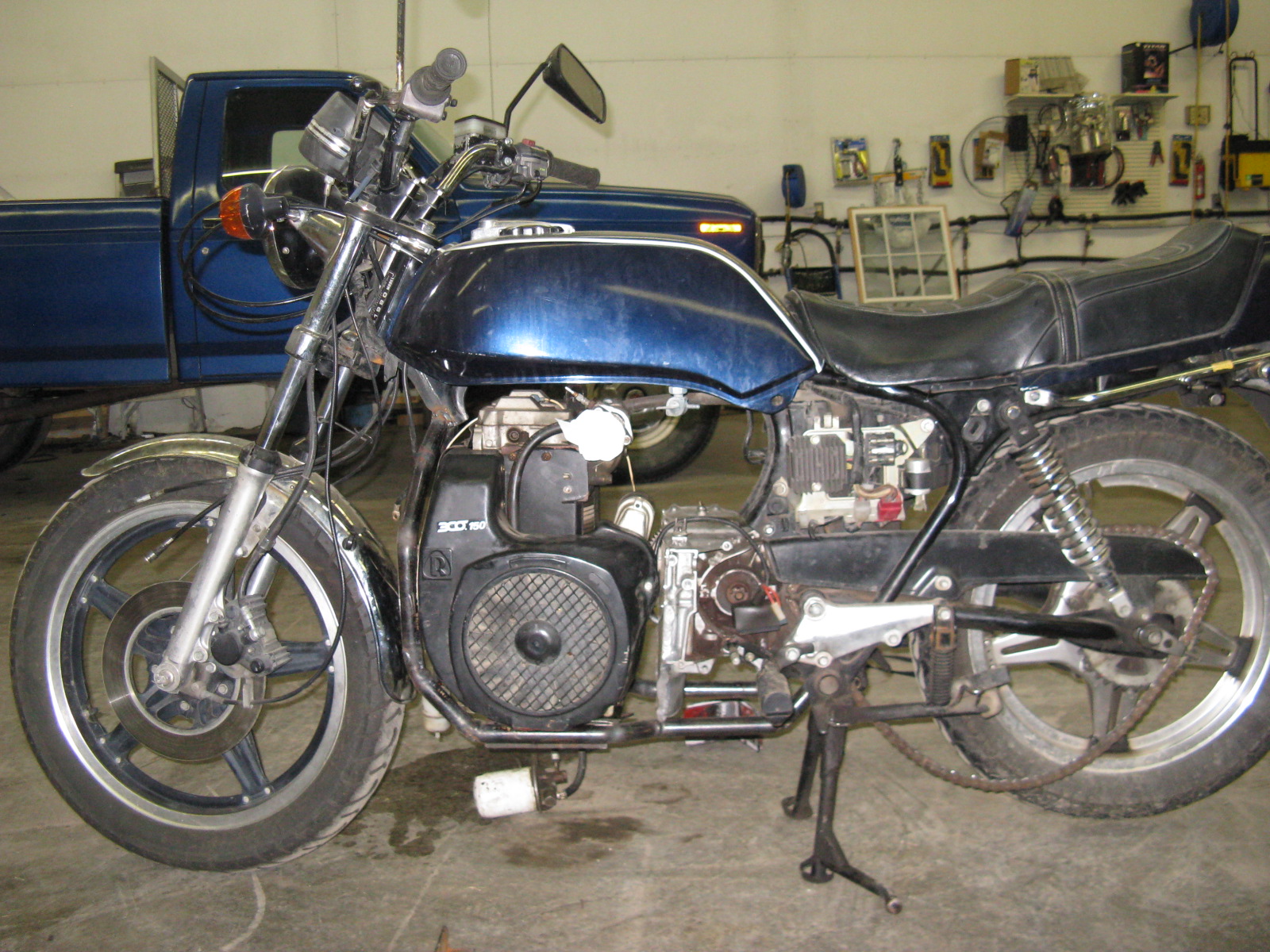

Do you have more pics and the details of cutting down this CB400 Honda engine into a trans only? Can't see much in the pictures posted and focus doesn't allow any detail when zoomed larger. Some more info on the trans might help with some answers to your questions.

In its original configuration, the oil level was several inches below the level of the gears in the transmission, and was pressure fed to the bearings and gears. I hope the photos give you what you need. Thanks.
