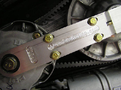

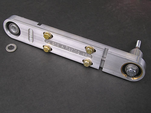

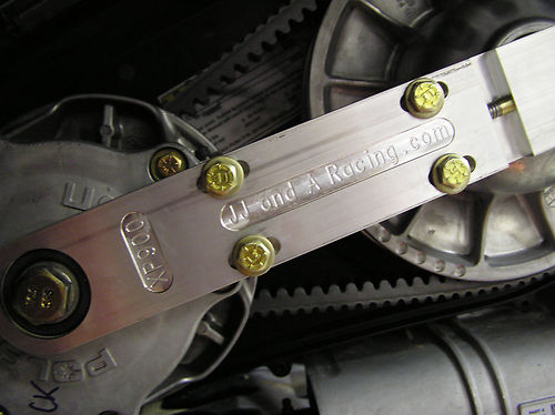

so what do you guys see here?
Conceptually:
. a flat bar between the bolts of each CVT pulley's nose acting as a brace.
. Hole in each end for bolting to clutches nose.
. Hole on Secondary clutch end with a bearing inside so pulley can spin independently.
. Bolt thru bearing replaces the center bolt on each polaris cvt pulley.
are other parts seen for length adjustment only? I believe that is a bolt or threaded rod visible on the right side inside the grove. Is that way ya'll see it too?
