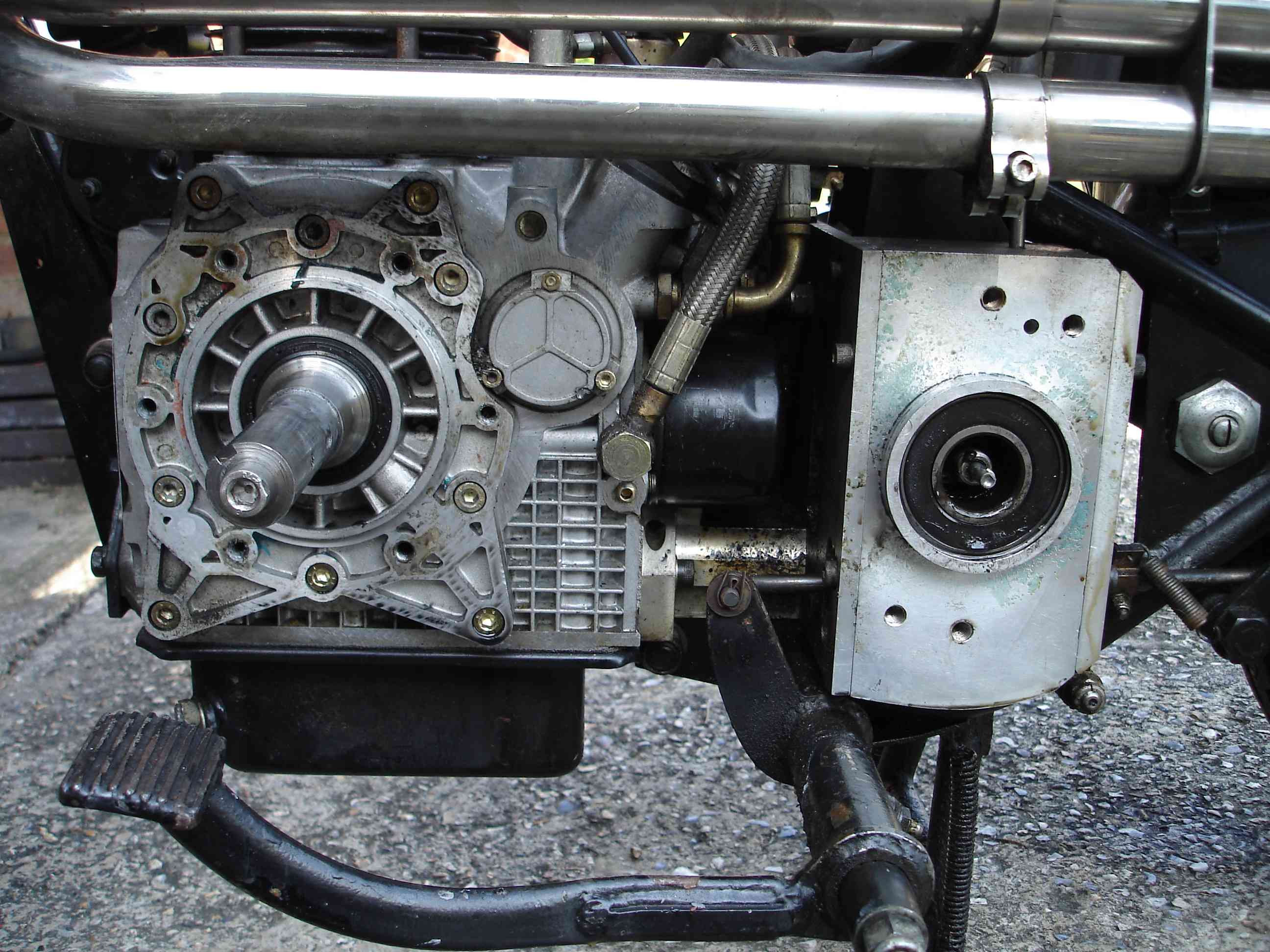

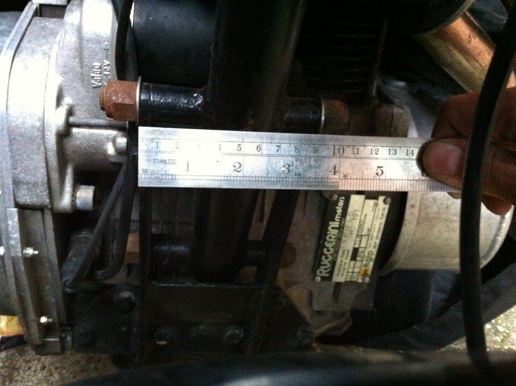

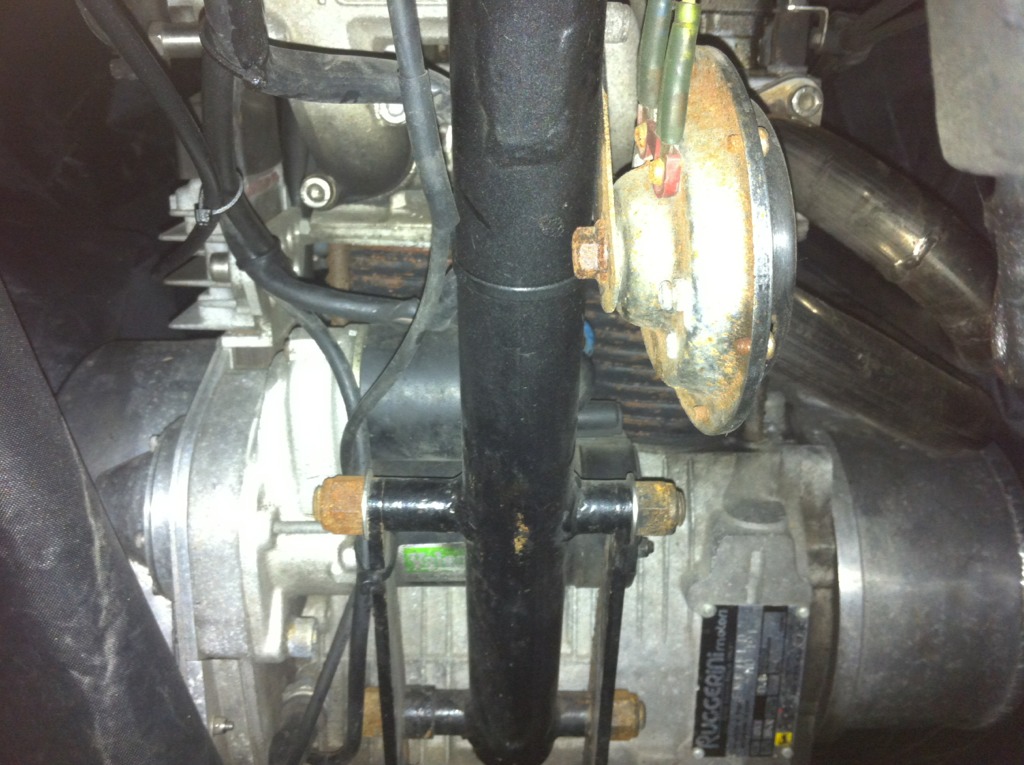

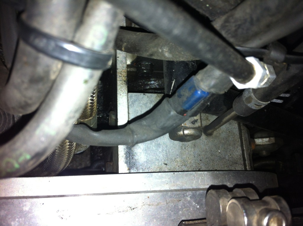

Ok, as promised, here are some shots to give you some idea of the Ruggerfield's makeup.

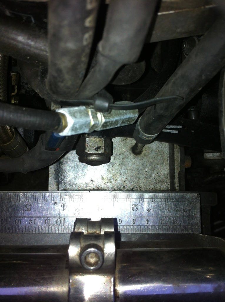

First up a central shot showing position of engine relative to its mounting.

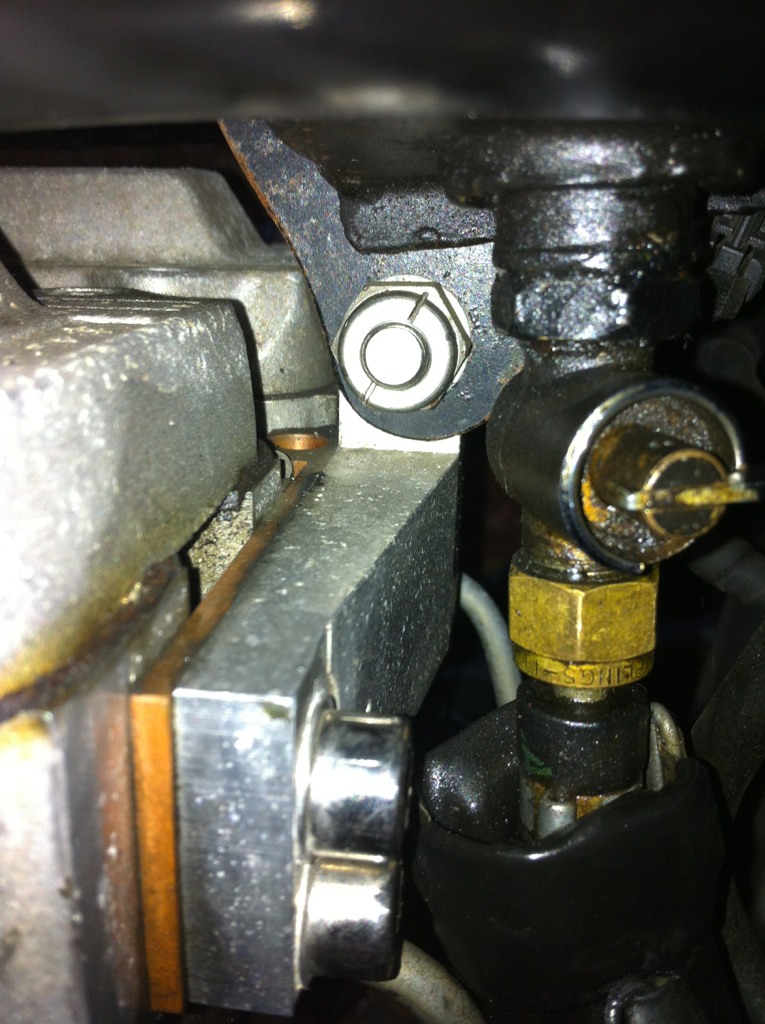

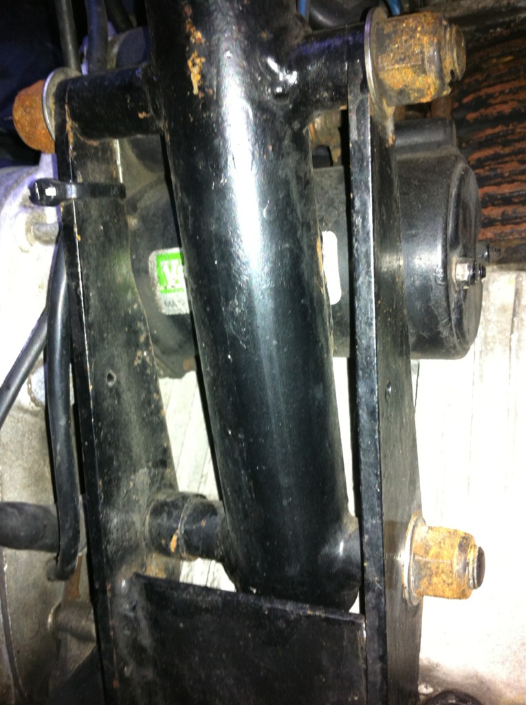

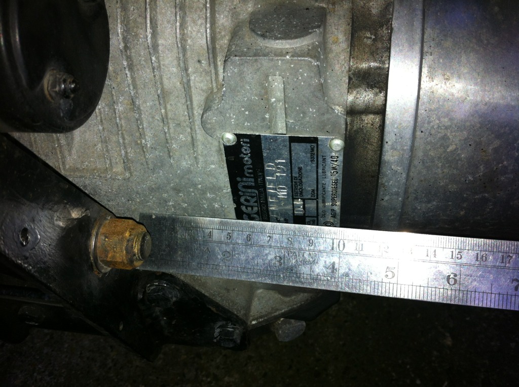

Shots of the front mounting...

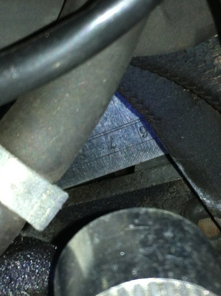

About 4.5" to the edge of the engine from the bracket.
...and the plate that bolts to the engine is about 1/2" thick.

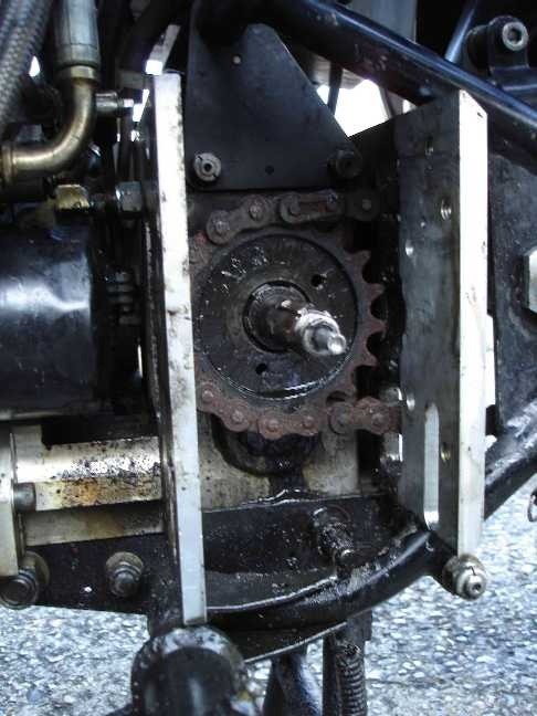

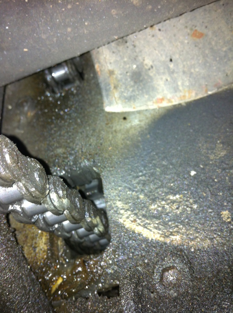

...and a few more

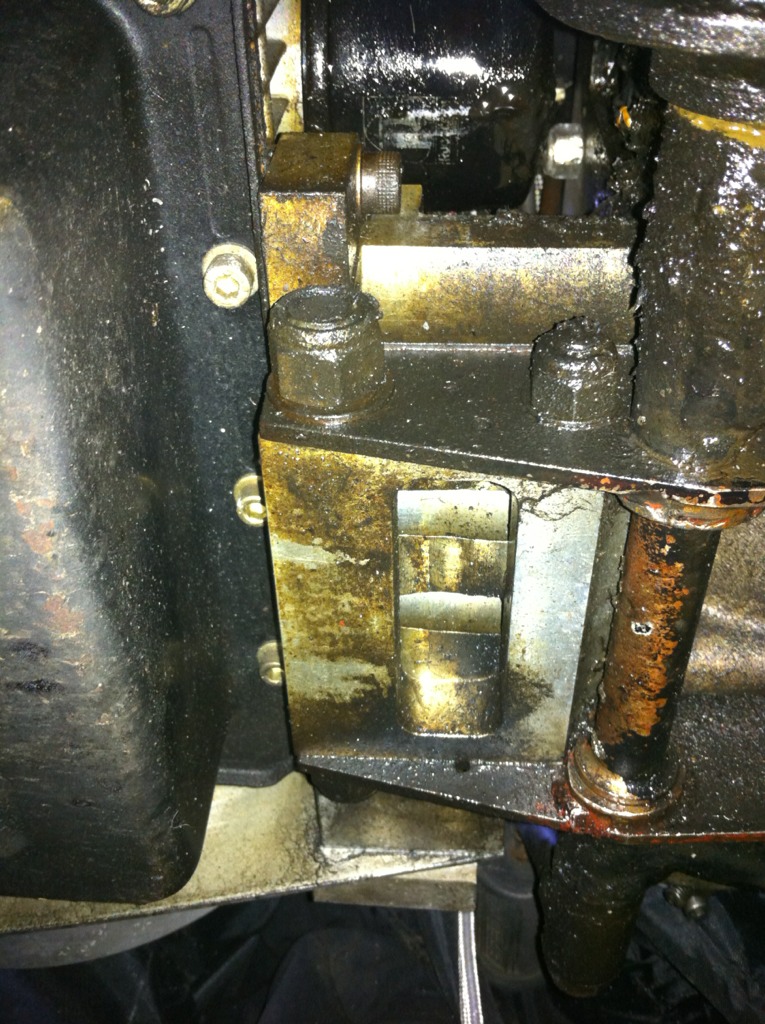

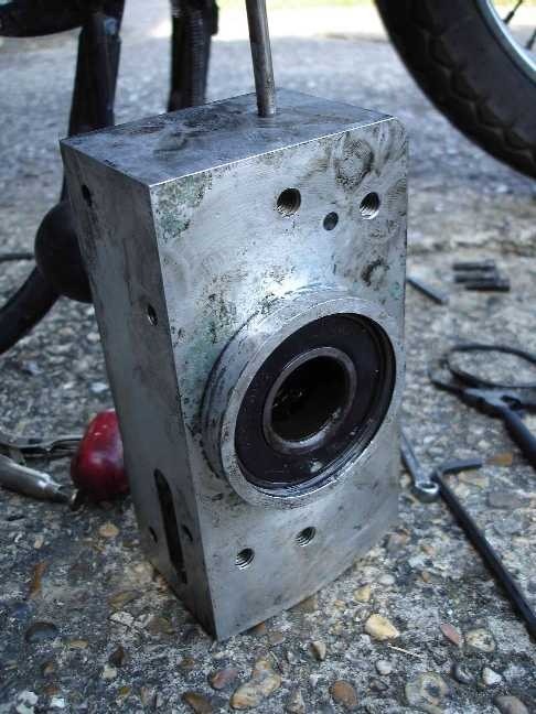

Underside of the lower plate that forms the base part for the above the carrier box which comprised of two bearings.

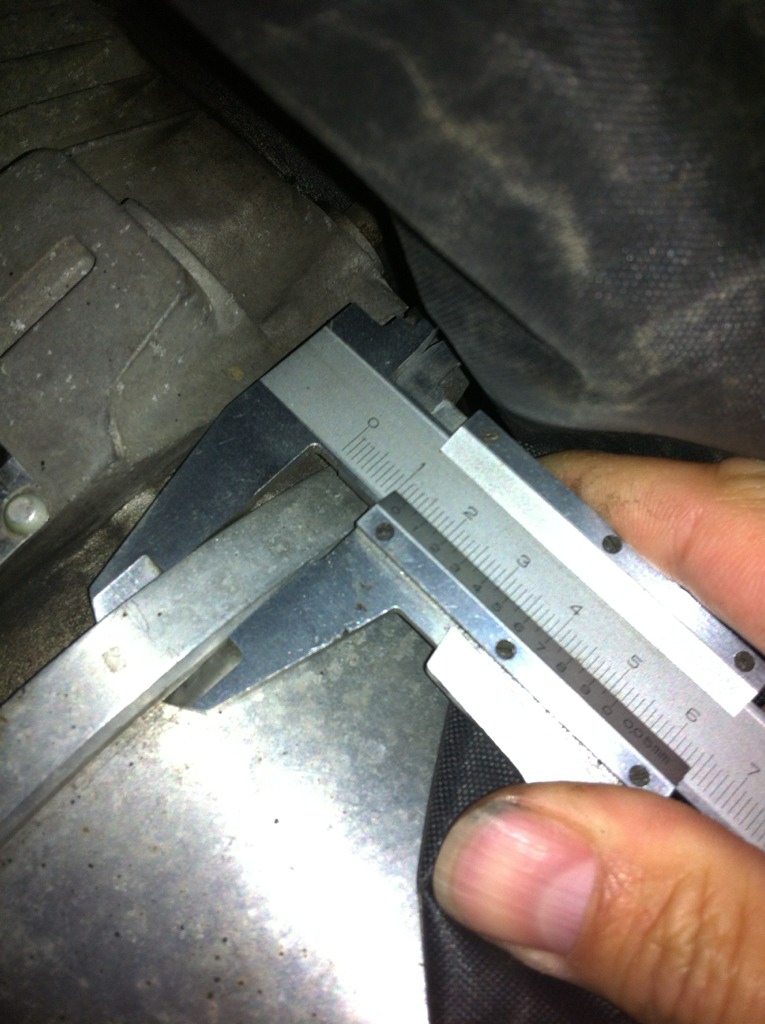

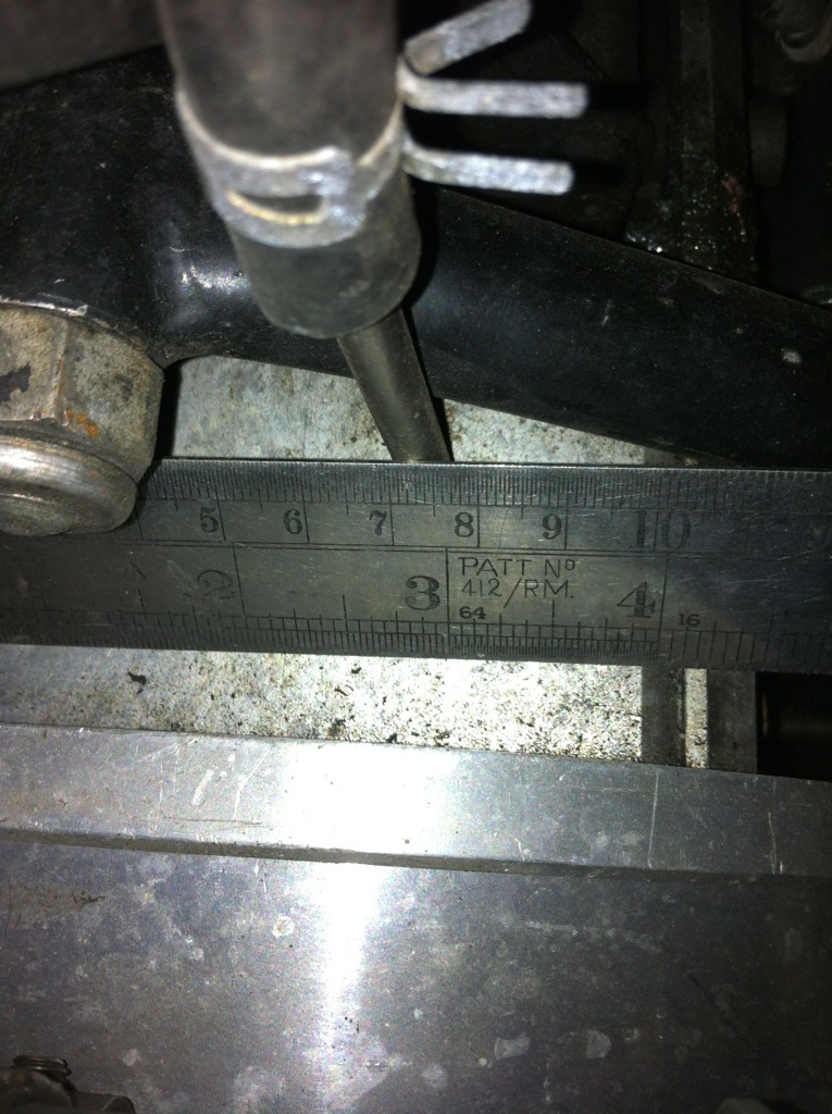

Top view looking down on carrier box - it's about 4.5" width...
And it's (forgive the mixed measurements!) 65mm deep..
Here you see the back plate with chain entrance & exit. After taking this lot apart it struck me as being very well if not a little, over engineered - but I'm not complaining! :-)
A shot of the head steady. Very solid!

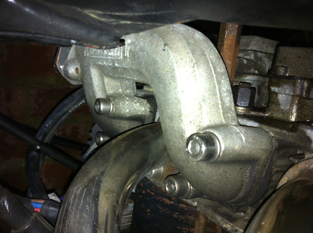

And the unihead ganged up intake & exhaust ports...

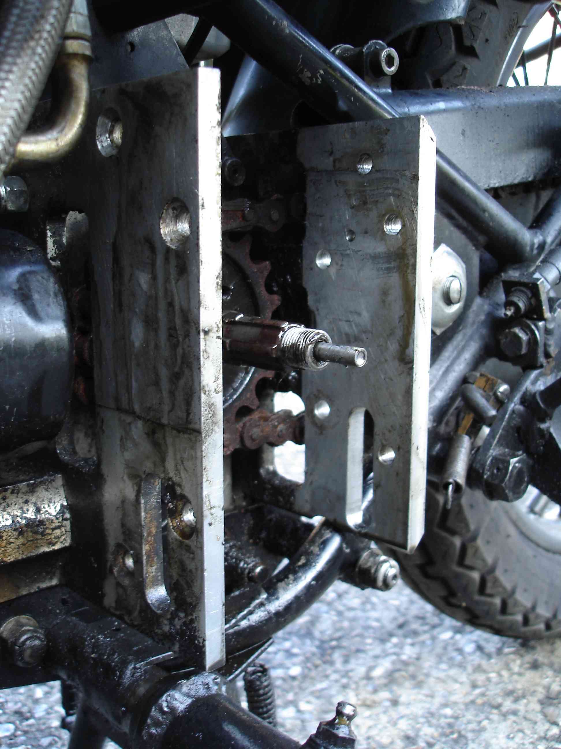

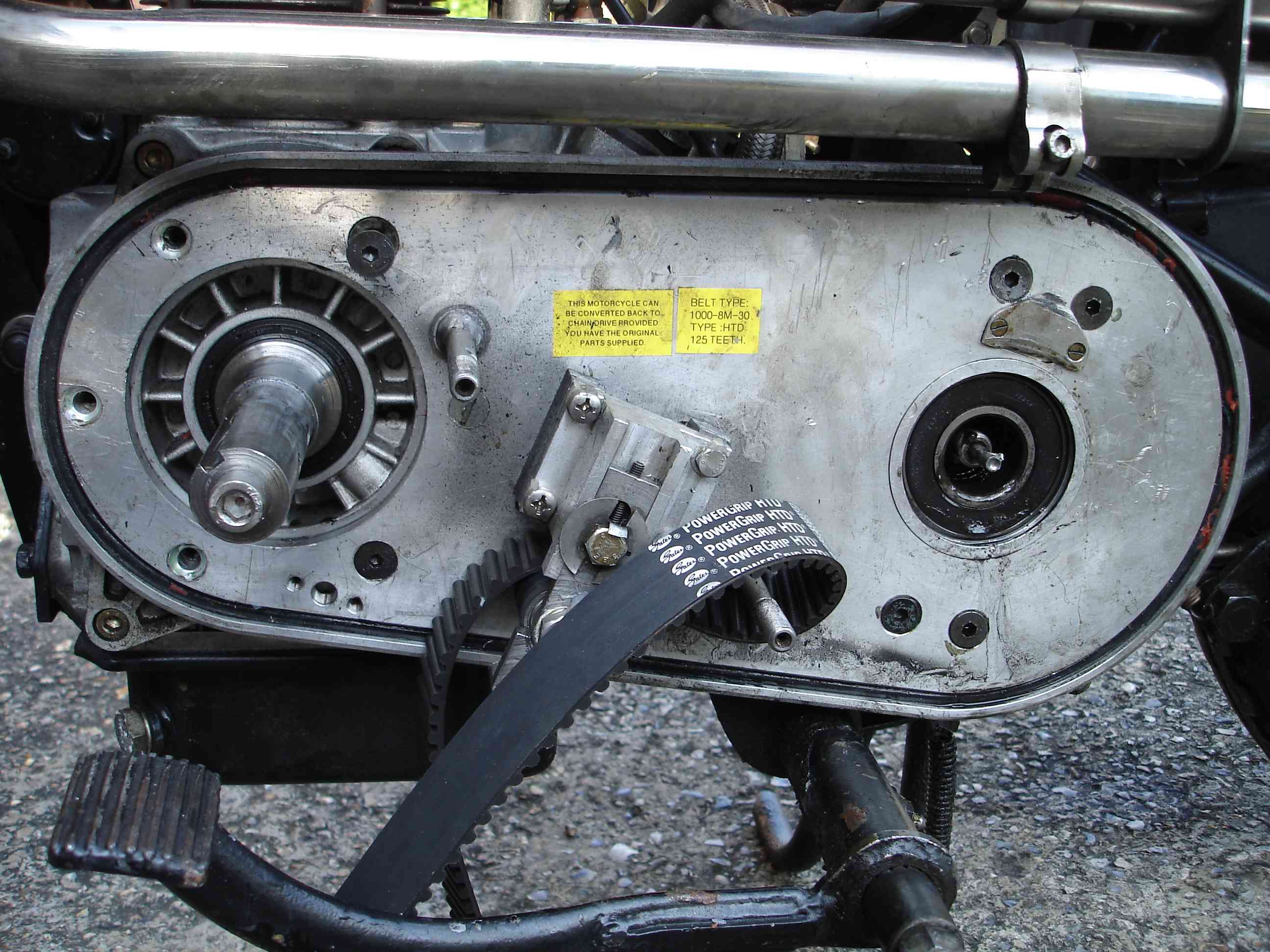

Here's a few shots from the other thread that show the bearing carrier box.
And where it fits...

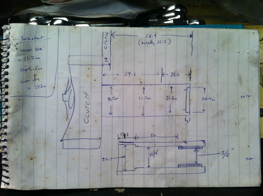

I came across this by accident earlier - sketch detailing the shaft that extends out the back of the clutch & sits in the carrier bearings. Don't take any measurements as gospel but it went together ok & still goes :-)
