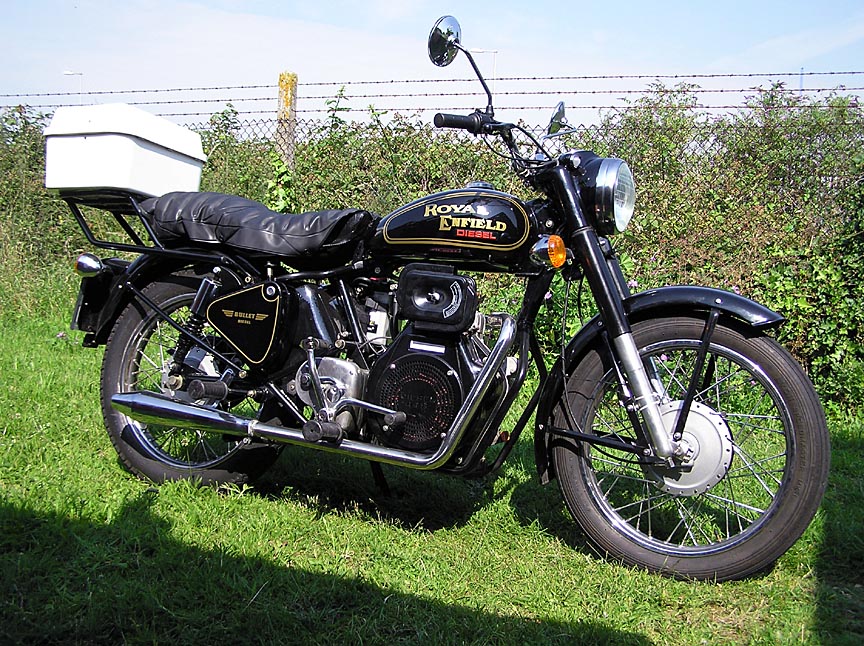

At last have a diesel motorbike, after visiting this site for about three years now on the sidelines, and have got lots of useful information from the numerous posts, looking at various possibilities.
Having great difficulty in sourcing a reasonably priced classic donor bike frame, and seeing that it would cost more in new tools and welding gear etc., and only having limited workshop facilities - I visited Henry Price last year, and was quite impressed with the conversion work, and after a test ride at his place in Gloucestershire, I asked Henry to build a pre-1972 Royal Enfield conversion to my requirements, when an ex. Indian frame became available. It also has electric start, and a sidestand which is useful. So after a few months waiting, now I have a 1971 classic motorbike, with cheap classic insurance and no road tax to pay.
I've just run the 406cc Suntom engine in after several hundred miles, and had only a few very minor faults with the motorbike overall. I've also done some mods as well, and after the first engine oil change, I'm experimenting with biofuel vegetable oil mixes, and I have currently run the engine for about an hour at various different throttle settings with my current veggie oil blend, with no running problems so far.
I'll keep you posted with my progress and experiences with running the motorbike. So far, the vegetable oil blend costs about £1.17 / litre which is considerably less than the price of diesel! and the exhaust smell is a bit like a barbecue smell with the hint of diesel still in the fuel tank! I hope to get the vegefuel cost down a bit more, with my latest blends of 'fuel'. Fuel consumption so far in the running in stage is about 140mpg, which is good already!
Performance so far, is a max 52 mph indicated and confirmed on my additional digital speed counter! with some throttle left, whilst running in the motorbike on diesel. Unfortunately I couldn't take it any faster, as I live in London, and was speeding just a little bit in a quiet lane on a Sunday morning!
It's similar to a 125cc bike performance wise, except with a lot more weight, much more low down revs engine torque, and much better road handling. My previous bike was a Jap grey import 1970's styling Honda CG125 for commuting, and the Royal Enfield diesel performance is quite similar.
