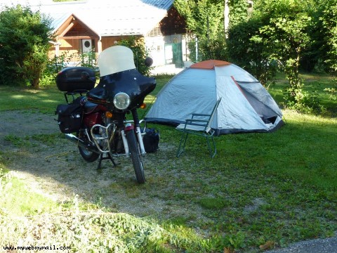

I advocate using a proper fairing for touring, ideally the old avonaire full fairing type. My old Triumph 500 ( bit modified would give over 100mpg back in the sixties and had a good top speed.
The best you can get these days is the old avonair handlebar fairing, it protects your upper body and face whilst reducing drag. Now marketed by Sprint manufacturing. Well worth the money. picture of it fitted to my bike in czech republic out side the Church of Bones Kutna Hora, last year.
Re: Aerofairing and fuel consumption on an Enfield clone
Larry, your fairing strikes me as something that makes riding a naked bike more comfortable, and less so making the profile more streamlined? Or am I mistaken?
oldbmw wrote:I... picture of it fitted to my bike in czech republic out side the Church of Bones Kutna Hora, last year.

Searched for some pages with pics of Avonaire fairings. Apparently the handlbar type mentioned above was less common than a full front fairing from what I found. They were made by Sprint in England. Some pics at these pages:
http://aatherton05.home.insightbb.com/F ... naire.html
http://www.vintagebmw.org/v7/node/5225

I looked real close at the Avonaire fairings and the teardrop panniers like on the BMW in the link when thinking of improving my CB250. Only problem, all the fairings were too big for the little CB. :(
In the USA, take a look at readily available fairings at http://www.airtech-streamlining.com/ They even have some vintage dustbin fairings. :mrgreen:

Frontal view stolen from Larry.
oldbmw
Posts: 337
Post by oldbmw »
Same trip, picture taken in the French Alps just before the climb up to Mont Blanc.
The fairing is great, your entire upper body including hands do hot suffer from any wind or driven rain. Makes riding much less tiring. I do prefer the full fairings but this is the only one still available. you can order direct from Sprint, or from the BIC.
Thanks Sphere.
I thought the early near view pictures taken in a picturesque village may have been deemed inappropriate :)
