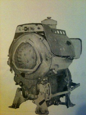

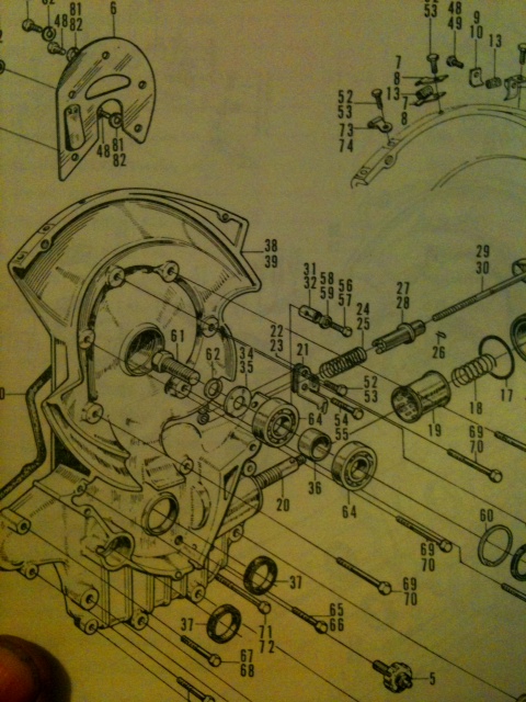

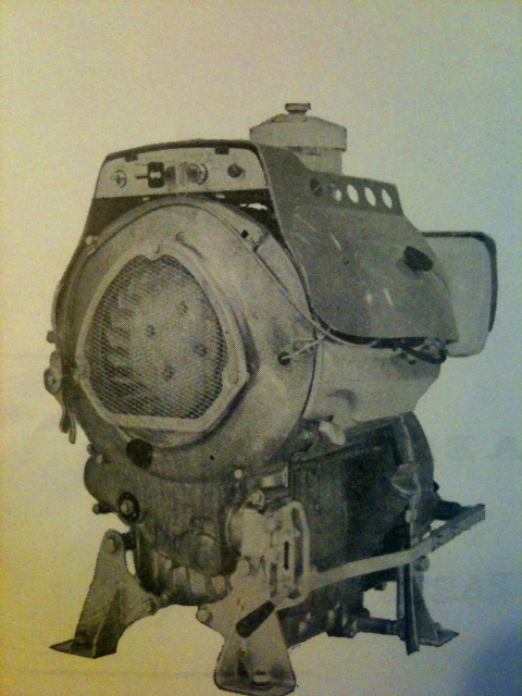

I don't know if this will be of any help but I have a parts manual for a Honda Diesel V twin GD100. Studying it closely and comparing to your Youtube Video it looks quite similar. Labelled up as year 1968.
I could post it to you and if you want maybe you could copy and return? Or I could bring it to the rally if you're coming?

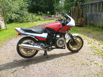

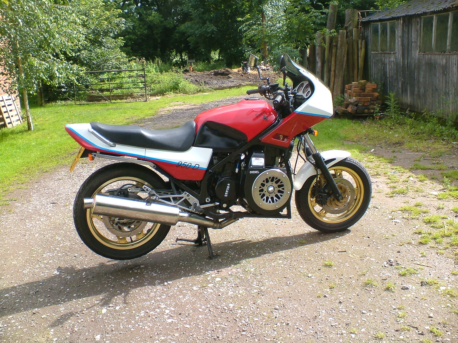

Wish I'd made it to the big knock.... but thanks to a friend who did I now have these pics of my engine in use!
Looks good! however, they do say to me that my engine runs the other way round to what I expected!
Re-think time!
Re-think time!
