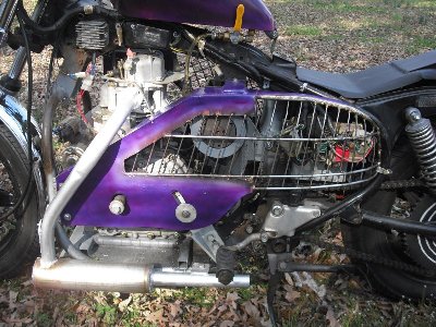

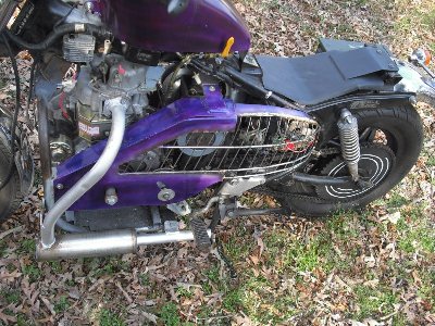

My name screen name it phoenix827, but I go by Ben. My Father and I completed a bike last year. I've been running on used cooking oil. The engine seems to really run well on it. Seen very interesting, cool bikes on the site and realize there are very few here that understand my bike. Wanted to be able to communicate with more like minded people. :wink: My bike was a Honda CM400, now it has a sterling 10HP diesel and variable belt drive. We made the transmission from a piece of 4 inch by 4 inch steel box. We bored holes through, bolted in bearing assemblies then cut our own shafts. I average about 110 miles to a gallon.

Secondly, from what I understand you have a 10hp diesel, with a CVT which then connects to a homemade halfshaft/jackshaft, which then drives the rear wheel using a chain and sprocket...
About right?

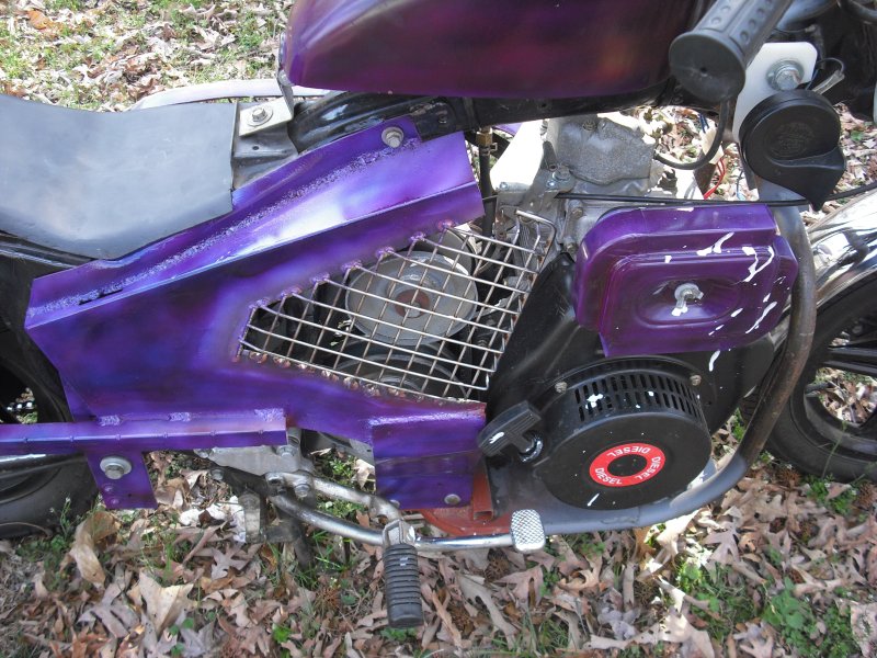

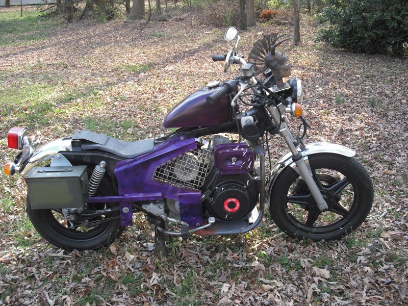

Here's a couple more pics.
IgorVigor
Posts: 243
Location: UK
Re: Hello from NC U.S.A.
Post by IgorVigor »
looks good :)
Agricultural is the word I am looking for... :D
One thing though, I would have thought a better seat would be a good idea :S
And the exhaust looks good :)
But like quite a few I have seen, the exhaust ends around your foot :S
I would think it would be better if the end was behind you, like a standard bike...
Still a good looking bike though (apart from the purple :S dont like purple :P)
And I like your method of protecting the rider from the belts :D

a few things have been changed since these photos, the bike has forward floor boards and there is a padded seat mounted on the frame plate. We cut the exhaust that short to be able to access the sidestand. We are planning a major rework after riding season. Looking for more miles from a gallon. We have a five speed to go in and I'm building a custom front end. I want to rake it and stretch it a bit. Won't fix the purple, that's my favorite, but you won't find any light feminine purple on it.
