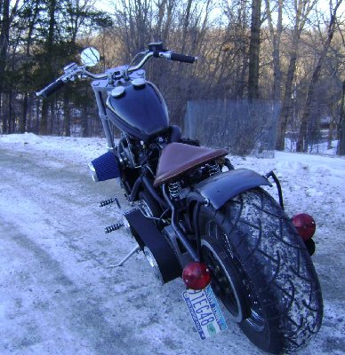

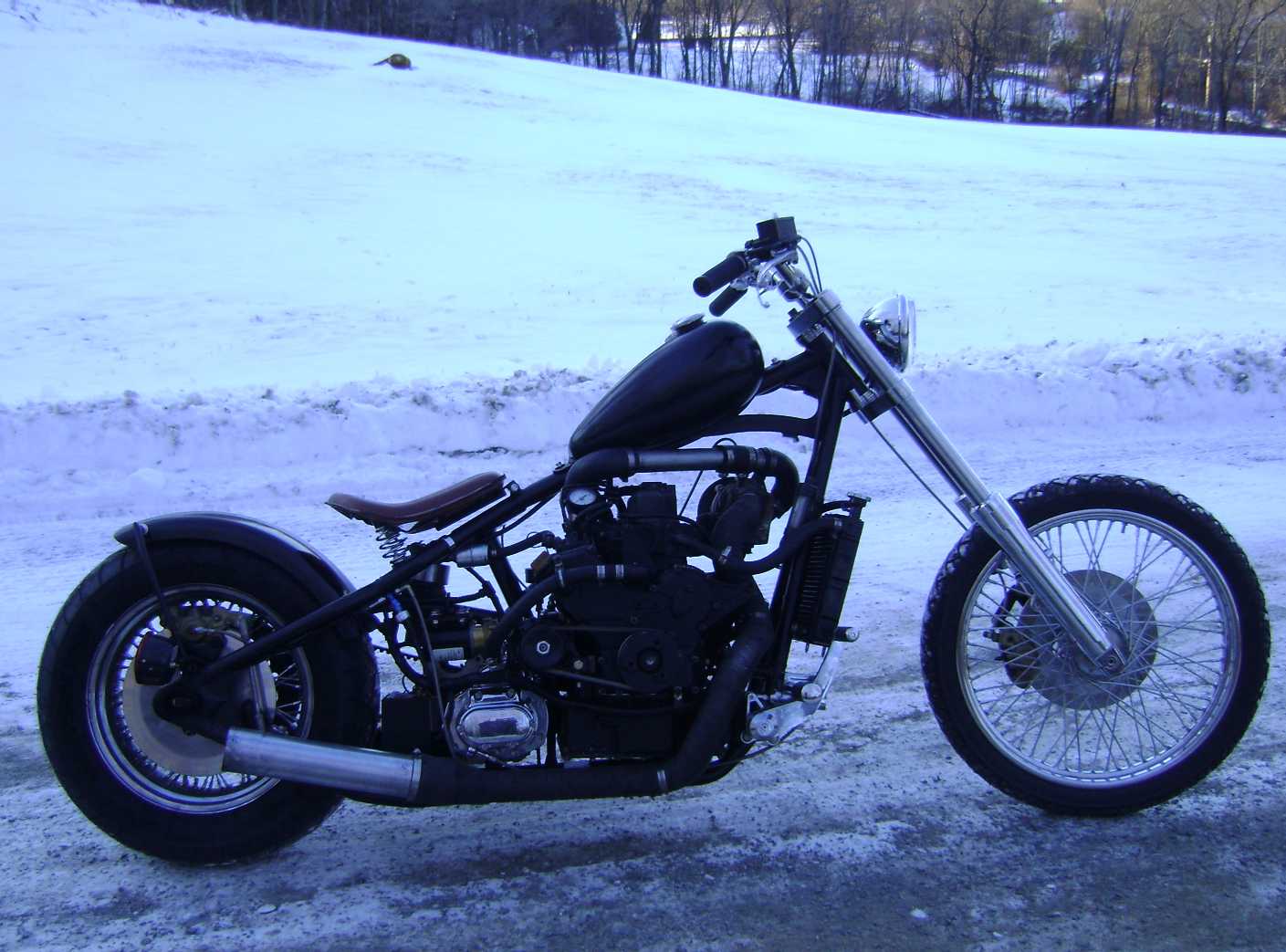

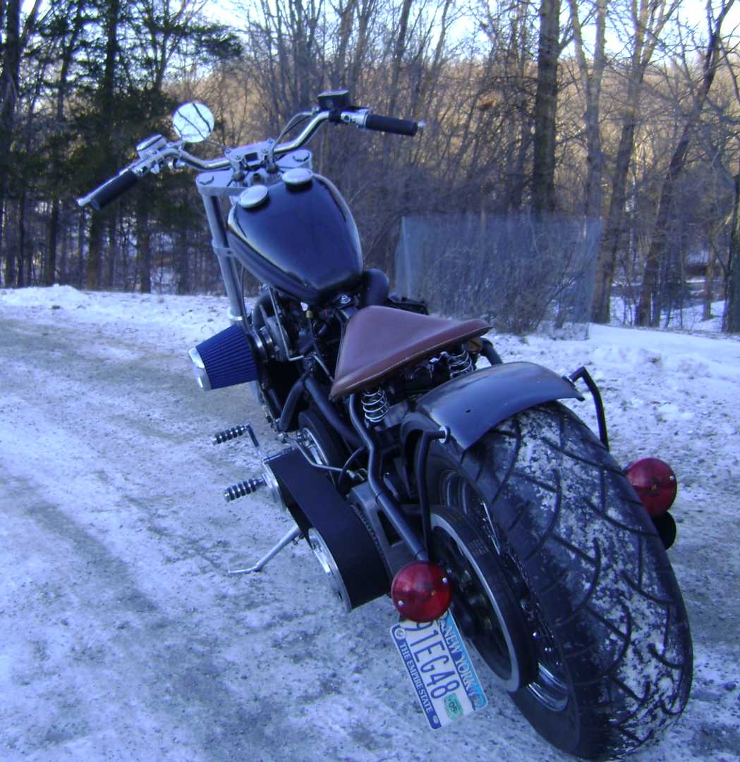

Here are some pics of my turbo diesel yanmar powered bike. Its a 3cyl, 958cc. Engine has been totaly rebuilt with preformance in mind. Turbocharged, injection pump modifications,pump timing advanced, all parts to spec. Turns at 4000rpm, lots of fuel, boosts 8psi under moderate load.
Here is some more general information. Bike has gt15 turbo (until its replaced with a gt1544), a remote electric water pump, 6 speed overdrive transmission, hydraulic clutch, metzler me880 tires on 16" and 21" rims, wide glide front end, exhaust is 2.5 inch in diameter welded exhaust tubing. 3.35 inch open belt primary (likes to grab baggy pants!) If you have any questions on anything specific just shoot me an e-mail. Thanks for posting it up!
