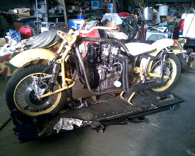

As some know I bought the Yuri Hatz/Dnepr seen on Dieselbike.net back in early 2005.
After rebuilding her and then parting her out, cutting up the frame to fit a Honda Goldwing GL1800 final drive, and even trying to sell the cut-up frame. Well, I’ve been reversing the process.
I’ve located and bought a “NEW” Dnepr MT-16 minus the engine from Vostok Motors. I’ve welded and gusted the frame back together and well on my way to get the old girl back on the road. The New Dnepr frame left over will get my Briggs/Daihatsu Turbo 3LC for another Dnepr rig.

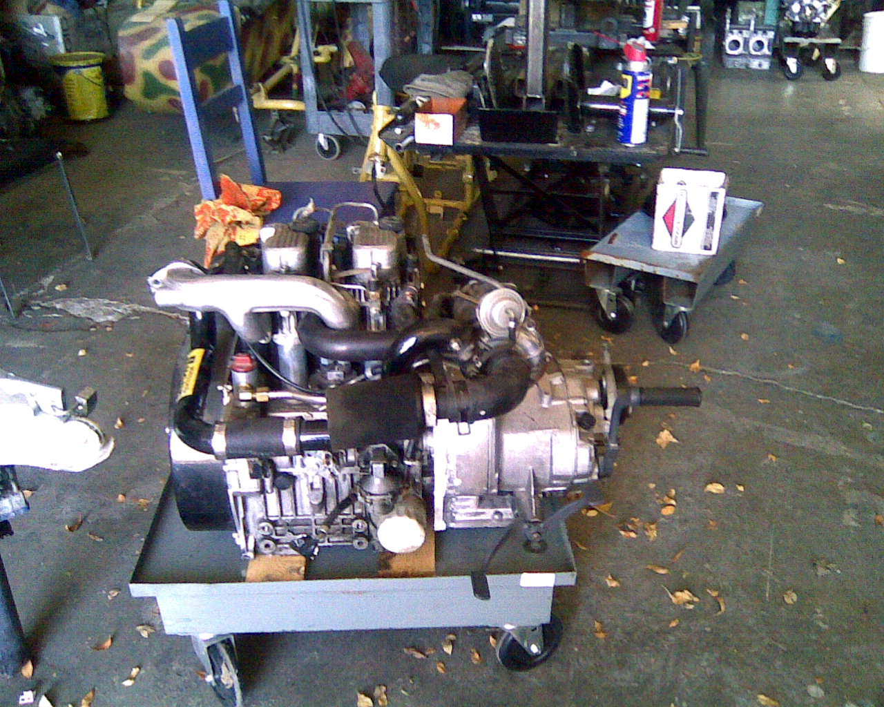

Hatz/Dnepr Resurrection Up Date
Post by LocomotiveBreath »
Well finally two adapters made for the Hatz/Ruggerinni to Dnepr Ural Trannsmissions. Now to start working on an adapter for the Briggs/Daihatsu 954TD.
A second Dnepr MT-16 on layaway from Vostok Motors
Looking to have my Desel Dnepr on the road soon. I'll have to re-route turbo plumbing to be used on my Dnepr.
Turbo Ruggerinni from my Honda mated to a Dnepr Transmission
