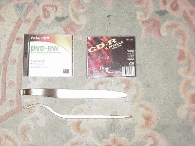

Looking at all the little tyre levers available i decide to treat myself to these.
They will go well with the 24 and 30 mm spanners needed to change rear wheel. Not sure where to fit the trolley jack though :)

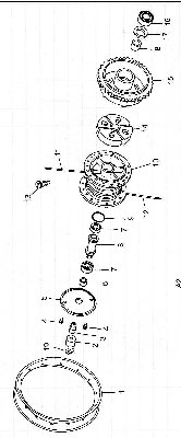

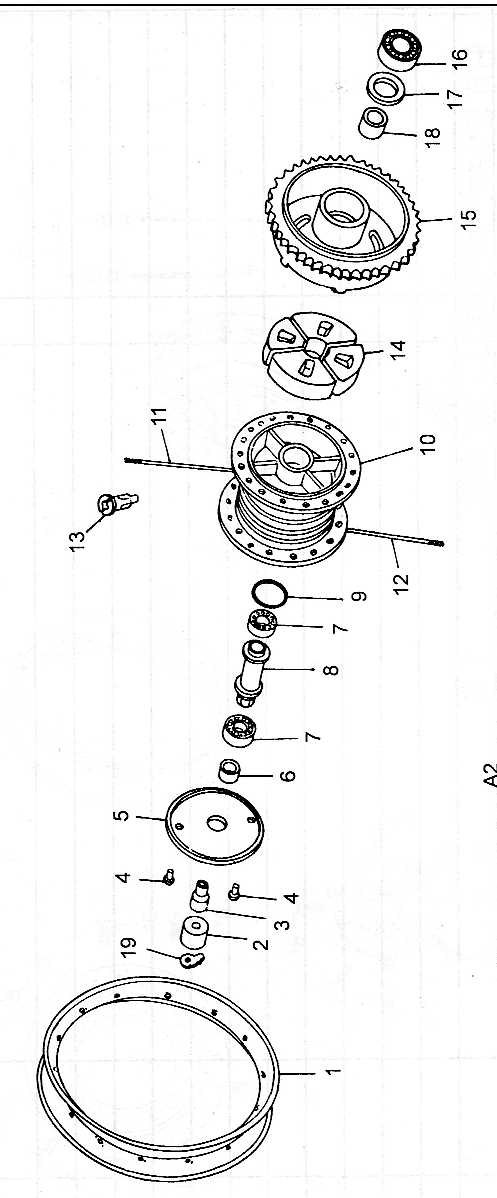

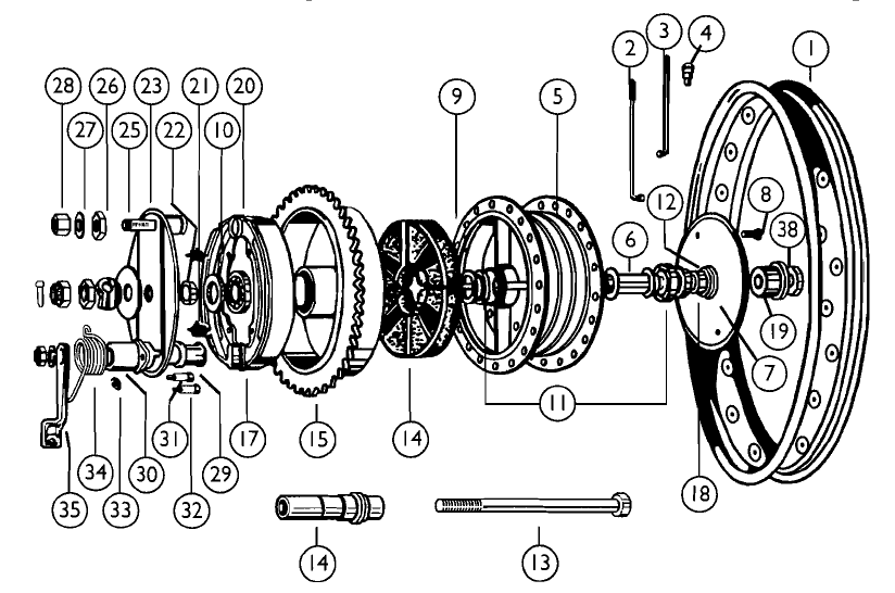

Today I mounted two new tyres to my freshly powdercoated rims. With the help of Nanko, a wood clamp and brute force it took a little under 2 hours to mount 2 tyres. Tyre grease was very useful to aid in slipping the tyre over the rim. A little garden hose and 300mm iron completed the endeavour.
The front wheel is pretty much finished except for a slight drag somewhere in the revolution, but the rear wheel has not been assembled to my satisfaction. I have a QD wheel, but one part of the axle assembly does not match the drawing I have. I'm also left with a flanged ring (spacer?) that fits inside a big ring, but can not be mounted anywhere in combination with that ring.
I am looking for detailed pics of a QD wheel, to see if and where I went wrong. My Bullet is a '92 model.

My speedo is front wheel driven. The hollow axle cannot spin freely and seems to be wedged between the two bearings. I suppose this means I need to by new bearings again, because removing the bearings is not possible without applying a fair amount of force.
What is the "carrier bearing" ?

Re: Change tyres
Post by oldbmw »

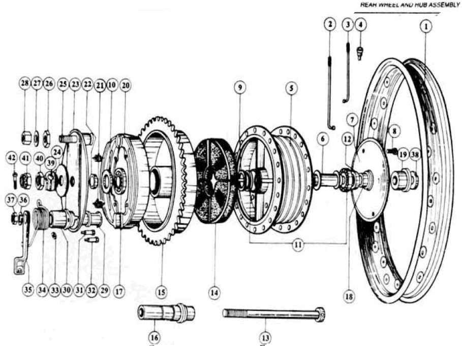

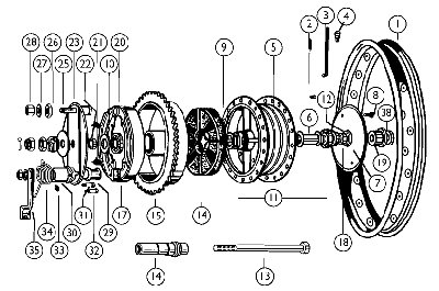

Sphere, hope this helps. taken from the parts book
Click on it for full size picture. ( better yet copy it and rotate it)
Re: Change tyres
Hey Larry, thanks for the pic! It looks still different from my wheel, and the pics I have. One is from the Snidal manual, another is a harcopy of a derived version of the Snidal (possibly others) manual with a different pic. My rear hub has a flanged portrusion through the dustcover on the righthand side. All the pics I see encourage you to put stuff on either side of the dustcover but that's not possible with my hub.

Sphere wrote:Any with detailed pics of a QD wheel?
the one I posted is a qd rear wheel, although fairly modern ( 2005)
Re: Change tyres
The flanged ring is probably similar to (3) in oldbmw's image, and is intended to provide clearance between the spacer and the grease seal. Otherwise the distance piece will crush when the nut on the other end is tightened.
Mystery solved, thanks for the help :D Pics of the finished product (wheels) are below.
