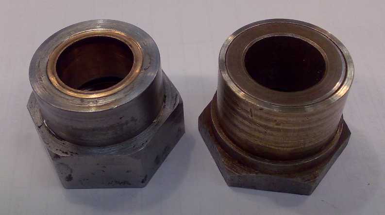

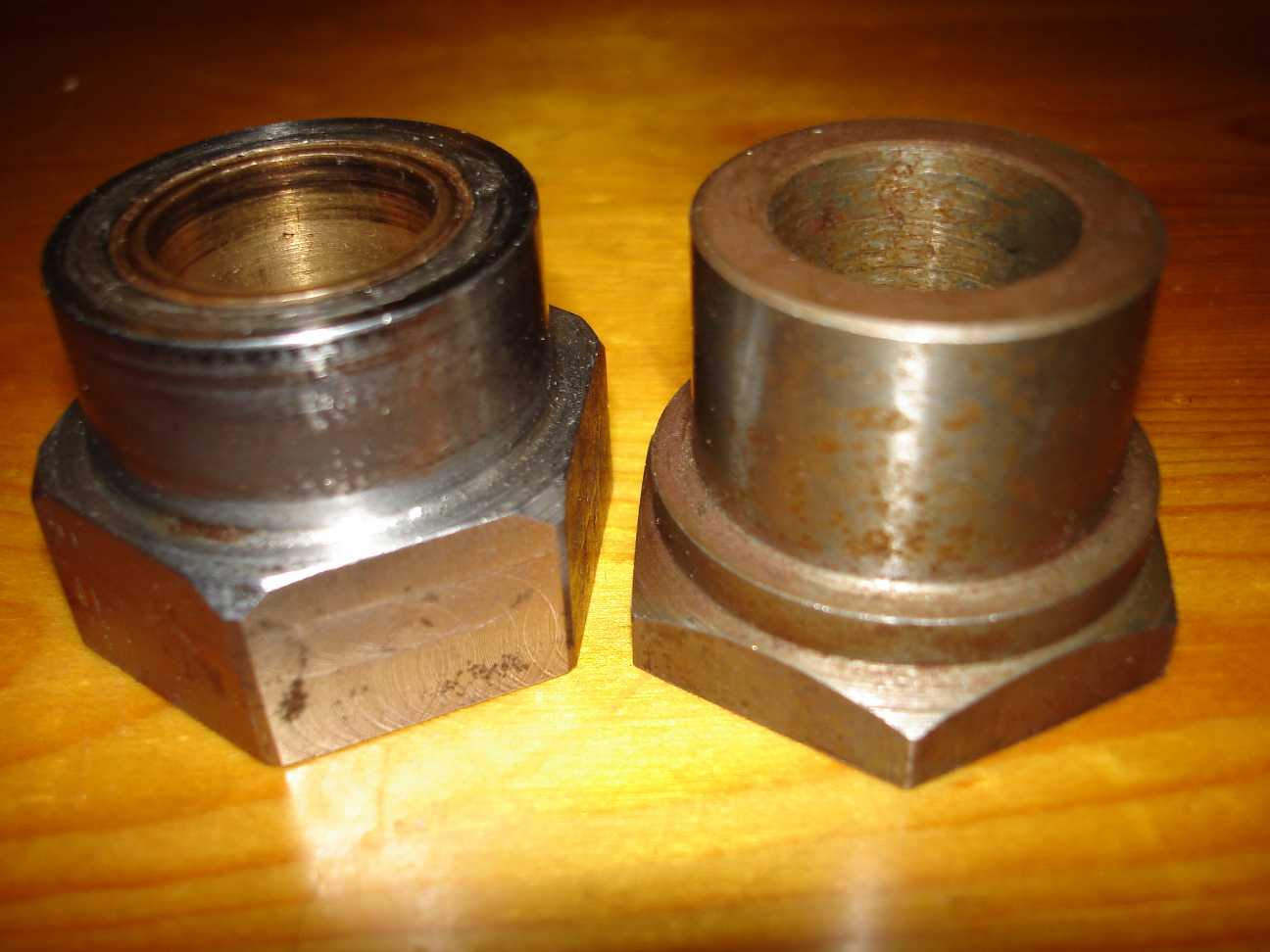

He's a couple of shots of the new old sprocket nut alongside the one I took off the bike. You can see that the one I took off is slightly wider. Gotta bring the other up to that really with a bush of some sort. Still can't quite figure how the builder got the thread size wrong. It's not Witworth or metric even. Just dunno on that one :?
Anyway, the bearings have been fitted into their respective casings now and tomorrow I may have a got at putting it together.
Sprocket nuts 2
Sprocket nuts 2
Sprocket nuts
Sprocket nuts

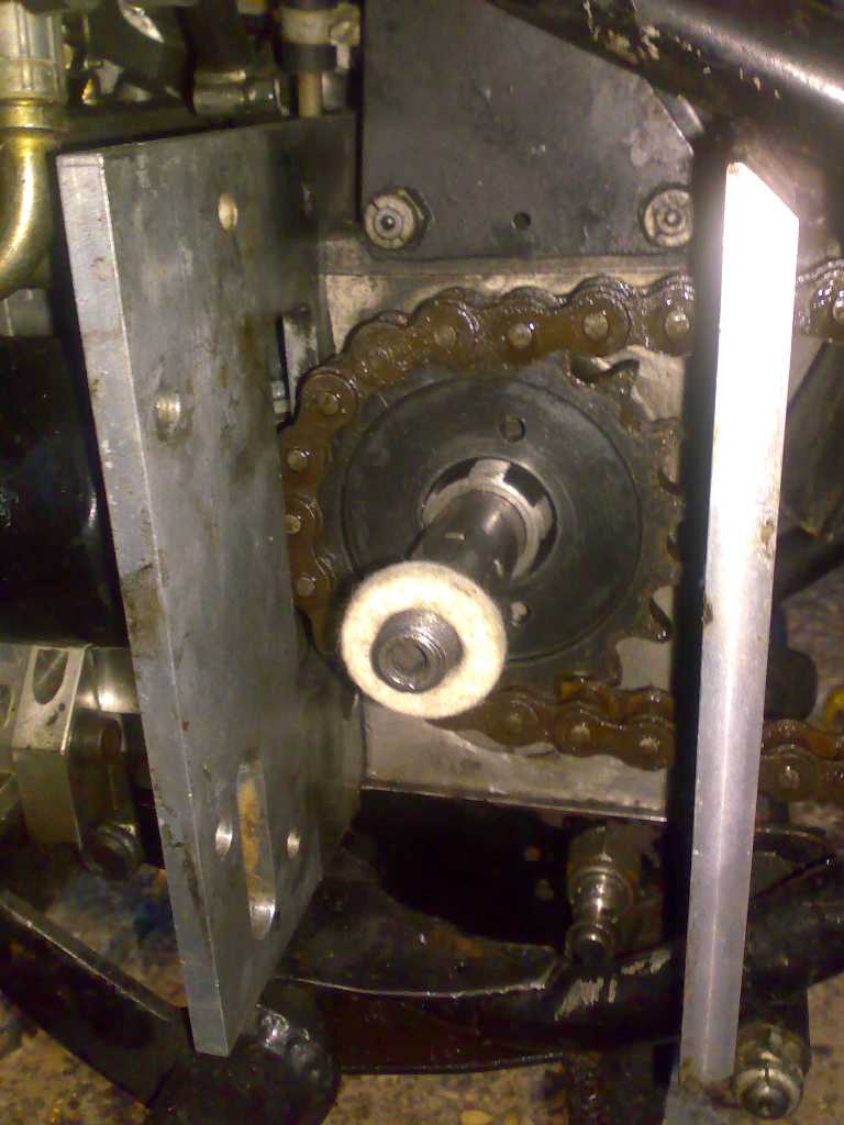

I'm a little concerned about this felt washer. It's inner dia is a bit small if I'm to push it up the mainshaft to the sprocket section and clutch section gap. This is the place I have to guard against oil coming out right?

Hi, yes the felt goes in to the nut, depending on what nut you have I know of three different types, anyhow I bet you have the most common type, just push it in to the nut and then bung the nut over the main shaft and tighten up (do it this way to stop felt getting in the thread). New felt, nice and plump, you may have a bit of a job getting it on, it does squash down with time. :)
Re: Ruggerfields gearbox
Ok Ian, I'll look at getting the felt over the end of the clutch thread and back up to nearer the cog. When I get the nut back with it's new bush I'll tighten it on :D Then the carrier and whole primary side can go back on there. Gotta figure out the gear change side out first I think tho :D
Sprocket on loose
Sprocket on loose

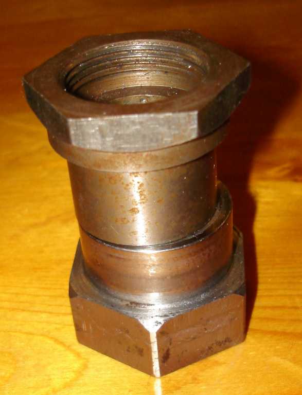

Ok, Colin has fitted me a bush onto the original Enfield sprocket nut (so it should rest nicely in the central carrier bearing)and I will go for a fit this afternoon. In the pic see both my nuts 8)
Both my sprocket nuts
