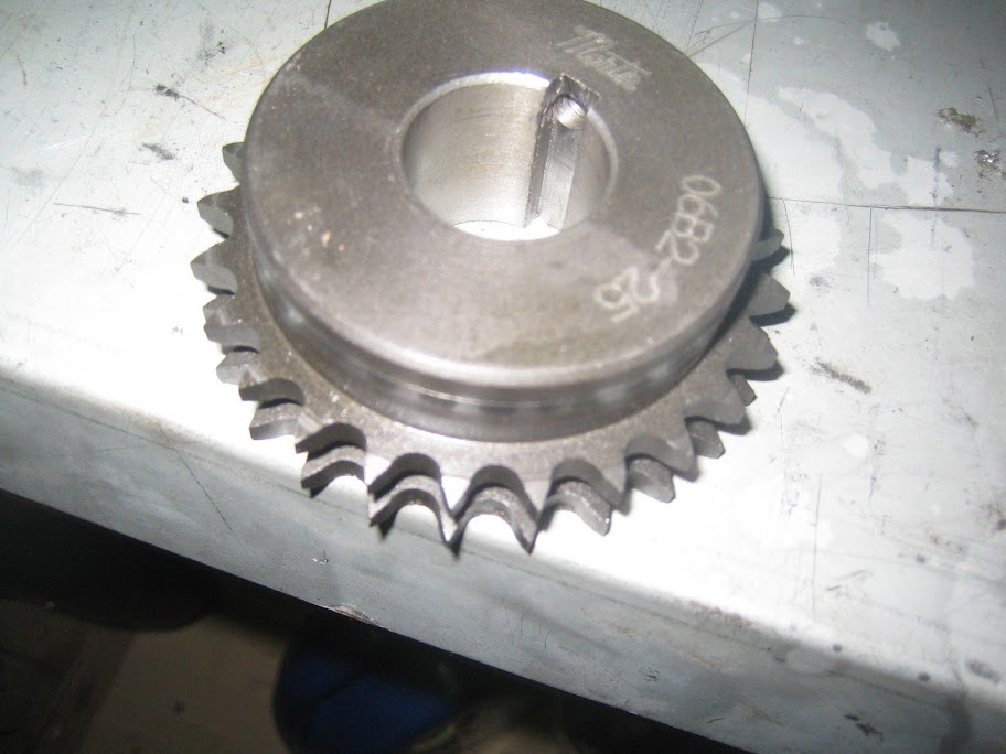

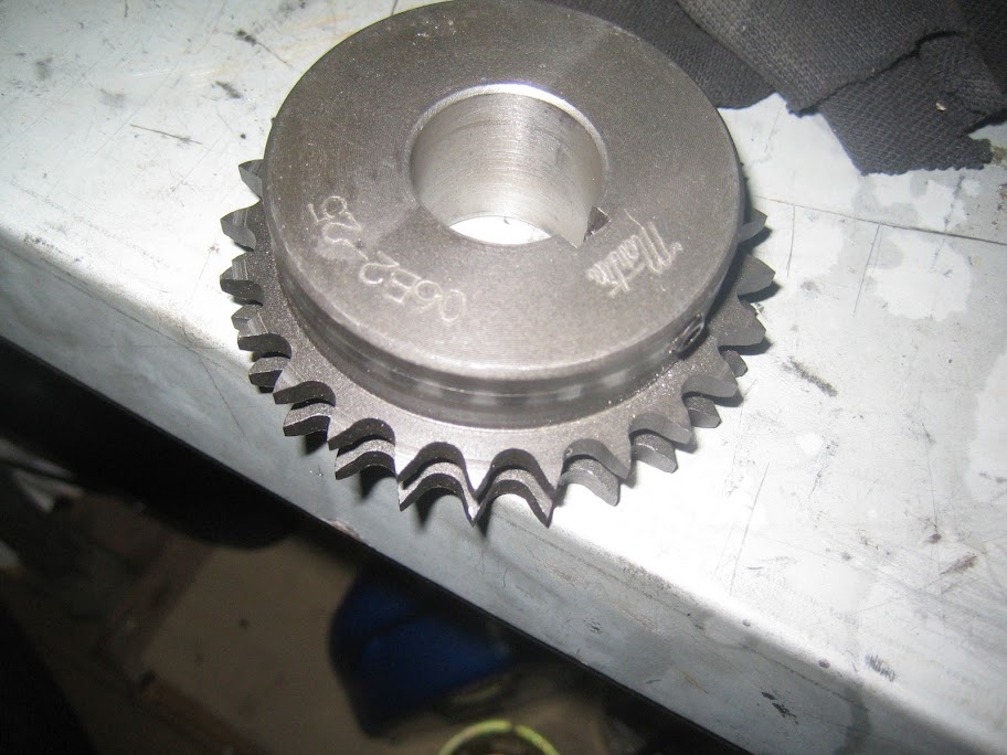

I got the crankshaft sprockets and will get them machined this week. The only thing keeping it in place is the chain I take it, it will be free to move a little on the shaft, obviously not much. Correct?

Andrew the sprocket should have a allen grub screw thru the key way like this. It will bite into the key steel and wont budge.

I have the same sprocket type as you, and a spare. Did you think of removing the extra metal on the front to save some weight or is it in some way required?
Mine is getting machined for Monday. :)

Keep the sprocket as is. It gives more weight on the left hand side and balances out the heavy flywheel thats on the RHS :)

Hmm where did you get a sprocket like that? i was told they didn't came std. with such a shaft so i let a sleeve weld on a sprocket to fit the axle,..

Snoopy, why are you having a perfectly good sprocket machined? Isn't there a standard one that "just fits"? I went to a hardware store and they could supply me with a myriad of sprockettypes, straight, keyed, and/or with taperlock bush.
