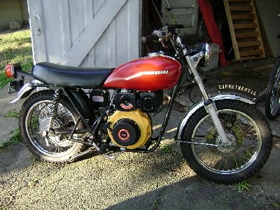

My forum name is HondaJohn, but I go by....John. My first project was based on a wrecked KZ400 that my friend picked up as a parts bike. I traded him a box of carbs and got a solid roller, minus engine, wiring loom, tank, and seat (all the easy and cheap parts to replace). I bought a clone of a Yanmar L70 from Ebay, welded in some extra frame lugs, and mouted it on a chunk of heavy duty C-channel that I milled down.
As a recent college grad with no money, and since I wasn't planning to put it on the road anyway, I didn't use a transmission or stretch the frame in order to keep the cost down (the fact that the frame is twisted and the rear swingarm is seized helped too). I installed a massive custom rear sprocket and used a centrifugal clutch on the output shaft. Its great for messing around in parking lots and rides like an old Rupp mini bike, but it can't do hills at all. I will definetely figure out a gearbox next time around.
Anyway, I'm happy I stumbled on this forum. Its good to know I'm not the only person out there with too much free time!

cool! I like the no transmission option:) I take it speed range is limited?
Welcome aboard.
n
Re: Greetings from New York
Looks like you might have space to go CVT when money allows. Move battery to the opposite side. Put a Jack shaft where Battery is. Run CVT at an upward angle to it. Then run a chain downward off that shaft to another jackshaft (1:1) below it in line with your rear wheel sprocket. Run your wheel chain off that jack shaft.

looks good
how many teeth has that rear sprocket got?
80?
its huge :P
looks a fairly good basic build :)
2 things:
Firstly, perhaps changing the clutch type would improve speed/acceleration and hill climbing?
centrifugal clutchs from what experience I have had with them rob a surprising amount of power...
secondly, can you change the front sprocket for a smaller one? for even more torque?

I had considered using a CVT to upgrade this one, but I think I would rather spend the coin on planning out a proper conversion to a bike that doesn't have a salvage title :-P The rear sprocket has 96 teeth, and the way it is geared it should get me up to around 40 mph. Unfortunately, the current clutch is the only one I could find that fit properly and actually used a chain. It also has the smallest number of teeth I could find, and everything else uses V-belts. I believe I saw a post on these forums with another centrifugal clutch bike that had one.
I am thinking about tracking down another rolling frame a sourcing a 5 speed transmission for my next project, but I should focus on finding good employment first :-D
