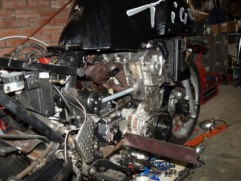

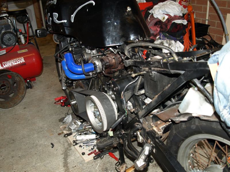

Ok so where am I at? I've decided to slow down a bit and concentrate on doing things right as the bike won't be ready for Hamm unfortunately. That and I went to the machinists on Friday to pick up some spacers etc I was having made and they'd already closed (must close early on Fridays - doh!). Still waiting on some hoses for radiator etc too (cha ching!).

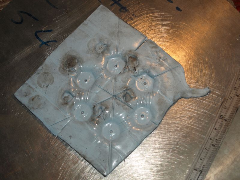

One of the pics attached is me finding the centre of my flywheel cover plate. I scratched my head for ages on this one and read up on google how to find the centre of a circle using straight lines etc. In the end I screwed some long bolts into the crank using PTFE (to keep them straight) and took an impression using blutak. It seems to have come out pretty well. Hole bored now and bearing installed. After I installed the first one I drilled a few holes to put a retainer plate on but then stupidly decided to blow the chips off with airline and of course some got by the seals and into the bearing. New bearing please...
Primary drive is installed although I keep dismounting it to fiddle with things and put it back on. Taperlock is a real plus here.
I've the air intake plumbed from the turbo to the inlet manifold although no room for an intercooler, at least yet anyway. Will have to see if a smaller one can be persuaded in somewhere.
Made another couple of brackets for things like waterpump and to support the gearbox. Also got me an alternator (thanks to Sams suggestions) which fits on nicely and got a suitable pulley and belt for it too.
At the moment not much more to be bought (thankfully/hopefully). The last 10% of the project seems to be the footery stuff. Its taking on a life of its own now and the project dictates the pace it wants to go. Try to outrun it and it seems to burn up the effort and money without moving forward much. Work with the pace and it is kinder.
Next steps to seal up the flywheel cover and install, install the coolant plumbing (when it arrives) and air intake + electrics. One final engine bracket to make before it comes apart bit by bit for painting. Will get some of this done before Hamm so not too much to come back to finish hopefully although I've been wrong before!

So the project has been progressing. Installed gearbox and discovered chain was rubbing on swingarm and frame due to shaft being around 5mm too low. So after some messing around the gearbox has been shimmed up and looking good now only having some fun making new longer bolts for it at the moment.
I machined the flywheel cover plate to clear the flywheel and bolted up so looking good there now too. I also fabricated up the bracketry to mount the bottom of the engine and line stuff up. Alternator mounted up too. Primary belt has been on and off a load of times for tweaks.
Also fabricated a bearing carrier for gearbox input shaft since I am not using the harley primary setup now. Starting to surprise myself with how far my welding has come on in the past year or so.
One more bracket to make then take it all apart to get coated/painted for final assembley, electrics and plumbing. Then see what breaks first and fix that... 8)
