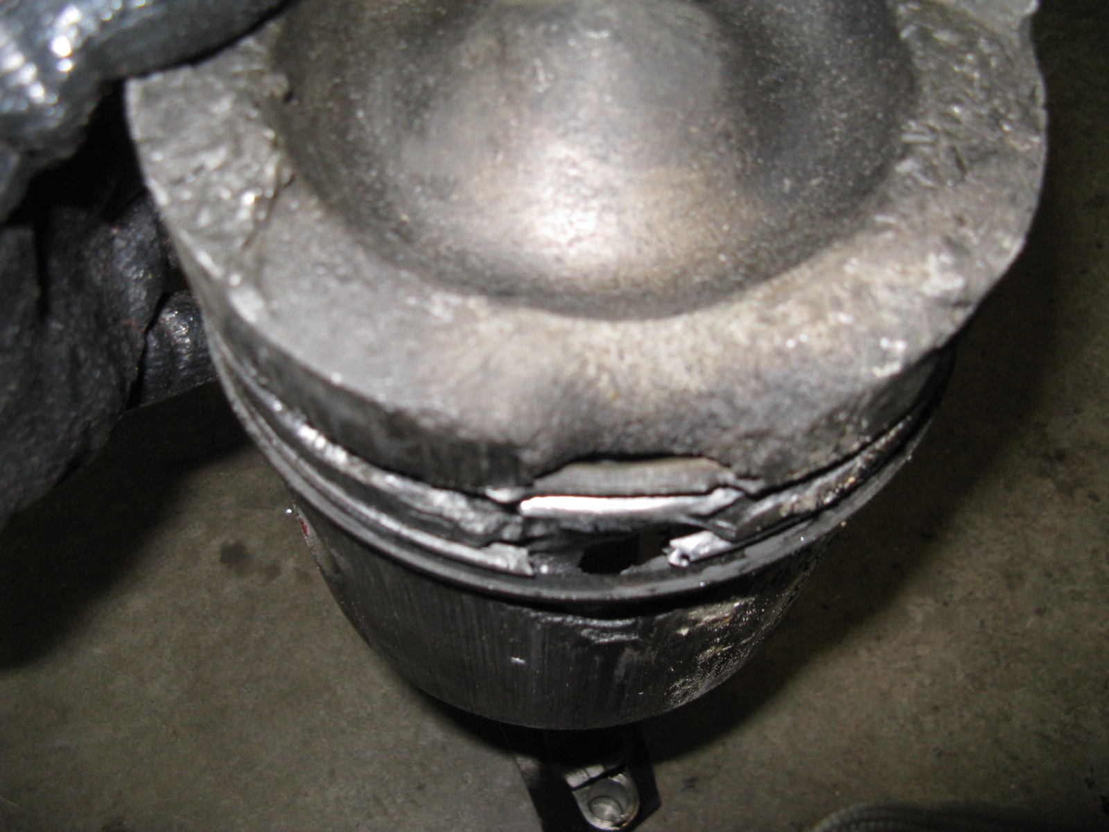

How is your injection timing, mouse? That plug got very hot, and unless your engine is seriously overfuelled (which you would see by a cloud of black smoke) the only way to get that kind of heat in an indirect injection engine is from timing that is too far advanced.
In direct injection engines, bad injectors can cause similar heat damage to pistons. Not sure on IDI, though. How does your piston crown look?

From anything I've read, using "easystart" (I assume you're talking about ether) in an engine with glow plugs is a recipe for engine damage. If you shoot starting fluid on a hot glow plug it will ignite when it shouldn't and you will likely be buying some engine parts. I think most starting fluid made nowadays has some sort of lubricant in it, but if the old farmers talked about engines getting addicted to easystart, it would be because ether will wash the oil off the cylinder wall, thus leading to premature wear of the piston rings=low compression=easystart must be used to start the engine. If you must use the stuff, make sure your engine is cranking when you spray it into the intake so as to encourage the fire to go the correct way out of the engine and so that you will get some oil to your cylinders more quickly.
I've also heard that ether can break piston rings, but it seems to me that if ether breaks your piston rings, then they were on the verge of breaking already.
Bad injectors wreck things. Here is a picture of what a bad injector did to the piston of my Cummins NHC 250. I have no idea how long it took for this to happen as I just bought the old truck, but there is damage to the adjacent piston from piston ring material that had blown back into the intake manifold and gotten sucked into the other cylinder. Fun fun:-)
Phil
That's melted aluminum from the piston on the small end of the connecting rod.  There was more deposited on the cylinder wall.

kewl pix phil, i should take some of my lister pistons from engine being overloaded and too much fuel. and yes ring breakage is also a side effect, i have a honda 50 and the previous owner used alot of easy start on it,the valves needed to be set, the top ring was broken, no other reason for it, it was not worn thin , no other problems other then broken.
