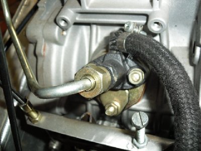

the fuel delivery stop where is this located?
can't seem to find it on my engine
its supossed to be on the fuel pump not?
greetz

Like most of the Enfield conversions with this engine it can be hard to get to when the engine is mounted on the bike - it is tight between the engine and gearbox. I can just about adjust mine from under the bike with a long 5/8" socket and a screwdriver.
What you have taken a picture of is the max rpm setting. On mine this is set to around 3900rpm with no load at all on the engine as this works best for me. The max fuel governor you want to set so that at full throttle and going up a hill at a reasonable speed you have light smoke from the exhaust and no noticeable loss of engine power. If you can find an easy way to adjust it the best thing to do is keep winding it in half a turn, go out and ride it up the same road and repeat until you notice a power loss and then wind it back out half a turn. At the very least you want to cut the black smoke down.
Hope this answers your question - let me know if you need anything more.
Cheers, Dan
Cheers, Dan
