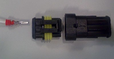

Here you go, the 3 way version. I’m told that there are other sizes available.
Note how the waterproof feral on the cable is designed to be positioned so that it is actually attached to the pin when it is crimped on, it being secured at the back end of the pin that usually only crimps down on the wires insulation.

Neil, PM me if you need a crimp tool. I can do a lender by post no prob.
Pin crimped using the smallest teeth of the crimp tool
How it goes together

THanks Stuart, they look like the same style crimp as on the ECU plug :)
