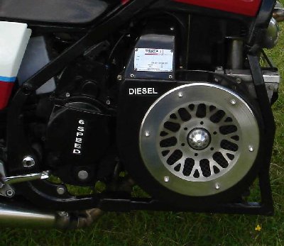

Here's a close-up
Re: 2 stroke trans idea
Thanks for the pic Stu its a better one than I can find. A word of warning, allways take lots of pics when creating, this is hard as its not high priority. On mine which was not too hard, split the engine and get rid of all the bits you dont need, kickstart, oil pump etc. remove crank, 4 bearings on crank remove outer two, to use again, bearings were 30mm ID, so had a length of 30mm stainless machined with thread on one end with woodruff key slot, these were same as original crank so original drive cog and nut fitted. On other end another key slot to take taper lock pulley. Blank plate fitted to where cylinders were. Plug made for kickstart hole.Whole engine mounted 90deg, crank at top. Breather which is now at the bottom I connected small pipe too and this is now oil level sight tube. Place where oil pump was is now at top so now is the breather.
Bit of oil in crankcase just to keep two bearings happy, away you go 6 speed box and oil filled clutch. Hope this helps.

That's a very good written description of how you did it and will help a lot thanks, I have access to a small lathe 3X12 and lots of metal practice material , I also have a small milling table for the lathe bed so key ways are no problem, the picture was very dark and not easy to see clearly between the engine and transmission but It looks like the same idea. Where you go through the engine where the crankshaft was did you install anything to splash feed the oil so the bearings are lubed properly or how do you lube the shaft bearings in your install. And the other entry is right pictures are a low priority during a build but pictures are able to describe far better than my red-neck written thoughts. This is a great site and after talking to a few local friends have a few others interested in similar projects, one wants a diesel quad to go with his diesel truck. But it does spark the imagination. Thanks everyone now it's off to gather more potential parts to modify. My point in what I plan to build is HOW CHEAP CAN I GO and make it all legal and work...
No nothing to spash feed oil. But the space where the crankshaft was is half full of oil, so the bearings are half submerged.
Dont forget they used to work with just a mist of oil now they have plenty.

Good to know. I suppose some kind of baffled vent wouldn't hurt either.sbrumby wrote:No nothing to spash feed oil. But the space where the crankshaft was is half full of oil, so the bearings are half submerged.
