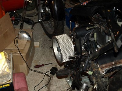

Today I managed to get my grubby mitts on a suitable front pulley. Took a while in coming but finally sitting here in all its glory. What I hadn't bargained for was the fact it weighs about 5kg! I guess it won't wear out any time soon though maybe should have researched an alloy one or something. Still, got it for a measly £20 which I thought was excellent compared to online prices. Tempted to drill it or something but thats maybe not the best idea so I'll use it as is for now.
I've also to make up a bearing carrier and plate to hold the engine output shaft going into the front pulley. Have got the bearing so far, just wondering what thickness alloy plate I could get away with to hold it. Am guessing 10mm for now.

"Most nervous about getting the belt straight and correct tension at the moment."
can't say on your setup, but the harley setup is pretty forgiving. my belt on a harley had a idler on the slack side to adjust tension. i run it a little loose to conserve on power consumed by the belt. readjusted it after the break in. the alignment is to forgiving as it had a little wider driver pulley than the on the driven side. i was amazed of the amount of play in the clutch hub with the clutch disengaged. kinda just moved where it was needed. it all worked great and never had a minutes worth of trouble out of it..
hope this helps..

Cheers for the reassuring words. We'll see what happens I guess. Hoping to avoid a tensioner setup on mine although engine/gearbox are not planned to move at the moment so have to be very accurate to get away with it.

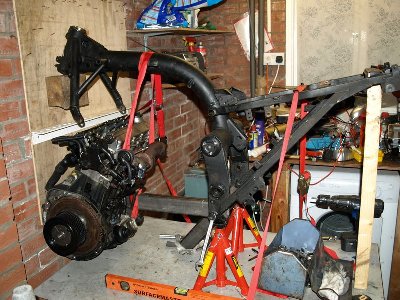

Some progress - just need to keep momentum now. Engine up on the bench along with the other frame and some bits. Gonna be fun trying to align it while hanging mid air! Make a jig? Invite some mates round? Hang it off roof? :) Note the precision engineered jig for holding frame at the back and also block of wood on the wall at the front (works suprisingly well). Now to fab up the gearbox mountings and then onto the engine.
Had some fun getting the custom made engine output shaft to fit properly, but it was a lot easier than I had been worring it would be. Seems straight too which is a bonus. This is getting interesting now as opposed to all the engine hassle...

Last nights progress attached. After mounting everything up I am happy that its aligned pretty good but measured the gearbox shaft height relative to some brackets and it looks to be about 10mm lower than it was originally. A bit concerned about this in case it makes the chain constantly rub the swingarm. Only thing I could do would be elongate the holes in my mounting bracket to move it up a bit. Not sure which is the lesser of 2 evils.
Interestingly I think the original front sprocket was out of line by about 5 - 7 mm. Manufacturing tolerances or something? Rear wheel is straight according to swingarm markings. Ho hum, will hardly hold her back. Have Friday off work to get the engine in and friend roped in... 8)

Another couple of pics. Engine and gearbox trial fitted to the frame and (very) thankfully the pulleys still line up ok. It seems like the full day spent tweaking the alignment of things was well spent since the original panels still fit (had to loose the original fuel tap though). Onward and upward :roll:
