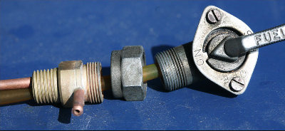

Now that's some fine craftsmanship.
Now please tell me why creating such compactness is needed to dictate using a method like that?
Are you conscrned that movment will cause the two to rub together inside that joint and cause a leak? Once you know it's leak free maybe fill it with expoxy??

With this device you dont have to drill a second hole in your tank.
Injector fuel leak ( spill?) connection is connected to the coppertube

ahhh so the left side of the top photo sticks into the tank?
Re: Combined fuel feed/return
That's a very nice piece of craftmanship
I really like it Nanko. Does it screw into the normal Enfield fuel tank?
Don't fancy making another do you?!
That's the neatest return I've ever seen.
Is that a pice of Kunifer brake pipe?
Epoxies or Silver Solder?

4 mm copper pipe , silver soldered
my understanding is copper like that will work harden leaving the tendency to crack. Just something to keep an eye on.

Agreed! Great little set up, well though out Nanko

Heres a pic of the tap where using on our diesal bike, I had high hopes for it at first as a feed / return but having taken it apart theres no hope for it being used as a return

The petcock mod by Nanko is a simple effective solution. It seems relatively easy to add a mesh filter. My only addition would be to add a length of tube to allow the excess fuel to dribble, pour or cascade into the space at the top of the tank near the filler.

I can personally recommend you order one from Nanko, it works amazing on my Hatz.
