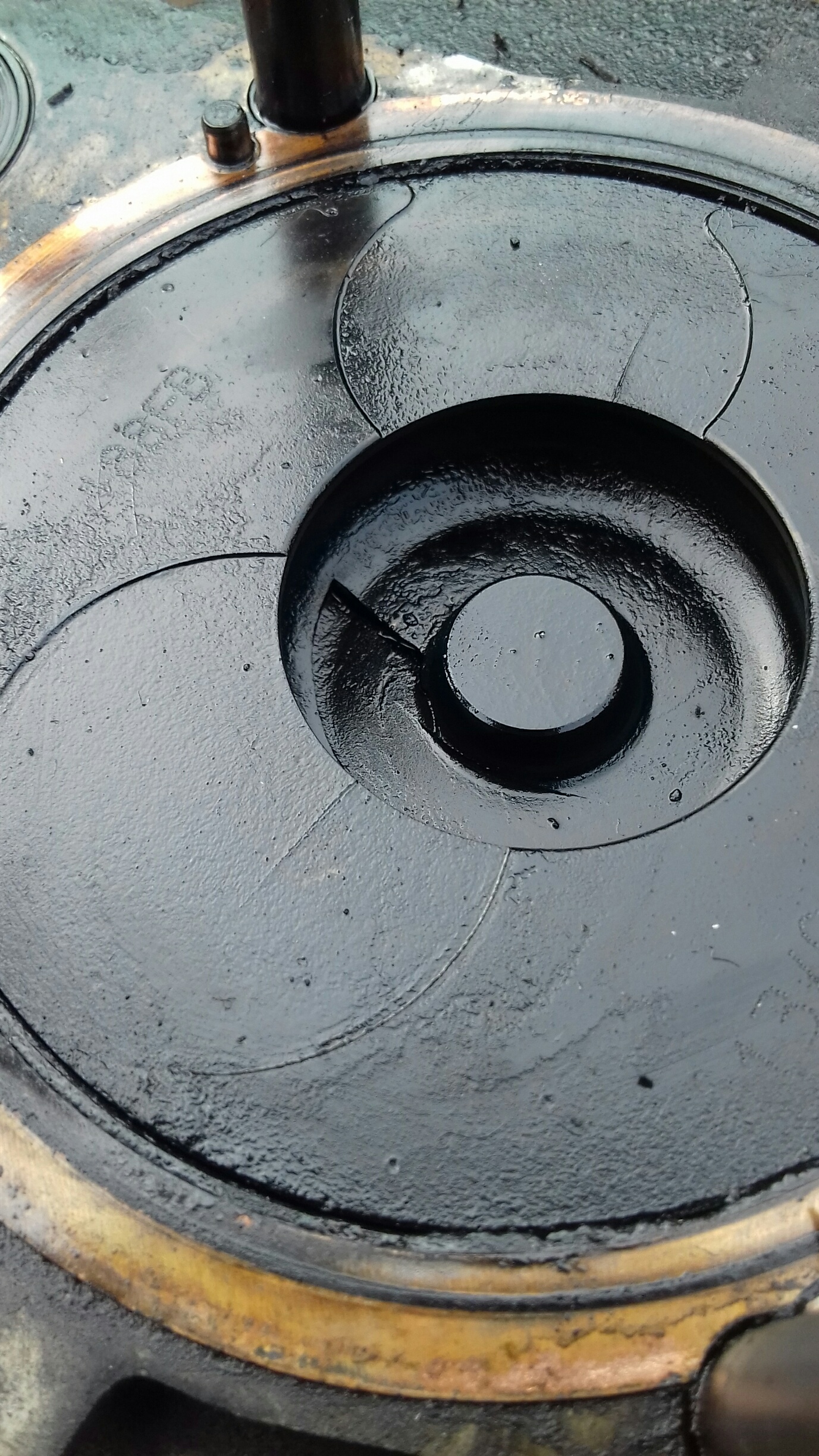

Just as i suspected, because of the smoke before and curious starting behaviour; broken piston.
Cause would be a failing injector, but does anyone know what could cause this?
This 13 HP Wuinsun has not run even 30.000km or so..

Well, pulled the engine further apart, the camshaft seemed allright, no visible excessive wear, i understand how a plunger fuel pump works but.. what could be wrong with it?
The injector nozzle is fine and works as it should.
Symptoms short before the piston busted;
-Bad warm starting
-A lot of smoke,

The piston cracks long before it fails completely and the crack acts as a one way valve letting oil pass from the crankcase and sealing under compression.
Stop looking for faults, install a new piston and it will run fine.

Okay but.. the previous symptoms cannot be explained by this? Or maybe a very small rupture in the piston? i cannot imagine...
so the failure is just China-bad luck you think?
Re: 13 HP winsun broke down..
Yes, replacement piston may be slightly different (and don’t rev it over 4000, or they fail quickly.
My replacement has lasted the gruelling summer tour, completing both the Grossglockner and Stelvio passes.
