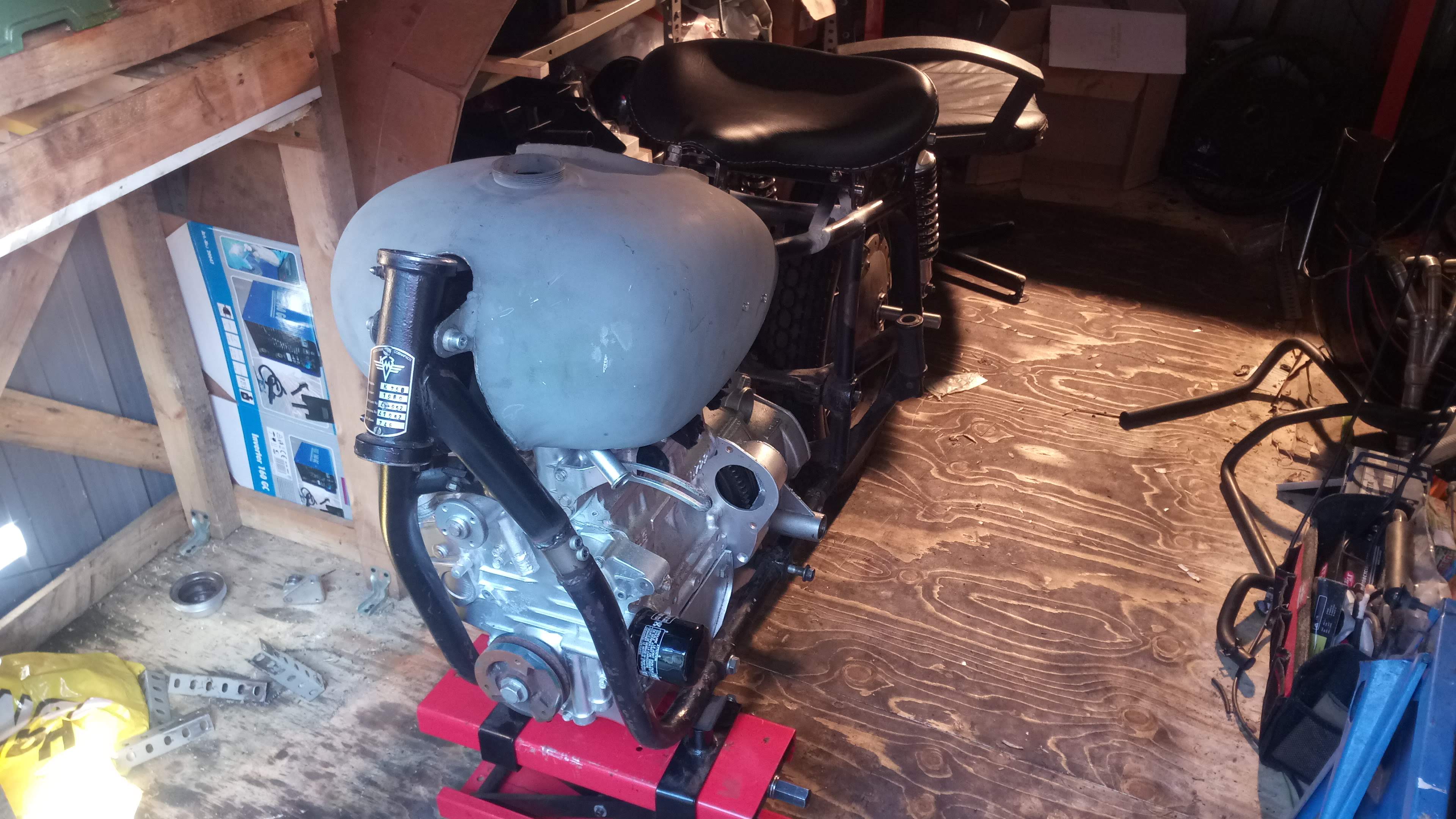

Hello all, quick update. The build isn't dead, as some might've tougth. Due to various reasons I've been neglecting/not been able to keep this thread as well updated as I should have, my apologies.
Here's a sneak peak of where to build is at at the moment.
Currently I am waiting on part for the frontfork and transmission, once those are done I can continue the build.
