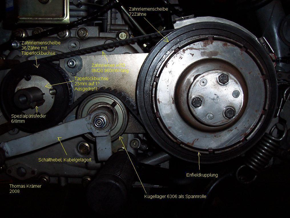

Re: Could this be the start if Sluggy II?
The other option for avoiding the whole primary drive lubrication challenge is to convert to belt drive. Below is the link we addressed here some years ago. And while this one couples a Yanclone to an Enfield box, it would differ little from a Kubota, albeit a bit more expensive than the chain drive. But, it would avoid all the messiness of an oil splashed primary. It does however apparently require an outrigger bearing and perhaps an extended Enfield mainshaft. Admittedly, my German's a bit rusty.
https://mz-forum.com/viewtopic.php?f=60 ... 4&start=50 (well down the page)
