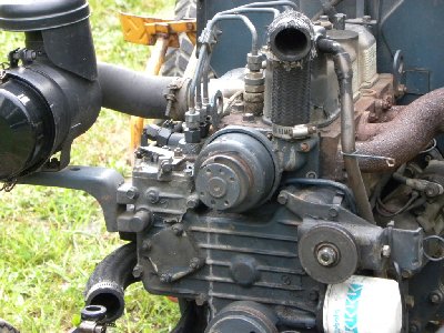

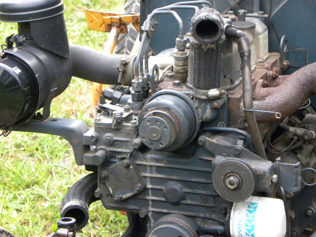

Just a reminder that that "A" series (agricultural) D750 version of your engine was used in tractors as a purely thermosiphon cooling system sans water pump. The dynamo was fitted in lieu of the water pump as below. Given that history, could you go that route?
Re: Engine tuning for effiency
Hmm interesting, would be worth a little bit of electrical system load which would be worth a few %
