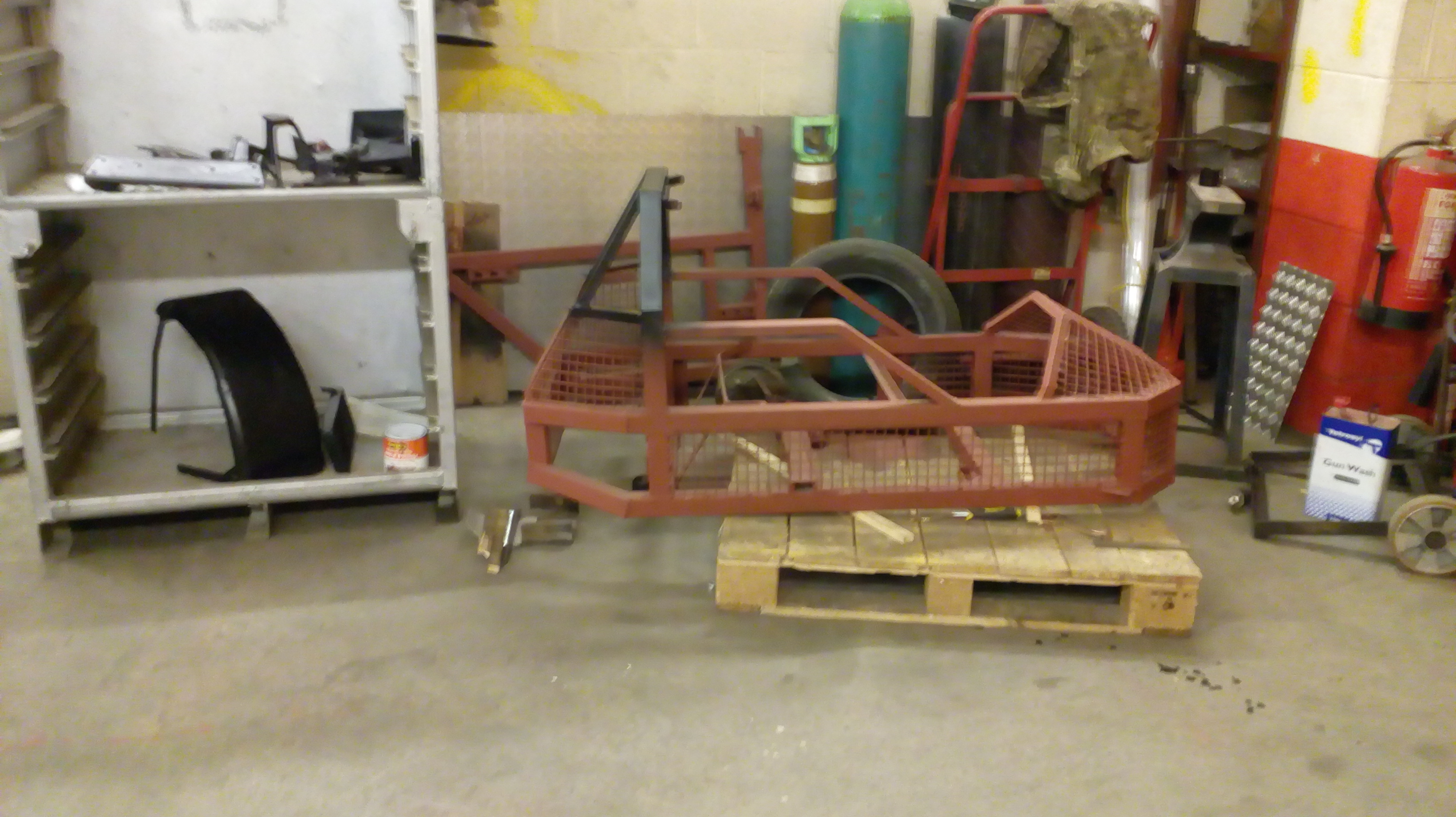

the grinch wrote:I have started filling up the gaps in the tank it is going well so far just need to make a paper template cut 2 pieces check fit get it as close as posible and thats it. This is the first time I have used the plywood form like this. The last time I made a tank for my son’s bike I just made a form for both sides and filled in the middle. But this is a far better approach so far. I hope to get it all done by the end of the month. I have to make the tunnel and work out the mountings. I have a sender unit and will be putting some fittings for banjo bolts for the fuel lines. I will be welding it up with MIG using 0.6mm wire as this seems to be better for tanks. I have an old Cebora 130 for this special occasion. I prefer this for tanks as it gets into all the tight spots.:D
I am WELL impressed with the tank build. This is a LOT of work. Well done.

Getting there.
I have almost done the outside of the tank it is tacked up and I have started the underneath I may have to scrap the sender idea and put a clear pipe on the outside. I expect to start welding on Tuesday if I can finish of the fabrication in time. :D

The tank is done now not the best welding but it is completely leak free all pressure tested hence the rust. I just used some washing up liquid and water mix and a coolant pressure tester attachment with a car tyre valve bodged on to the end. I use between 4 and 8 psi of air( much more and as I found out the the hard way on the first tank I ever built the tunnel will try to turn inside out :lol: ). The tank mounts are made and tacked to the frame. I need to find some banjo fittings but that is not the end of the world I have made the points for the level hose. Although it is not the best welding I like the way it looks. The plan was that I would give the whole thing a skim of filler to smooth it out but I’m going for rough and ready so I think I will just clean it and leave it as it is give it a coat of rust converter and red lead it for now. I think I need to look at the foot rests and controls next shouldn’t be that difficult. I think that I will be near making a list of jobs to do soon all the big jobs are getting done. :D
