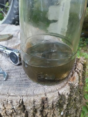

Jar pic..... 2.50$ worth of carb cleaner. Maybe Half a can sprayed into glass jar that once was morning fuel (coffee). This amount covered everything in the cleaner just fine. The good stuff only sold by the Gal. at around $30$
