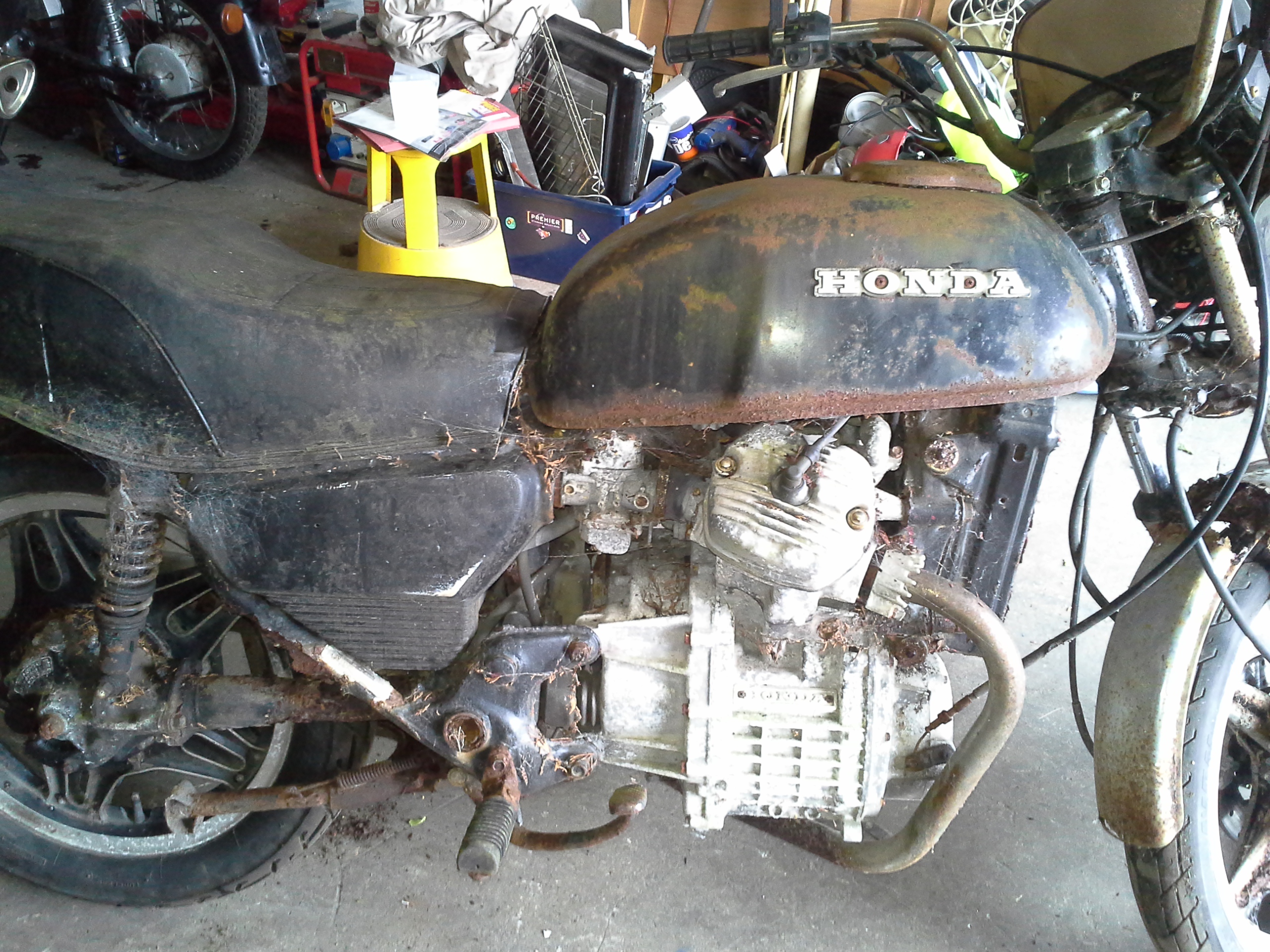

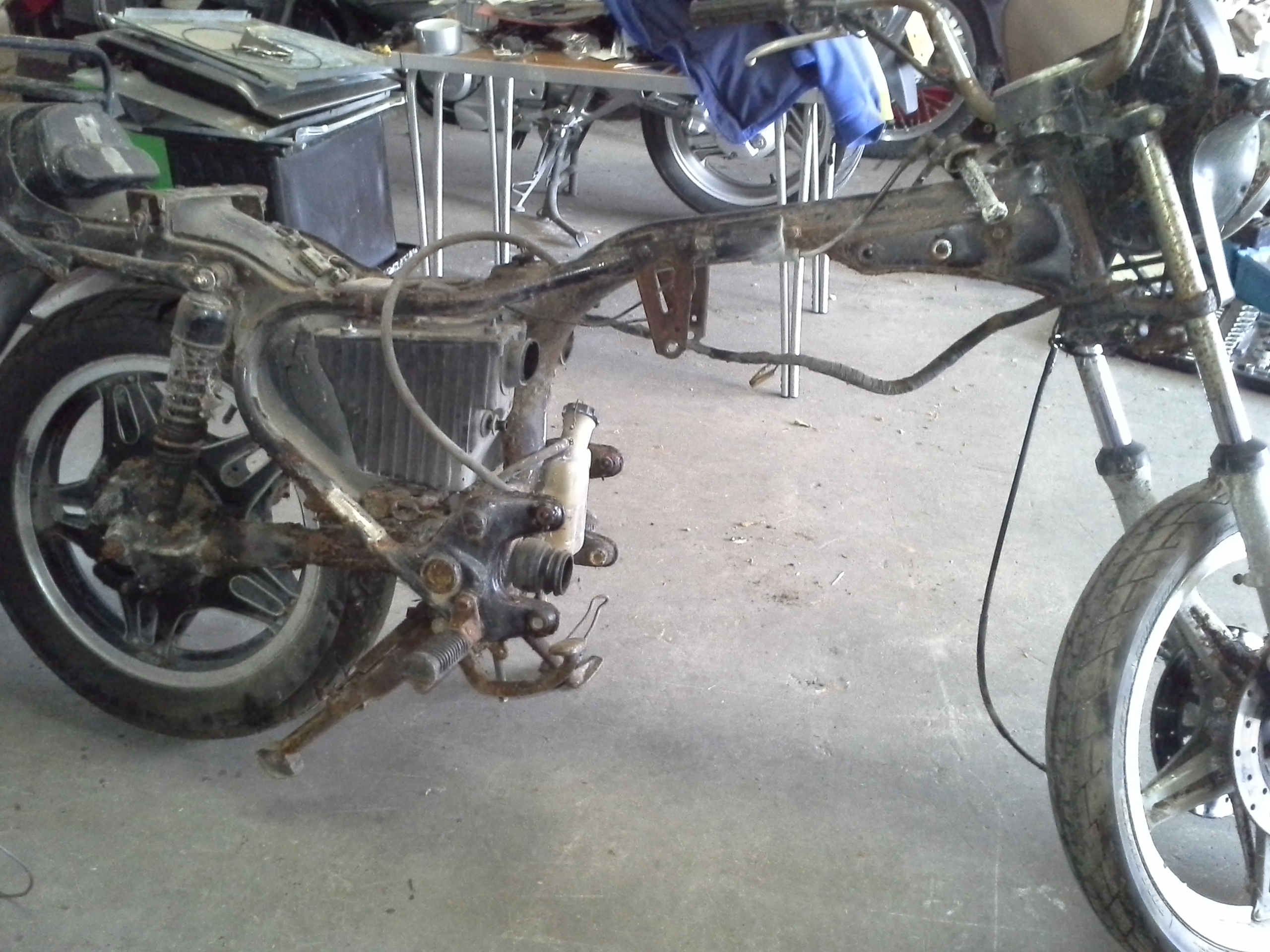

I bit the bullet and started the strip down of the CX. I underestimated "very sorry state" as you can see from the pictures. I new the bike was in a poor condition when I first saw it last year. As I trailered it home parts were falling off, at least they went into the trailer and not on the road.
Looks reasonable!!!
Looks reasonable!!!
Spoke too soon.
What swinging arm?
What swinging arm?
As the teardown progresses the tank looks OK.
Ah well!
No wonder their was a leak.
The frame is nearly there now and I have removed the front mudguard and callipers as required for any build. Surprisingly most of the bolts came off without a problem considering the bike has been under a tree for 5 years hidden behind a pile of soil.
More to follow soon.

Soooo a little bit rusty. :shock:

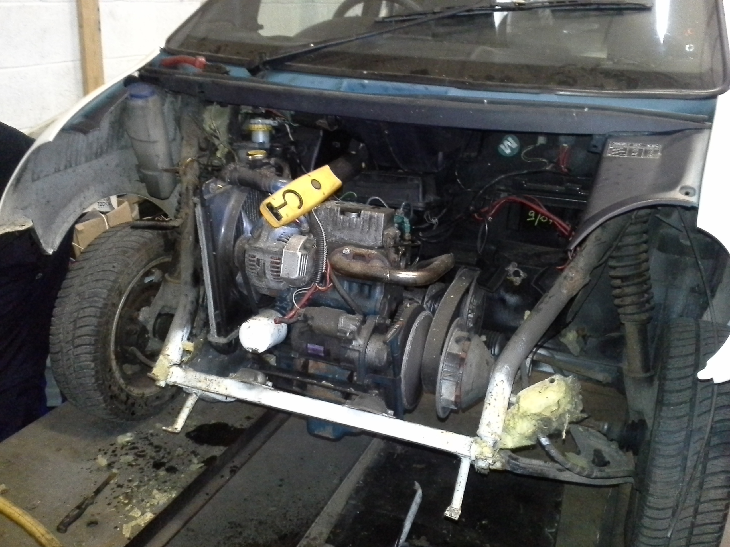

And now for the Aixam strip.
Here we go.
Here we go.
Bit of a sod to remove but finally.
As if by magic.
As if by magic.

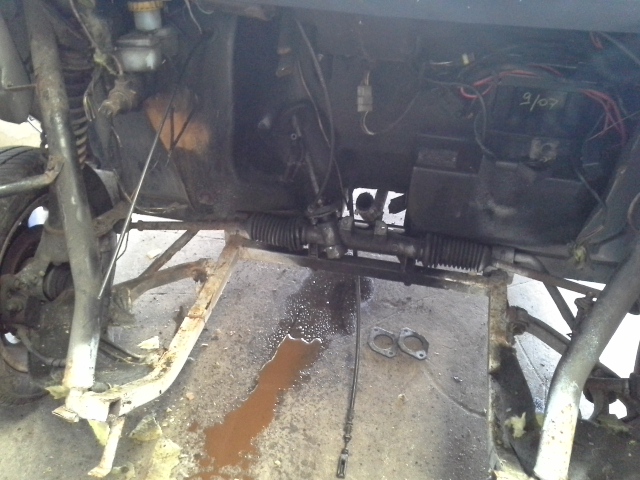

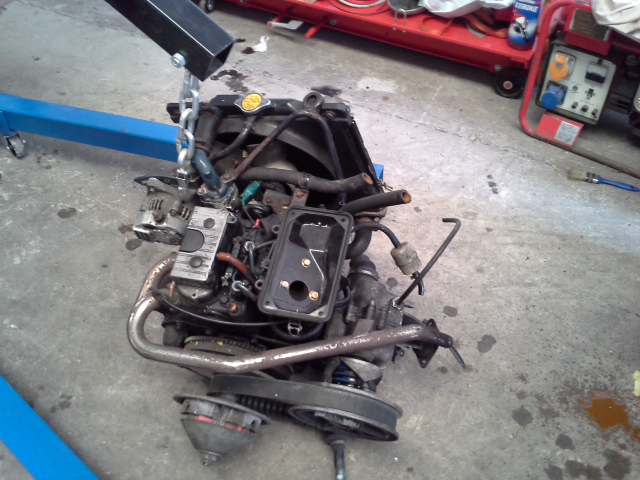

It didn't look that big in the car.
It's as big as the CX engine. I hope it fits in the frame.
The next job is to remove the gearbox and reposition the secondary CVT pulley. After that make a replica of the engine dimensions and mount points in wood so I am not lifting the lump in and out of the frame (up there for thinking down there for dancing as my Dad used to say). I will also strip out the remaining parts from the car that are engine related.

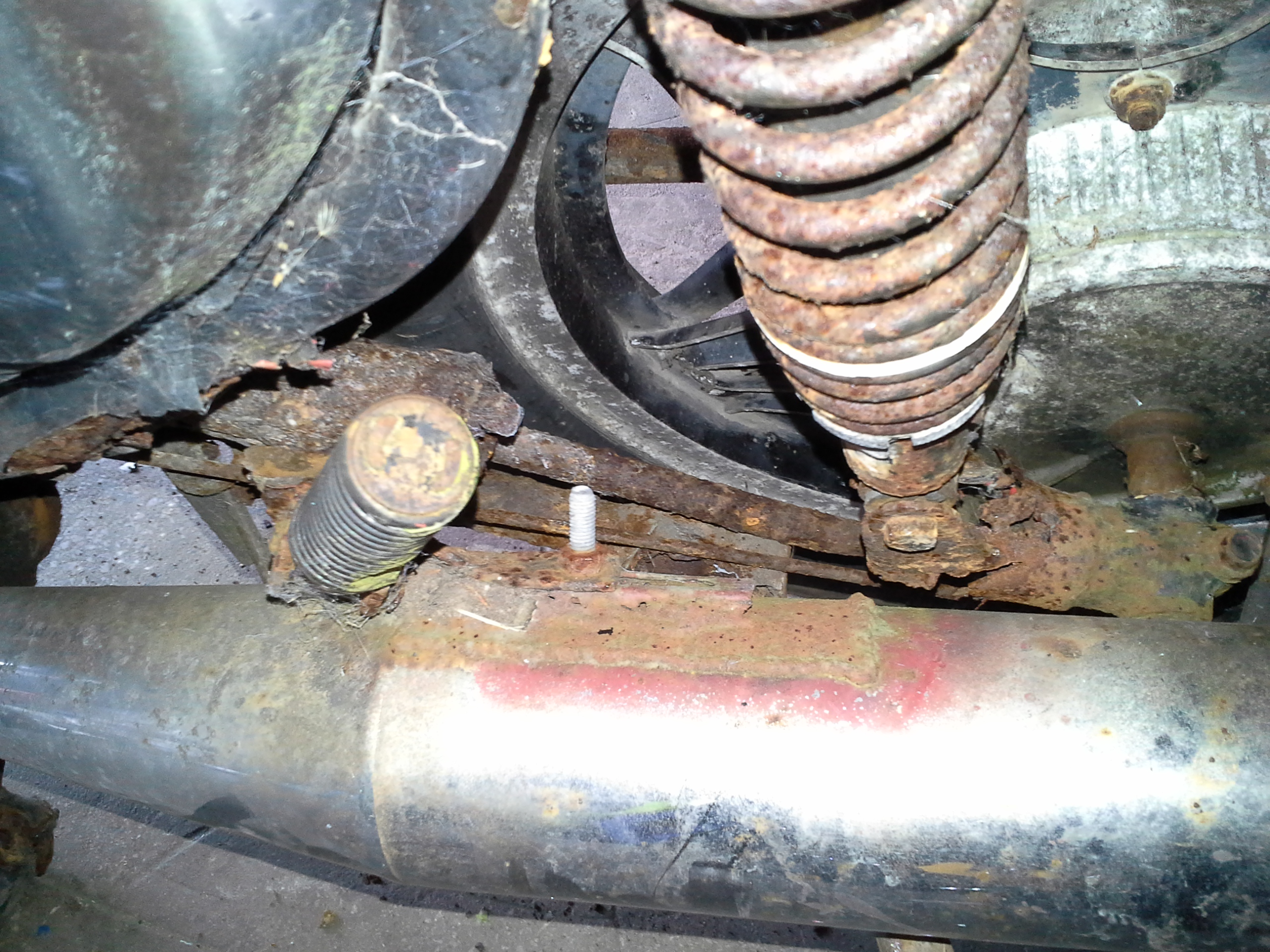

Re: CX500 build.
so much rust thru and near thru on that frame. I wouldn't feel safe using it. But you may have mad resurection skills that I dont have.

Post by Eddy Wane »
Coach. The photos do not do the rust any justice but on closer inspection it is repairable. For the moment I am using the frame as a jig to get everything in line. Unfortunately I need 3" taking off the engine overall length which means that the Aixam CVT will have to be swapped out for a thinner unit. After watching Heiko's video of his build I know it can be done but I do not know what make of CVT he used.

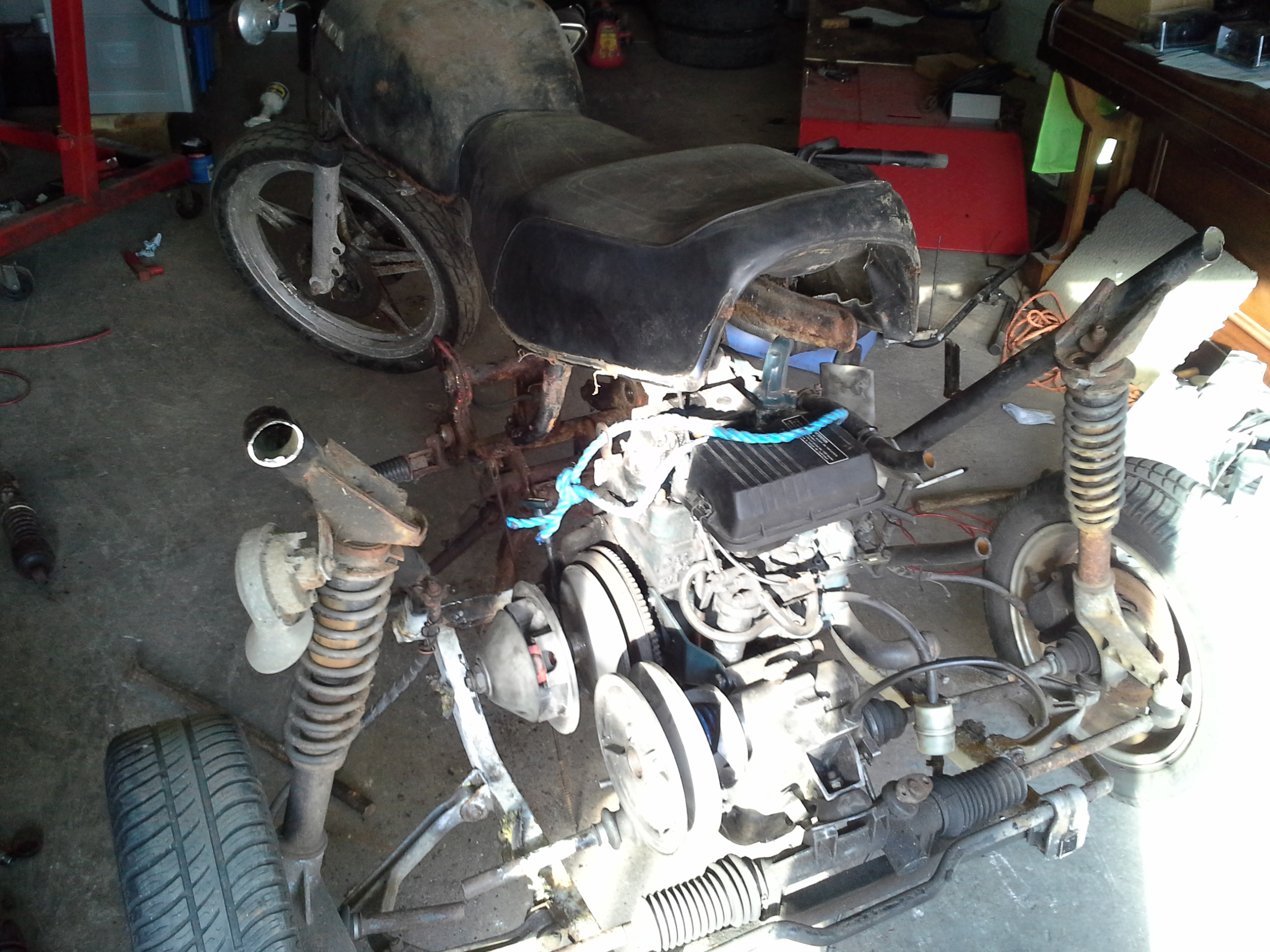

The engine was placed back in the cradle and the rear end of the bike was removed. Both units were then positioned to see what it would look like.
Mock up
Mock up
It does appear to be well proportioned and once the front engine mount has been fabbed up to fit the swinging arm mounts and the rear brace picking up the rear suspension locations I will have a rolling chassis ready for the next stage.
