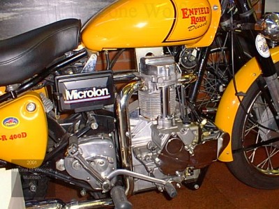

I only have 2 photos of the Yellow Peril so any further information would be most welcome. (see photo). What are those 'Microlon' stickers on the side? I have ample 'Robin' stickers with my parts.

I seems like the Microlon additive is to do extra lubrication for the pump and injector , see:

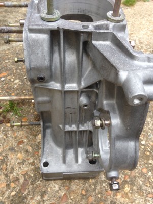

The engine as it was in the beginning...
Re: Robin Enfield Yellow Peril Replica Build
As it is now...

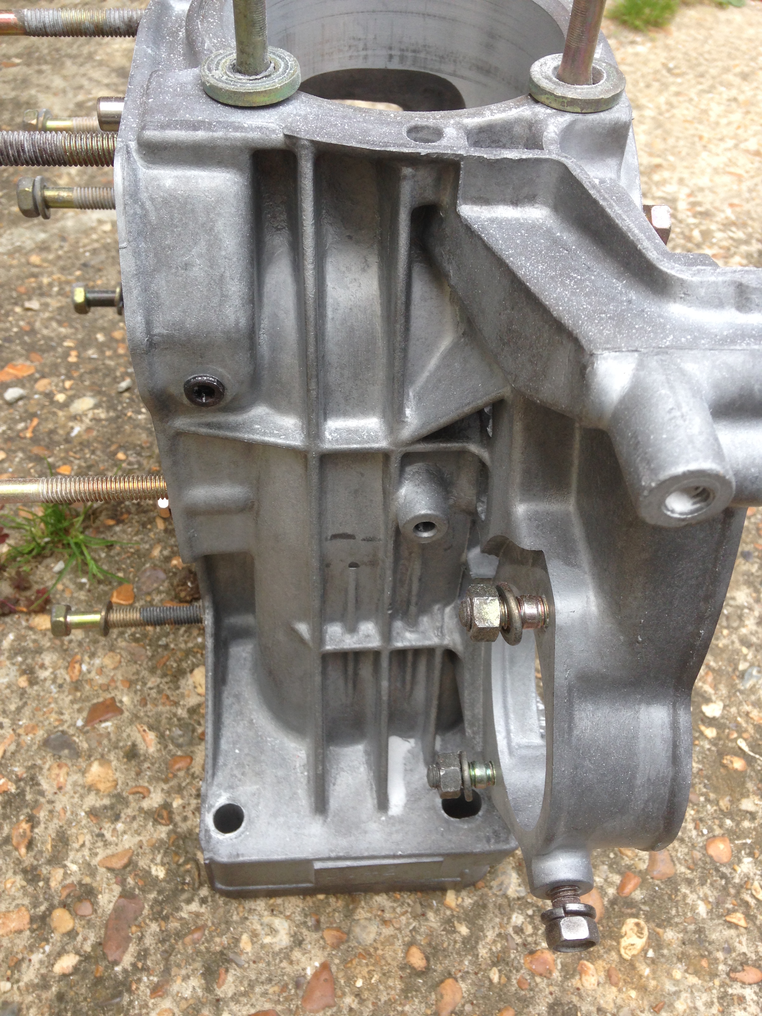

Yeah, the plan is to have a fully functioning, as good as new, electrics start, diesel masterpiece (Aim high) Just in the process of ordering the soda blaster just to give it a nice finish and bring it looking new. The original electric start engine hard a knackered big end bearing, and scored the barrel and leaving the piston a bit worse for wear. The donor engine has all th bits we need, I just have to get the old casing cleaned up and then transfer all of the internal gubbings across to the, what will be as new casing. My son is helping (mostly taking lead) looking forward to getting it all up and running. I will keep posting as it progresses.
Engine so far,

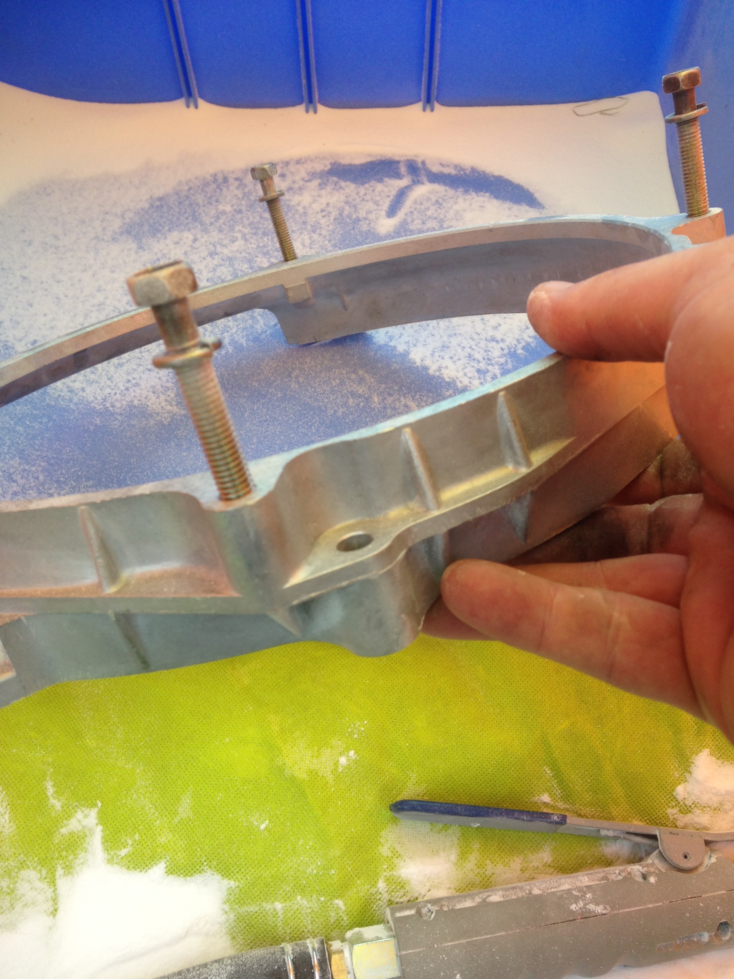

The Soda Blaster turned up so it was off to blasting heaven. I bought a cheap play tent for a tenner to do the balsting in and closed up the doorway using packing tape. This left a nice little port hole to work through. See pics. Engine came up good, so it is wash down and rebuild time using the parts from the doner engine
The engine casing after... (Sorry didnt have a before other than the one earlier in the thread)

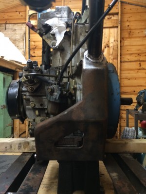

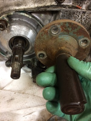

Hi, it's been a while!
After many other projects interrupting and the arrival of my first Grandchild, my Son and I have resurrected the Yellow Peril Replica Project Build.
I seem to have collected a number of DY 42 engines and am ready to build a nice shiny electric start one. I have loads of photos of finished Robin Diesel Enfield's but am struggling with the internal modifications. I have attached some photos of the dry build we are doing using a spare engine, the conversion parts in my possession and my donor bike. If anyone has a Robin Enfield and can advise I would be most grateful.
I have the following questions:
1. Does the outside of the flywheel have to be faced off to fit inside the case? If so. how much? I'm assuming the inside is left alone as it houses the generator and ring gear for the electric start.
2. Do you use the generator from the diesel engine? If so, does it need to be upgraded to power lights etc?
3 Does another bracket need to be welded onto the top frame tube to bolt the top mount to?
4.Does the output shaft just drive the primary drive (Enfield generator discarded). Is this a special part (I have something with a similar thread with my conversion parts).
