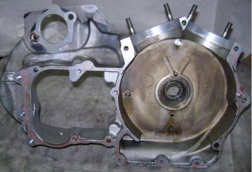

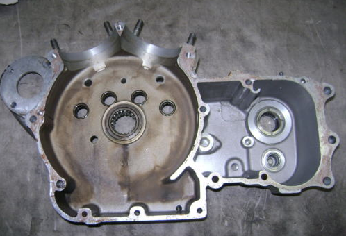

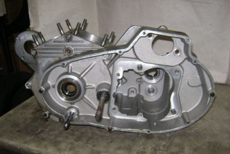

I'm sure there are a few Harley guys that can answer this, but otherwise all suggestions are appreciated. I'm seeing quite a few 91-early 2000's Harley sportster frames about. The sportster unlike the evo and later "ultima" styles employees a crankcase design with the engine and trans cast a single unit like dirtbikes and most modern setups The sportster case splits in half. I'm wondering if I can hack up a crankcase and use with a yanclone shaft in place of the original crankshaft. I've seen a guy on here do something similar with a jawa but my aluminum fab skills are far from comparison. Ideas are welcome.
