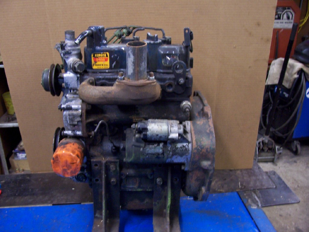

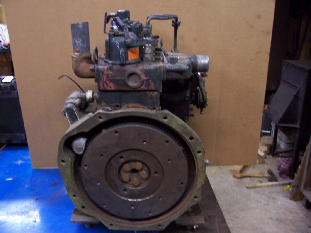

I have run into a fellow that is into garden tractor pulling. He's knowledgeable on building up Kubota engines. He's got a few rebuilt for sale.
Model 850 3cyl 23hp peak, 21 constant in stock form. 700 bucks
Model 850 (same engine) + High performance IP tunable to 30hp and up to in the 60's. but it is thousand dollars more
Anyone know any more about Kubota's?
Physical plant size seems close to that of the Lombardini Heicko used. So does the weight.

saw it said the dry weight of the Kubota engine is 183lbs.
The Lombardini/Kohler Heicko used is listed at 187lb
The Briggs/Diahatsu is listed at 196lb
hmmmm seems contrary to what other's mentions have been. Swore I've seen it said a few times the Kubota's where the heavier of the bunch of triple diesels and the Briggs the lightest..
these figures speak different? or they are measured different? (like fly wheel on some and no fly wheel on others?)

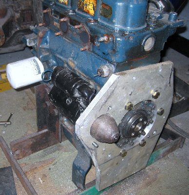

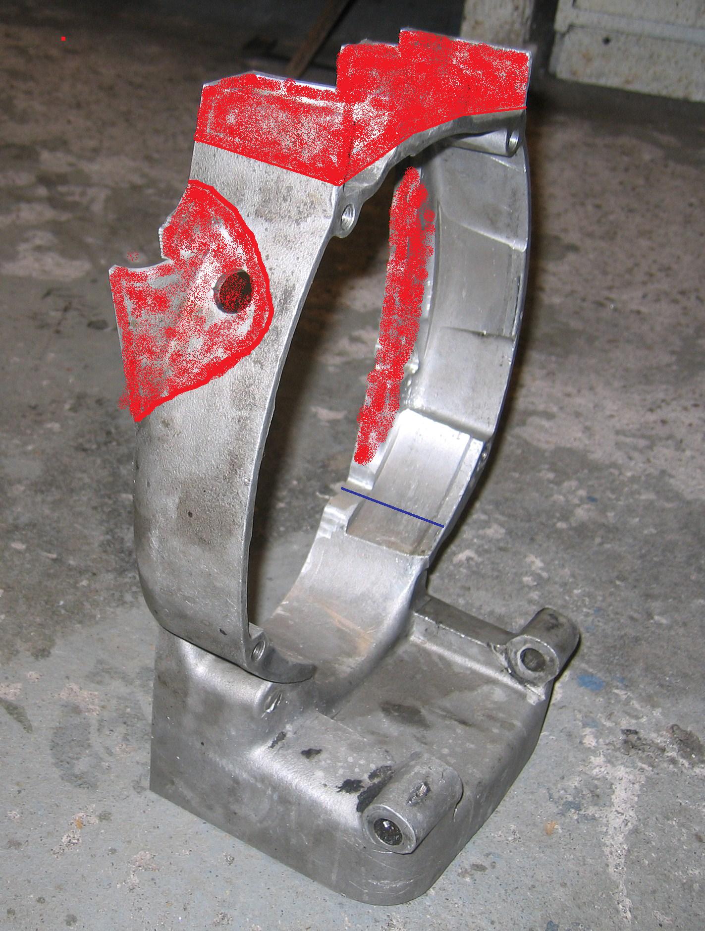

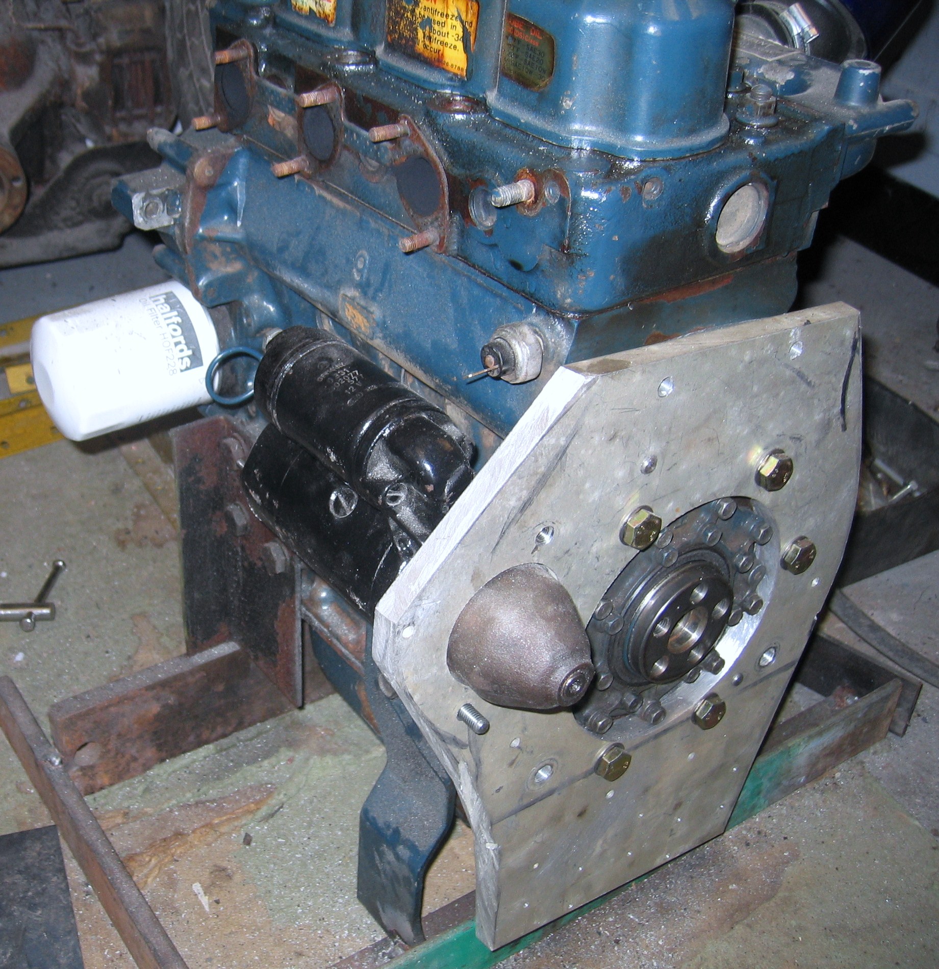

Hi, Im using a D950 which I have mated to a BMW clutch, this only needed minimal machining to fit the Kubota crank (and the holes almost align (the kubota has asymetric holes to ensure the flywheel will only fit one way, nothing a judicious amount of filing didnt cure) The BMW starter motor can also be used and will fit under the exhaust in a similar place to the original kubota starter. BMW clutches come in heavy (early) and light (later) types, having had mine running with just the flywheel attached and nearly stalling when throttled off, but is OK when the full clutch installed I would recommend the early type (mine is the early type).
For flywheel housing I am using the rear of the BMW crank which has been machined down to fit, mated to an alluminium plate. I am currently debating if I should pay someone to weld them together or If I can justify buying a TIG welder.
Phil
Phil

hmmmm... is the MBW starter lighter than Kubota? What model BMW? Think the 850 I'll have and the 950 might be the same.OilyPhil wrote:Hi, Im using a D950 which I have mated to a BMW clutch,... The BMW starter motor can also be used and will fit under the exhaust in a similar place to the original kubota starter. ..
Mine comes with an SAE bellhousing but Im hoping I can lighten the total weight some by going to some other kind of bellhousing doing something like your doing.For flywheel housing I am using the rear of the BMW crank which has been machined down to fit...
using 3"belt drive with dry clutch

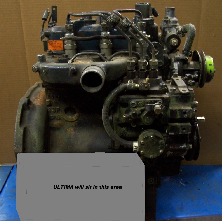

Hey coach , do you already have the ultima box ? if so I could you give me the dimensions ? I really wish I had known the power this thing was going to make I would have tried to fit one in , this 94c is just not able to hold the power . Now with that said are you planning on building for power or for economy ? I say turbo that thing !
Re: kubota... to be or not to be
think my goals for the bike are in my build thread linked earlier but just in case.. goal is economic on/off road travel capable of highway speeds w/ acceptable acceleration. Speed and acceleration is part of safety. If you accelerate slower than typical and move slower than typical you become a sitting duck on the road.
Don't have the Ultima near by. There is tons of stuff on the net about them though so you might even find drawings if you search for a while.
Yes the motor is lighter (mine is from a R75) but has successfully started it in my test rig, If it proves unreliable there are uprated motors available for BMWs (I think they are based on toyota truck motors) from a company in the UK called motorworks. Ist pic shows starter motor attached to alluminium adapter plate. Second pic shows machined rear section of BMW crankcase to act as flywhel cover, sections in red still to be removed . Rear extension left in place as it allows easier alinment in the frame. Phil.

Hi Erik, I've now finished the adapter to mount the engine/gearbox,
, I'm currently making the front section of the frame to accomodate the radiator.
Coachego, I know its an old thread but if it is any use the 850 has a weight of 82.6kg (182.1lbs) according to the spec sheet Ive got.
Phil
