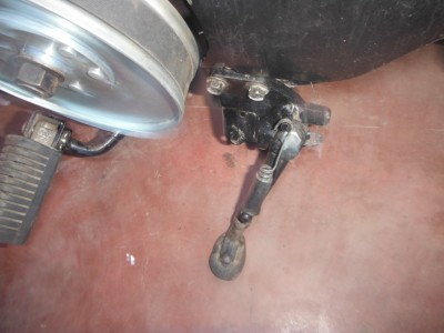

And thos is good so. Because there is an automatic clutch, the bike would run away if somebody twist the trottel.UAofE wrote:But now you can only run the engine when you are on it.
On thr Picture of the side stand you can see a small pice I welded to it. And a fine wire going upwards. The Idle stop hangs on a spring, and this wire pulls the spring down.
Alex

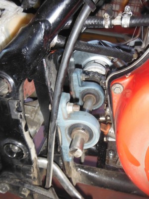

There is no seperate engine stop. There is only 1 engine speed control lever. For idle it is stoped by a spring, an when I put the sidestand down the cable pulls this lever further down comppessing this spring.
I added a picture of the jack shaft. And one of a plate. That plate keeps the hot air from my leg, leg heating is not nesserary here.
Alex
