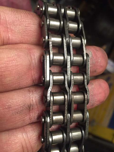

He said he had recently helped out a guy who had made a powerful V twin Enfield by supplying a better chain. His now much more torquey engine was eating through primary chains like nobody's business but the problem was solved after fitting a duplex Deutz chain.
He showed me the larger pins and centre links on an example he had & went on to say they will quite possibly outlast the engine. They are also able to be routed through much tighter curves that you would expect on the return route but can only be ordered with an even amount of links of course. Enfield chains are 06B2 (or 3/8).

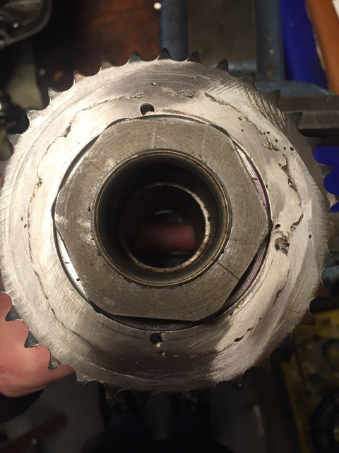

I asked him about increasing my primary sprocket size and he went on to tell me that any bearing supplier could supplier a 'platewheel', press fit & weld them over an existing cog after first machining the teeth from it. It's a common request as you might expect.
So I'm going to source at 06B2-35 duplex Platewheel.

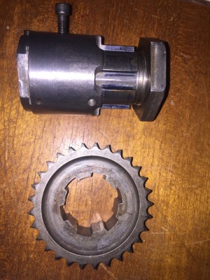

My Enfield has the original engine sprocket 29T & clutch 56T. Ok if you've got the RPM supplied by a petrol engine but not by a diesel! Anyway, anything from about 34T or 35T primary will get me the cruising speed I require, 35 giving a longer pull away in first which some may not fancy. This through a four speed box of course.

Why press fit and welding?
When you find the right machineshop the can make it solid like the original one.

I think making a pressfit and welding cost more time than making it of solid.
The problem with welding and a press fit is that the sprocket can be wobbling.(that is my experience)
Re: Primary Chains for diesels
That can occur if it's not welded correctly - uniformly on both sides.

A tip:
Pre heat the sprocket and hub before welding.
And let it cool down slowly.
I make offset sprockets for motorcycles.(6 - 10 pieces a week)
In the past i welded the sprockets on a hub.
1 on the 5 sprockets was wobbling.
Now i make them out of solid and shape the internal splines.

Got our 35T sprocket back. Looks like they've pulled it off, just.
