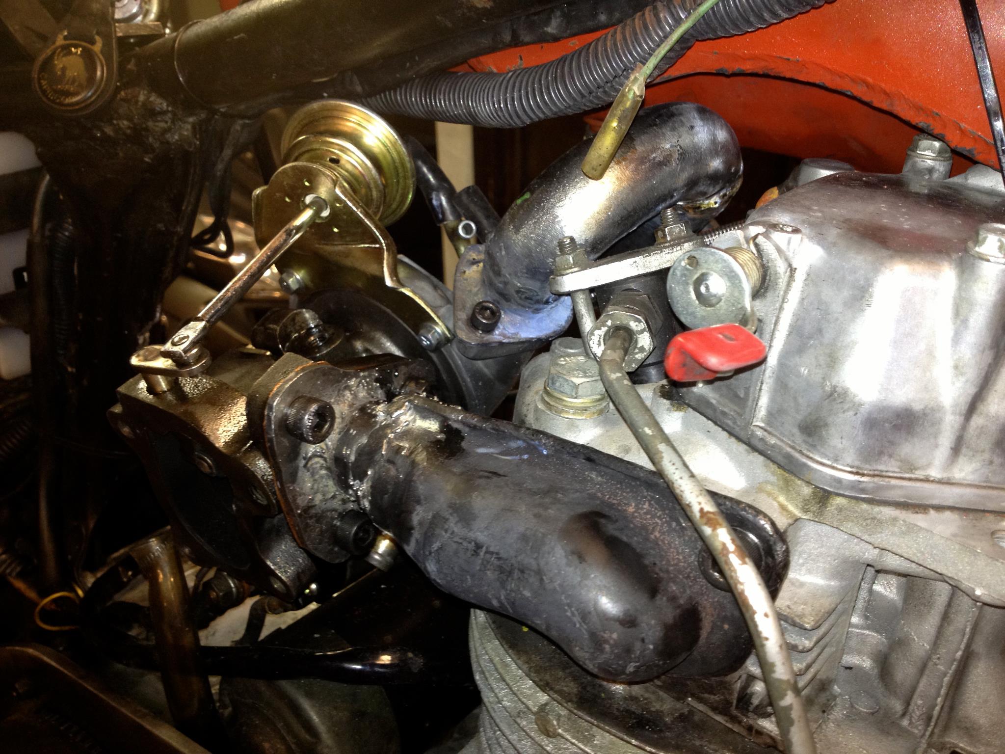

New plumbing.
Re: Disappointing turbo performance
Now thats a short run! Would be interested to hear what the differences are with the new plumbing.

Hope to have all of the fittings and pipes finished by this evening. I do not think I will be able to do much of a test run however due to an approaching winter storm.

New images, plenum with reed valve installed. No performance results yet.

Got the bike finished yesterday. Changed rear sprocket from a 38t to a 43t gearing it down about 10%. It appears to accelerate through the gears smoothly and with more authority. It appears to generate more boost at lower rpm's with modest throttle settings and modest speeds (3rd-4th gear) generating about 4 psi of boost. Full throttle high rpm gives 8-9 psi of boost. It pulls strongly through 4 gear and when I hit 5th it accelerates to 53mph and simply won't do anymore. I have backed the fuel stop all the way out and as it's struggling to maintain 50 or so mph it's leaving clouds of fuel smoke. It is almost as if it is running up against the governor.
I constructed the plenum chamber out of 22ga. sheet metal, brazed at the seams. Just before I was going to make my 3rd test run of the day I noticed that the reed cage was oscillating back and forth with the vibrations of the engine. Upon closer inspection this was not only because of the vibrations but also the turbo boost was deforming the metal ruining the seal I had between the reed valve and the chamber. I have to construct the plenum out of more robust material.
The bottom line is that everything appears to run well, it pulls a little stronger at lower rpm's than before, the turbo is generating boost, it appears to run much smoother at high rpm's. So why in the hell isn't this thing generating more power? Why is it STILL not as fast overall than it was before the turbo? If there was a glaring flat spot in its performance I could go to that but this thing is not giving me any clues.
For the history of this board we've cited Mr. Macinne's work below as the basis for recommending plenum/capacitor sizing to be 2-3 times displacement.
http://www.duccutters.com/pdf/PlenumSizing.pdf
However, the results of the research below suggests that for a single, a plenum 4-5 times displacement is far more effective. And that plenums/capacitor sizes that fall below or above that range are far less effective. I can imagine that sizing above the recommended displacement would result in an incremental decline in efficiency. Whereas, sizing too small could result in the turbo ultimately being a restriction. You'll note that Banzaibob's plenum in the pics above is almost exactly 3 times displacement.
http://dspace.mit.edu/openaccess-dissem ... 21.1/98220 (opens as a PDF)
The Yanmar L100 single in the link below uses a variable-geometry turbocharger. They swapped out the original fuel injector for a Fiat Grande Punto MJTD 1.3 L bar injector that's controlled by a Bosch MS15.1 Diesel ECU through a Bosch fuel rail (model #261-B1-135-201). The pics in the article are from the pre-turbo era. I only wish they had published the results from the modifications made. I've emailed the authors in the hope they can supply us with more results and will post if forthcoming.
https://www.researchgate.net/profile/Ch ... ion_detail (once it opens, click on "download full-text" to the right)
