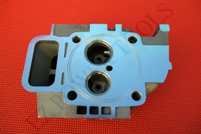

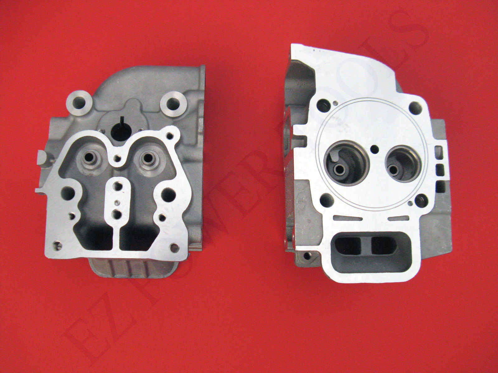

Regarding your problems with the head. It would appear when they modified the head from the old single bolt rocker retainer, they moved the placement of the opening for the injector. In the pics below it appears closer to the intake valve in the 418 head than in the 406 head. I should add that I believe that both heads were used on both engines depending on which factory produced (copied) them.
Double Bolt 418cc Head
Single Bolt 406cc Head

Indeed, it had to do with the injector hole. The cylinder head is very thin there, All the ruptures were from the injector hole to an valve seat..
