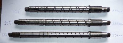

Yes, my experience is to keep the mainshaft as short as possible, keeping the engine balance ( in the frame ) in mind.
Standard Enfield mainshaft length is 11" or 279mm.
The one from henry price is as far as I know the longer version standard+55 mm, the one from Sommer is standard+40 mm, the original Taurus mainshaft is standard+36mm.
Regards, Erik
