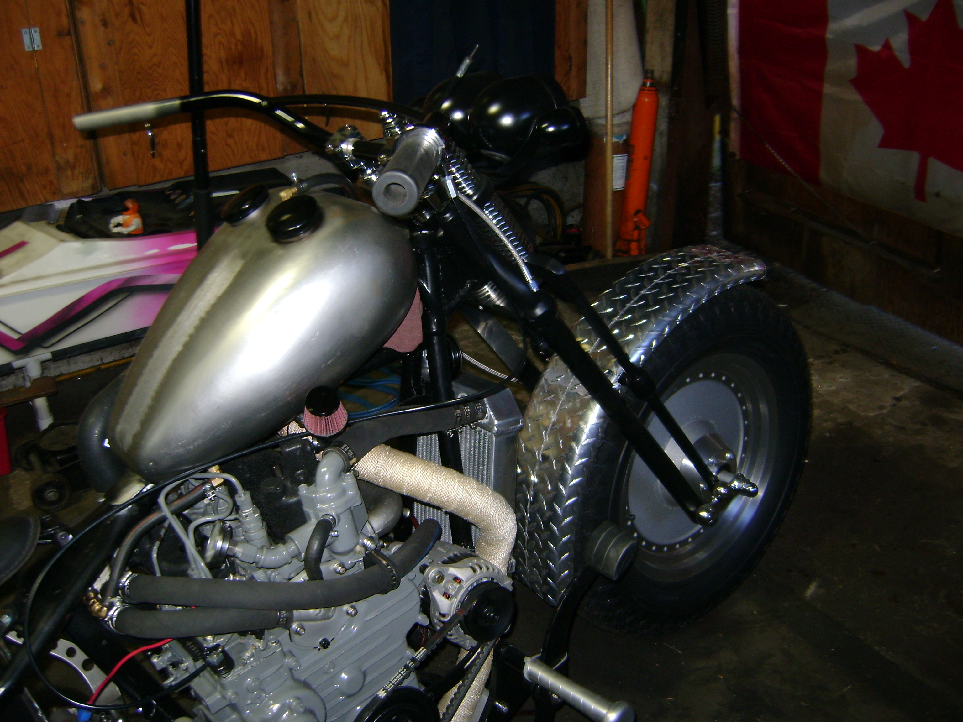

I have a D950 3 cylinder Kubota in my Harley diesel build, and the one thing I would like to do is disable the governor, I know some guys have left it as is, and think it's fine, but I would like to have full throttle control. I have looked around a little but I don't find any real good info. Has anyone here done it? I've had the pump out before, and I could probably figure it out, but I would rather do it right once. Let's hear what you think.

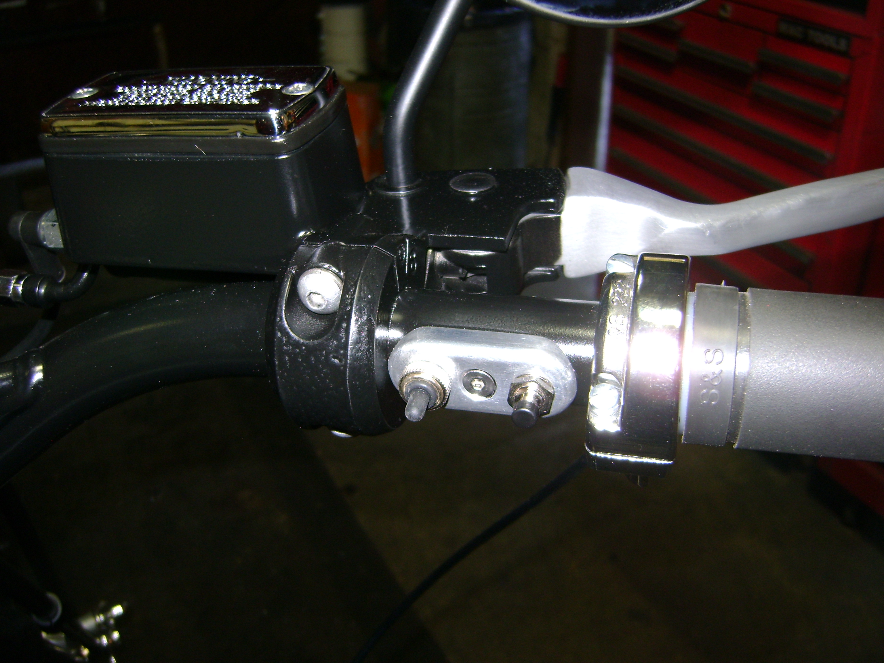

A pic of my signal switch and horn button, I hate wiring

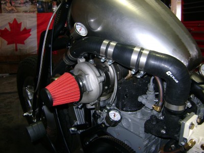

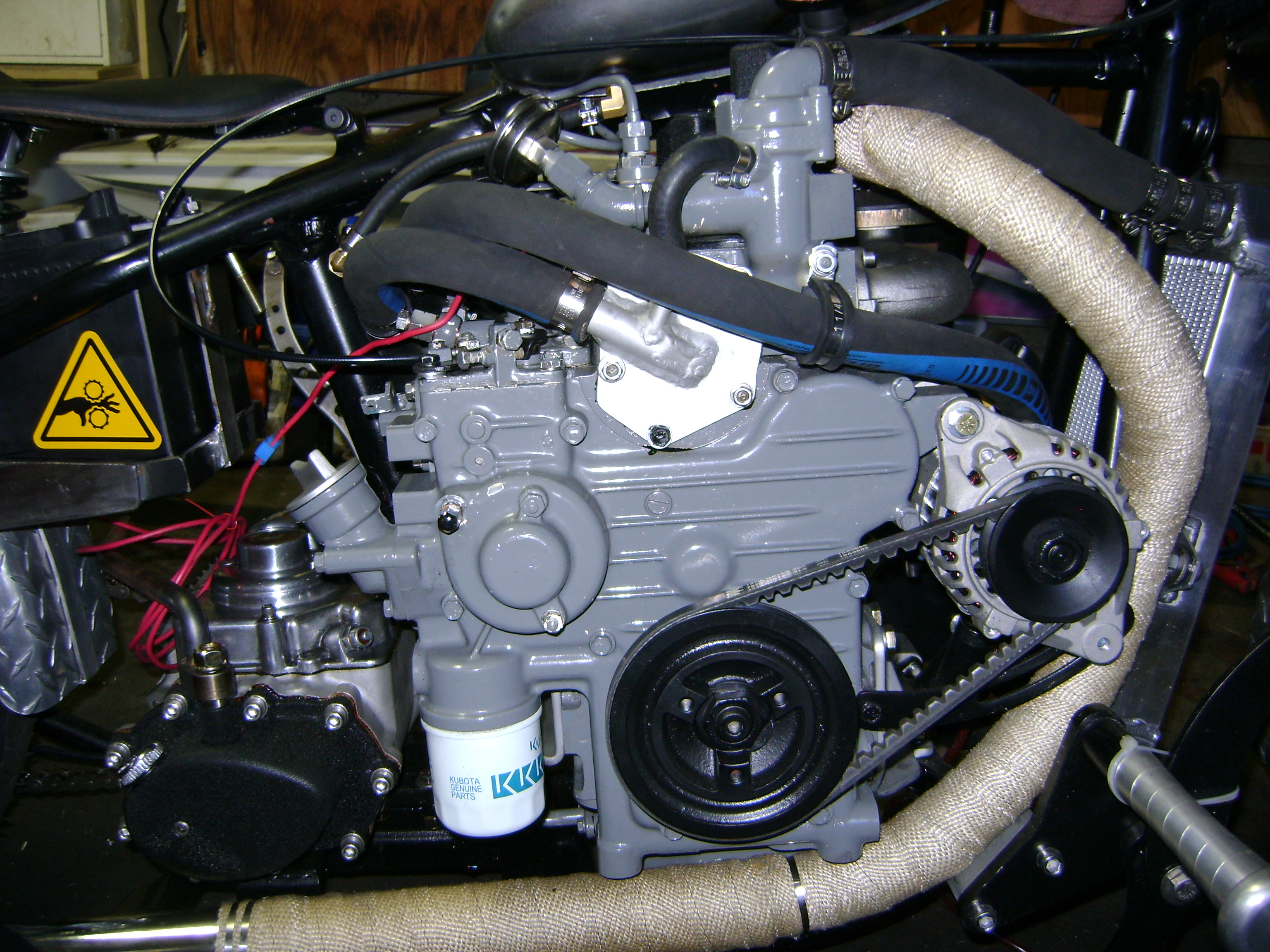

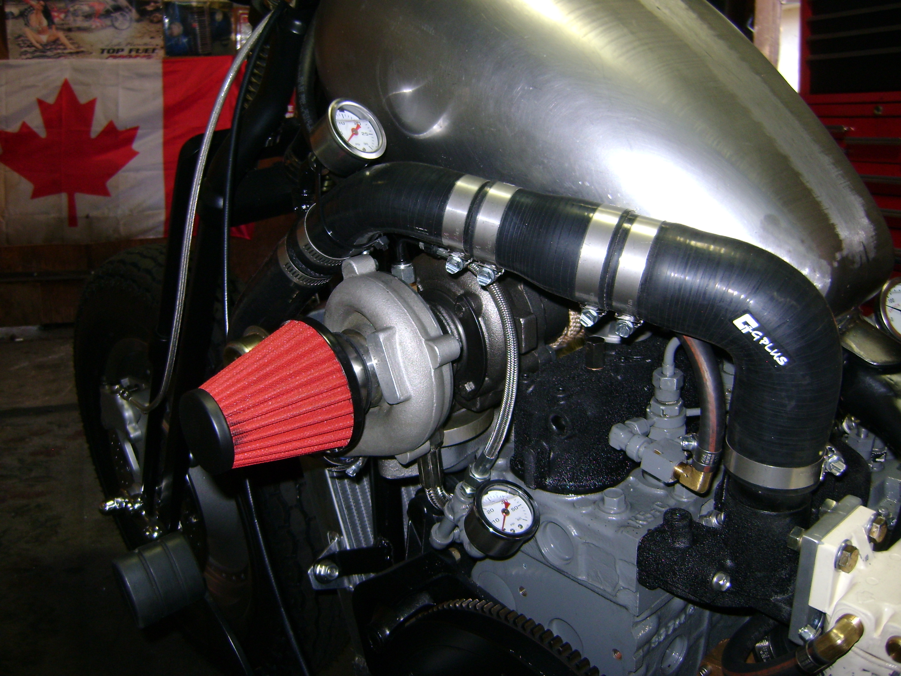

Had a look at what was said, and that is exactly the way mine is set up..one screw for low speed and one for high speed, with a throttle lever, between the two, that I modified a bit to connect my throttle cable to, I have set the idle speed, and played with the high speed for revs, then I figured I better wait till I can do road tests, so I can adjust the fuel supply screw as well, since I put a turbo on I'm pretty sure I'll need some more fuel, and it might affect top revs etc, if I'm holding at 1/2 throttle and start going up a steep hill, I'm pretty sure the engine will still hold the same revs, without twisting the throttle any more, with the governor hooked up, Thanks again, coahgeo, I'll have a look around Orange Tractor, looks like the place for Kubota
