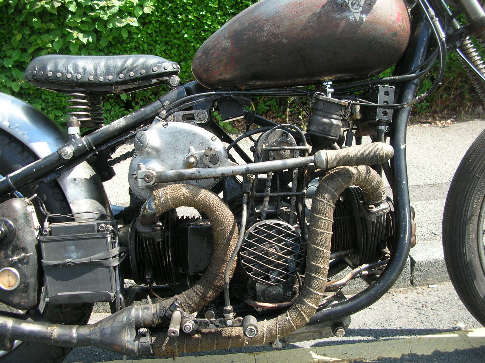

http://sakeracers.blogspot.com/2014/06/ ... wered.html
But now back to the diesel build. Which model of the VM are you using? And we desparately need some pics.

So the sunbeam with the 2cv on sakeracers...how hot sites that rear engine cylinder get; tucked in there out of the wind with no cooling fan. ..
Re: Sunbeam S8
It might push the concept of "cooling fan" a bit, but if you look behind the grid on the end of the crank you'll see a little fan that feeds the tin in front of the rear jug. Might we consider that a "cooling fan"??? Sort of???? Click on pic to enlarge and then I'll stop for fear of highjacking this thread.tucked in there out of the wind with no cooling fan. ..

Re: Sunbeam S8
Wow. I remain skeptical but it must work well enough. I love the bike though.
