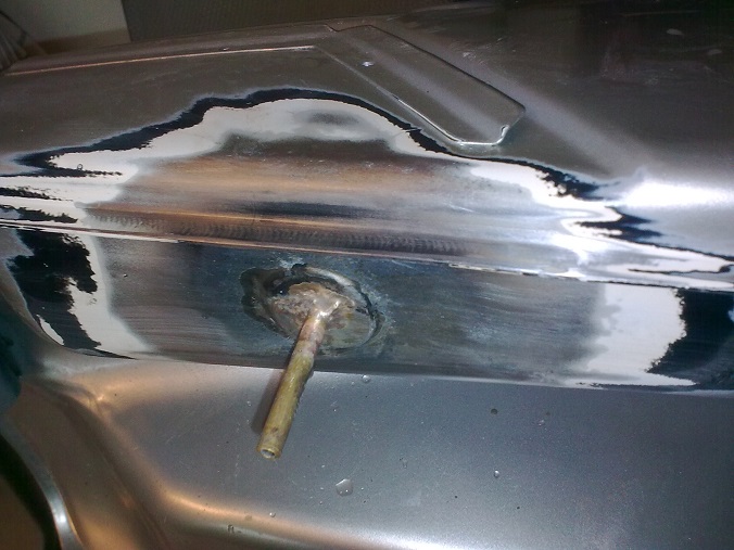

It appears that a diesel engine dictates the need for a separate dieselpump overflow fuel line, in order to keep the pump from surging (leading to inconsistant idling/running of the engine).
Jeroen (from VVM) soddered a brass 6mm (about 1/4'' O.D.) line, that practically runs to the top of the tank.
in the meanwhile i've painted it again, and we are now working on the front fender.
Jeroen has hand beaten/rolled one out of aluminium (or 'aluminum' as they say in the united states of 'bankrupcy').
to be continued.

alexanderfoti wrote:Looks good. I had the same problem with mine, I ended up running the injector leak off back to the fuel supply line with a T
we wanted to do this as well, since the tank was already painted.
however with a T, you could run the risk of getting the mentioned surge, air bubbles that circulate through this by-pass all the time.
so we did it properly just to be ahead of this possible issue.

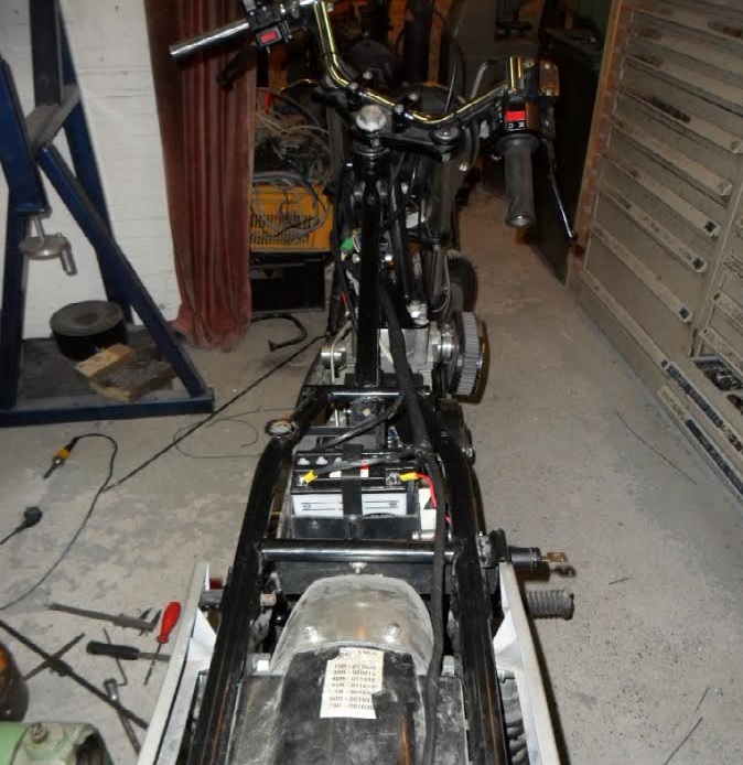

Here we see a glimp of the revised electrical system, whereas Jeroen made a whole new ''cable tree''
The battery still sits in its original housing.
And the side view upon the delrin fusebox that Jeroen made.
He has divided the electrical system into four as displayed.

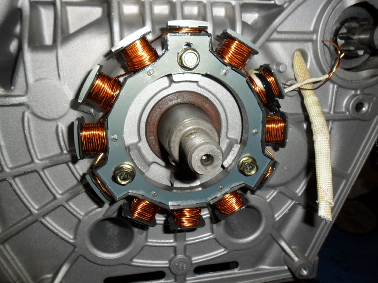

Than there's the dynamo/stator of the dieselengine, for we've let the flywheel be as is on the new engine (need the starter teeth). We know u guys have little issues with the stationairy character of it, in combination with a vario, but the Jawa VVM doesn't have a vario.
So Jeroen rewound the copper spools (increasing the amount) and it now always charges the 14 ah battery. Obviously the battery is now more important for us then it used to be. And alot bigger too.

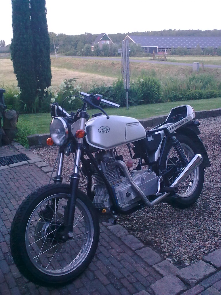

Today we finished the bike, ready for the state roadtraffic test.
proud owner;
while driving i realized what 'the big knock' means.
this really is 'big knocking'. 'turns more heads then a harley'
greetings fellow bigknockers.
