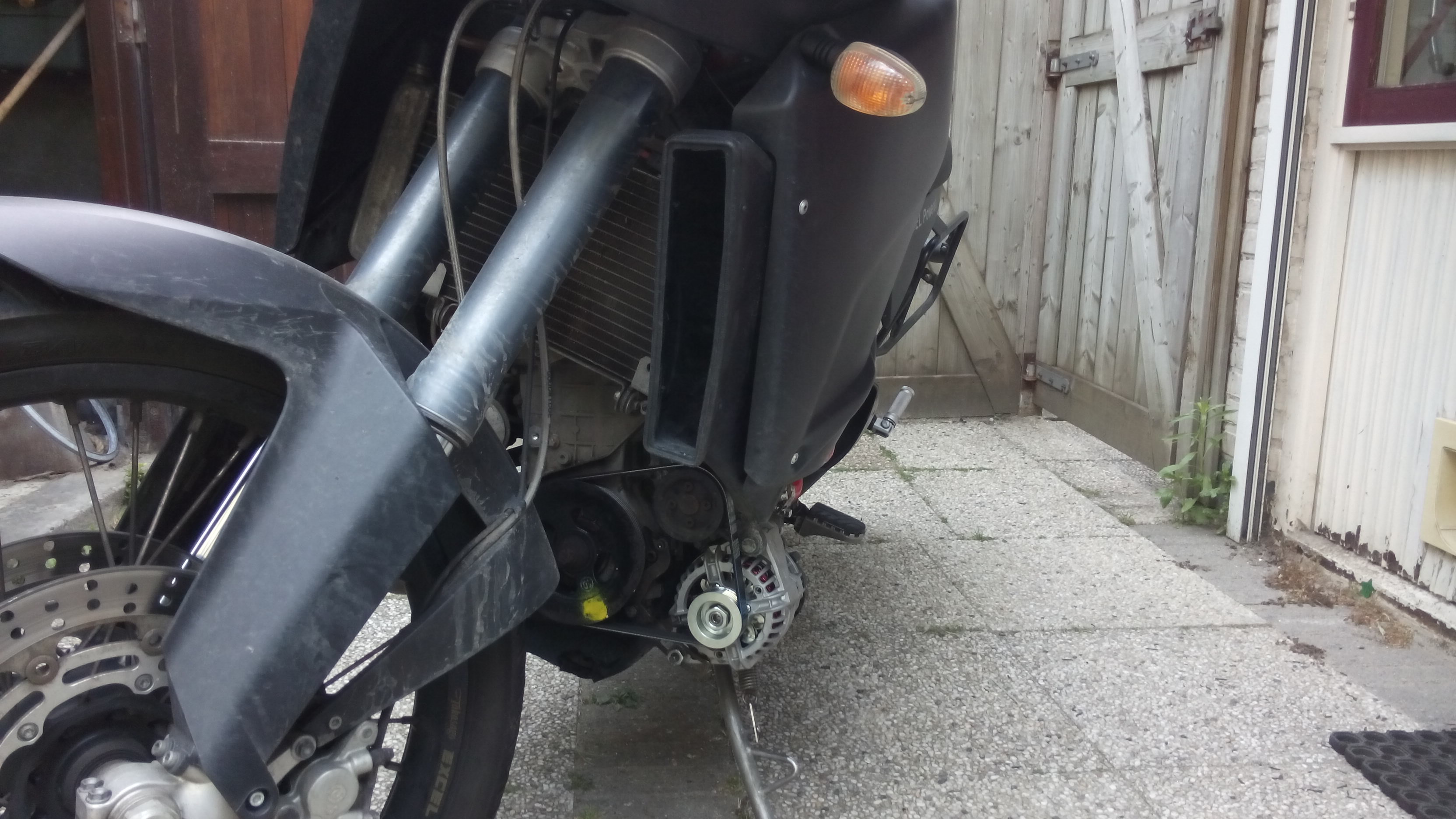

With the c.v.t. sorted i am going to move on and do the dynamo.
It's time to get amps. So here are the before pictures.

Well it works!
I now have enough electricity to run a fair even when idling. 14+ volts.
Just needs to find a better way to get the air out of the cooling system and then i'm done with that. And onto final assembly and then.. making a cover. ahum dreaded activity.

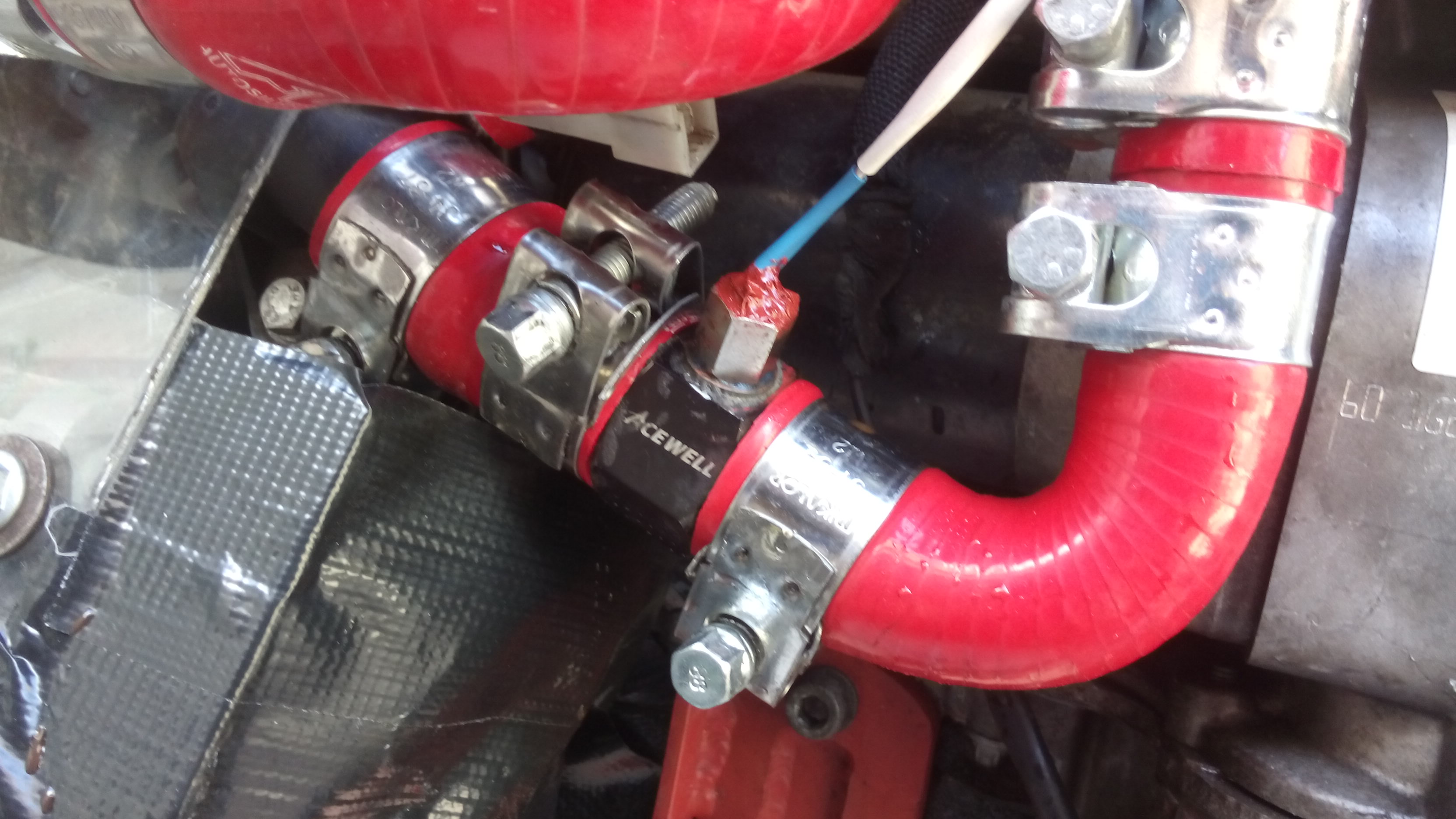

After 10km's on the road i noticed this:
I went home again to find the problem.
So the afternoon was spend trying to find the cause and fixing the temperature sensor.
The broken wire was soldered and covered in heatshrinktube and silicone sealant.
And finally fitted it together again.
Apparently the silicone coolant hoses can be fixed by applying a small amount of silicone sealant. I'll see how long it holds.
I then went for a evening ride and the bike runs well for atleast 100km now. So i'll check it tomorrow in the light again.

Re: My Track T-800cdi (Bert's!) 3,2
What did you source the new radiator from? Other one got road damaged?
- Posts: 334
- Location: Netherlands
coachgeo wrote:What did you source the new radiator from? Other one got road damaged?
It's from a KTM 990 adventure. Almost the perfect fit.
The other one got stress damage. A leak a long time ago due to too much vibrations (after new engine mount part). This was repaired twice. Third time around i decided i'd save up for a new ktm radiator. So soon i'll be spending time working on the Track again.
