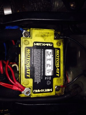

here is the Tiger battery coach. Hope that helps.

Thanx. Does the LDW1003 in the bike have glow plugs?
Yes it does....all 3 of them :D
