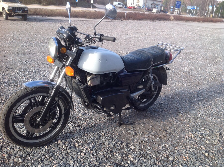

My diesel Honda is finally finished :-) Off to the Mot station on Friday to get it approved and registered:-)
Re: My Honda CB750 diesel project
Real nice looking bike. The Lombardini is a nice looking engine. Would love to see pic of other side too. Also some info on how you made your CVT cover

coachgeo wrote:Real nice looking bike. The Lombardini is a nice looking engine. Would love to see pic of other side too. Also some info on how you made your CVT cover
The cover was a lid over some pump equipment from the old gas station I bought two years ago that i have turned in to my motorcycle and small engine repair shop.

Update on my Honda diesel project.
It is now Honda Turbo Diesel.
Drove about 100km today with my newly installed turbo. Tuned the diesel flow so now it goes good. I recon I will improv it further but for now it's ok. The top speed has improved only by 5km but it pulls strong and the engine goes much smoother than befor. Next thing to do is changing rear sprocket to get higher crushing speed.

Honda Turbo Diesel
What Turbo did you use? Love to see pics of the plumbing etc. What kind of Pressure(s) were you shooting for with the Turbo and what are you getting?

The turbo i used was a RHB 32 but I had to remove it because I found a crack in the turbine house. So I have been now driving without a turbo this summer. But 3 weeks ago I got a brand new one that fits better to the engine. A RHB 31 that they use on yanmar engine. That's what the ad said. Now it is put on the bike and you can almost not see it. It's so small and nice :D
Have not been able to test it yet because of snow and ice.
Bj-torb wrote:The turbo i used was a RHB 32 but I had to remove it because I found a crack in the turbine house. So I have been now driving without a turbo this summer. But 3 weeks ago I got a brand new one that fits better to the engine. A RHB 31 that they use on yanmar engine. That's what the ad said. Now it is put on the bike and you can almost not see it. It's so small and nice :D
Wow that is a compact turbo. Where do you get it's oil feed source and plumb the return? My apologies if you posted that previously. Have not been in this thread in a while.

I have put on a T joint where the oil pressure switch is to feed the turbo. Got that idea from Heiko Fleck,s turbo Triumph with Lombardini engine. The return goes in to one of the two oil drain plug on the side of the oil pan.
