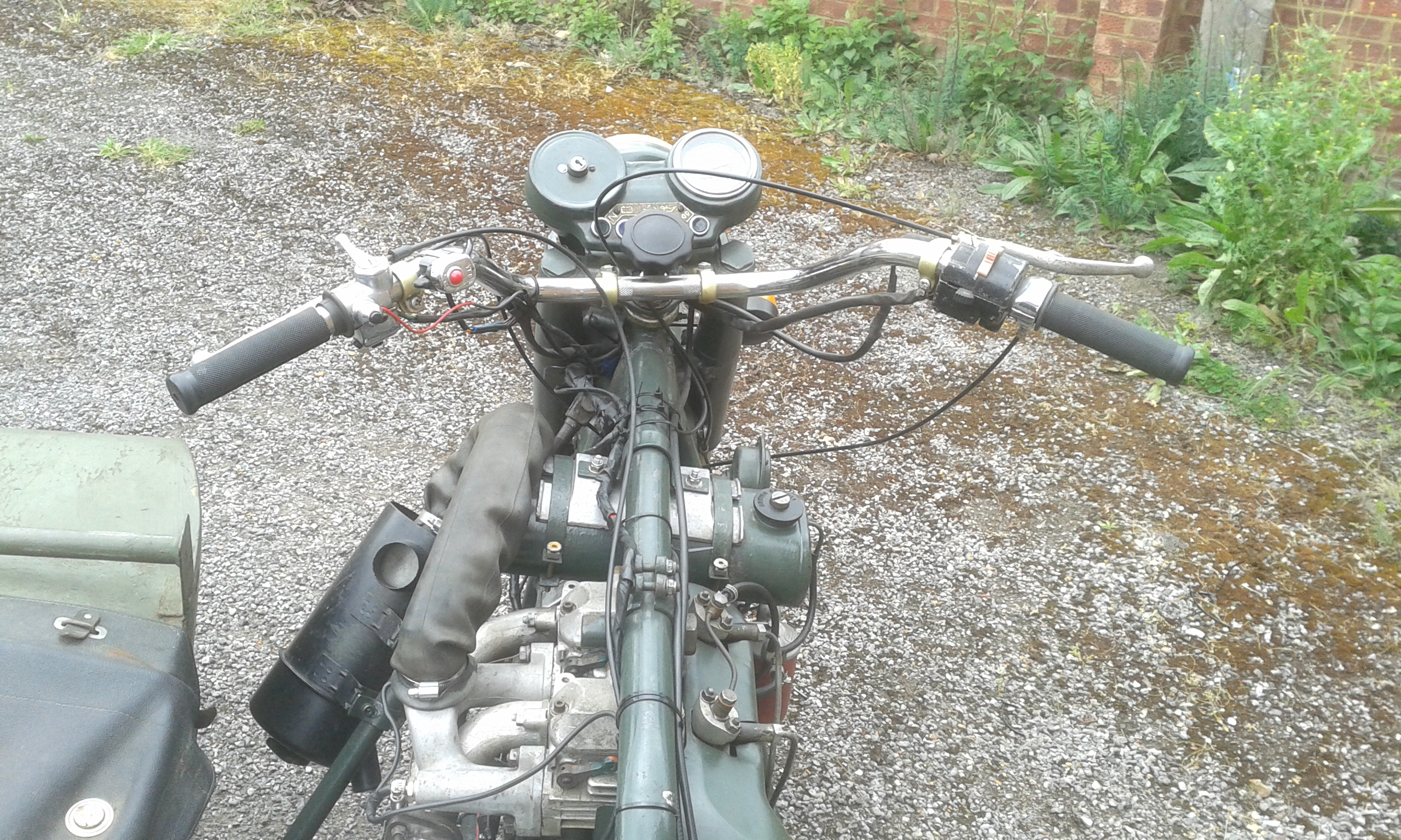

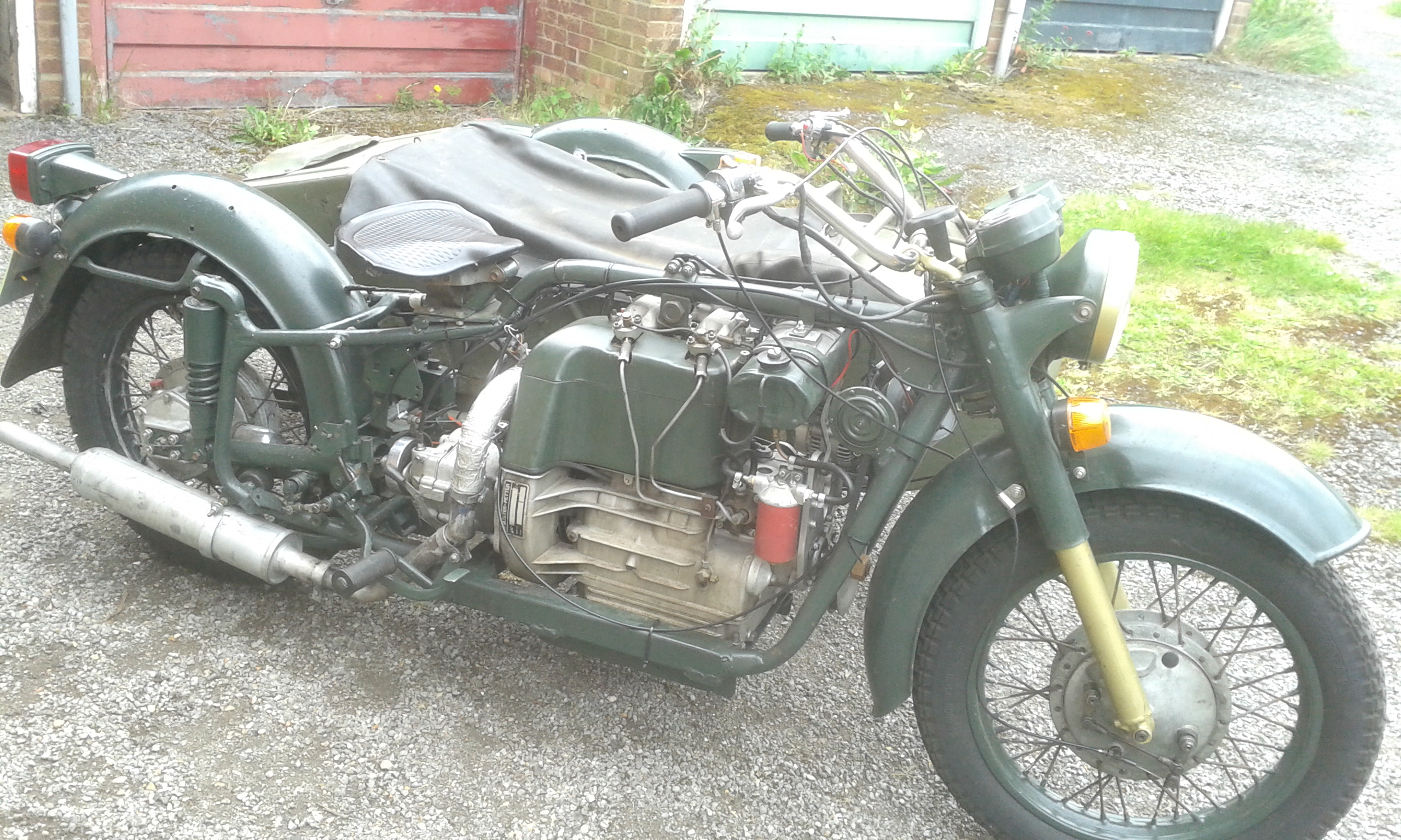

At last, after many years, this bike has passed its MOT.

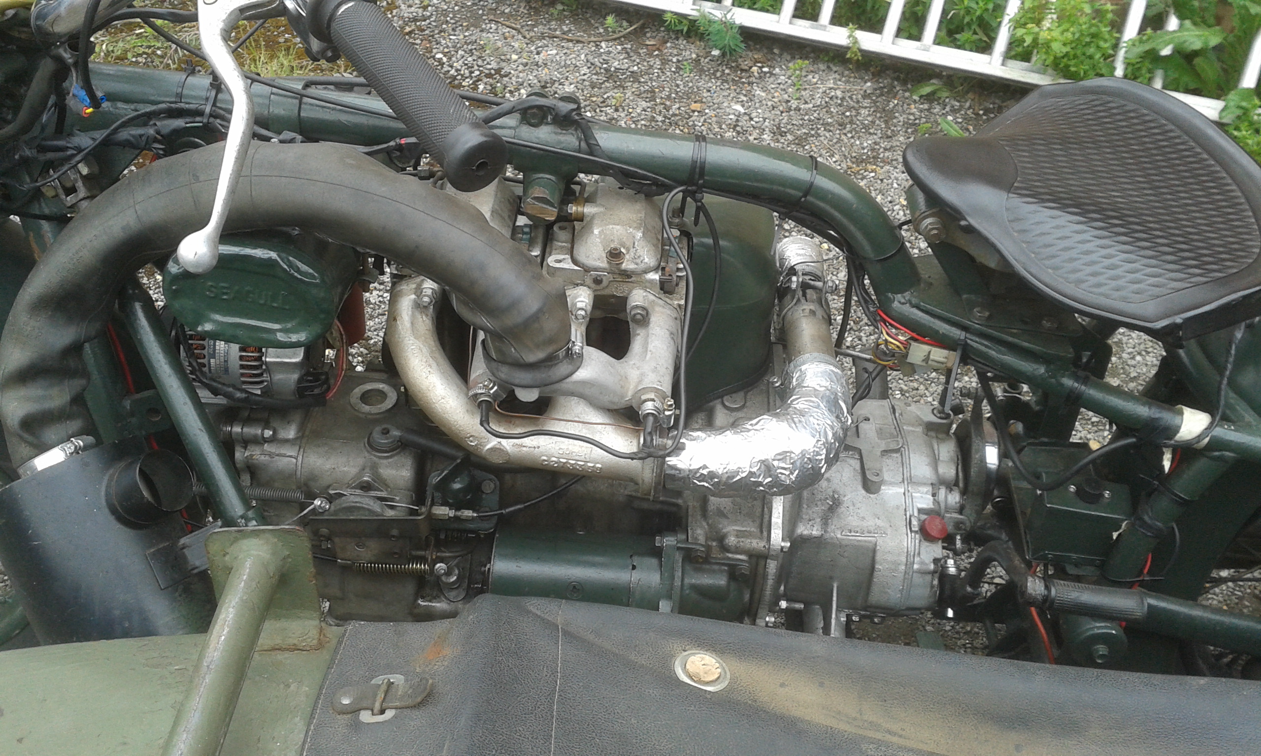

I had offered it for sale but dogged with problems starting the engine, I decided to spend some cash and have the starter re-wound and to replace the damaged ring gear.
Since then, I have abandoned car ownership, which means I shall need to use the bike for my own transport now.

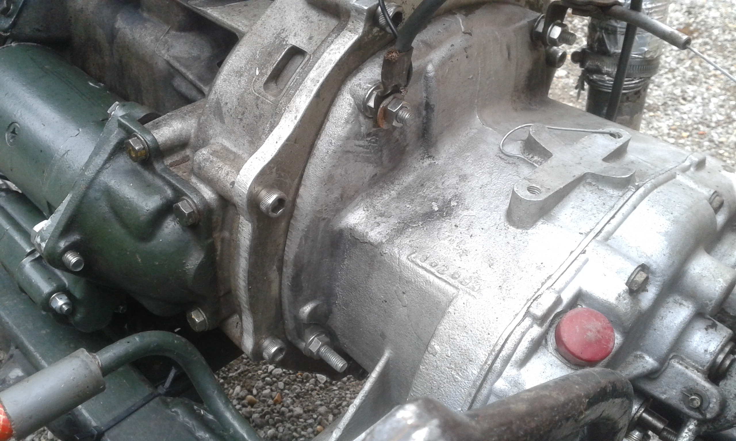

I may be able to upload some earlier pictures I took of the clutch conversion I had machined up, for those who may find it useful. The dnepr clutch basket had its inner portion removed and some holes drilled to accept screws to attach it to the Petter flywheel, which, in turn, was machined out so that the clutch would fit within it.
I am fabricating a dummy tank from glass fibre which will fit over the engine and provide protection and sound proofing as well as housing the air filter. Fuel will have to go into a 2 gallon round tank to be attached, pannier fashion, at the rear.
The engine is very second hand but still gives enough power to reach somewhere close to 50mph. With a top end overhaul and some fresh head gaskets, it should be dependable. However, it starts instantly from cold now it has its new armature, so I am content at present.
I welcome questions from you all. Regards.
