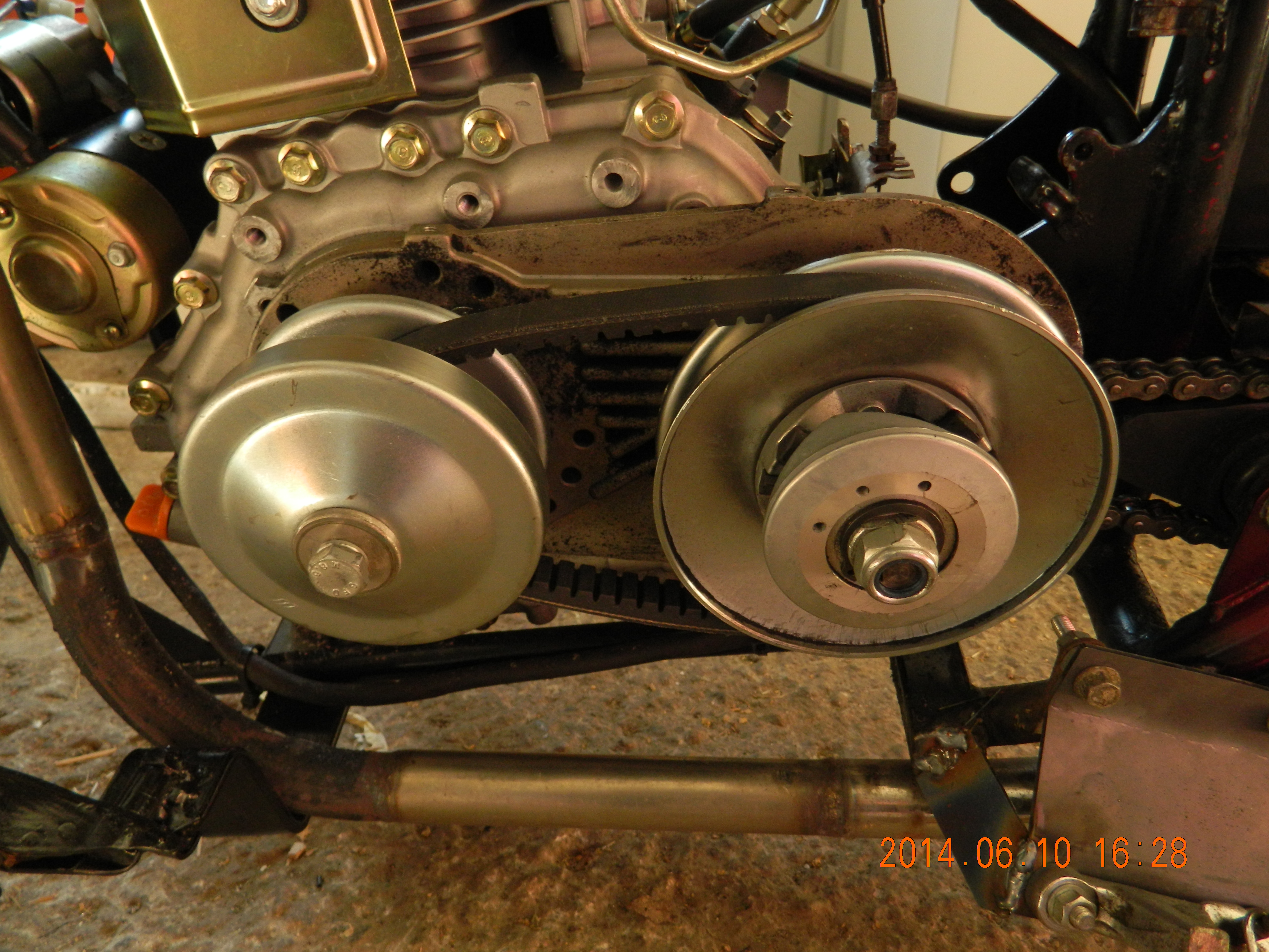

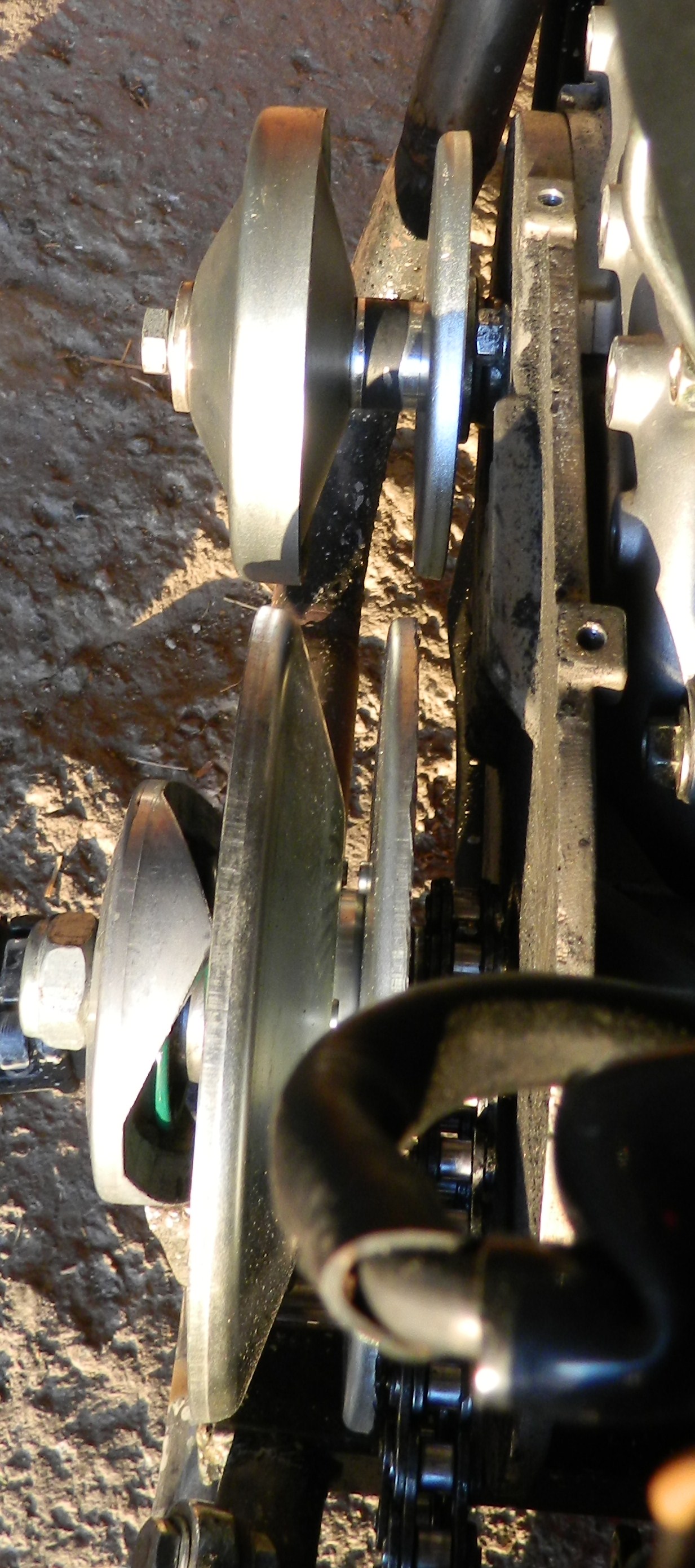

Well, I managed to make a spacer and move the front disc 6mm out. Now the discs are in line, and hopefully this will work. Now, the only trouble seem to be to find a belt...I thought Comet 30 was a very common cvt ? But here about - no belts

Re: CVT trouble - back wheel locks up
Okay guys, ther neverending story goes on
Now I have spare belts (two of them
) , the primary and the secondary drive discs are in line - but I still have the bloody same problem - when turning down the gas, even moderately, the back wheel starts to brake and the bike is truly difficult to handle.
I understand what is happening ; the engine rpm controls the primary drive and the secondary drive just spins on neatly and follow, ok ? But when the decrease of rpm is fast, is is like driving with a normal bike in 4th gear and then all of a sudden kicking in the first gear...
Even when I drive slowly 40 kmh and shut off the gas, (moderately) the backwheel brakes
I hate the thought of what will happen when an elk steps out on the road 100 meters ahead of me when I'm cruising at 90 kmh - there is no way to stop this bike and still have full brakeing control in such a long distance at that speed.
. A bit scary, in fact.
So - the question is how to tune the primary drive pulley so it does not brake that fast when rpms are reduced ???
I have a Suzuki QuadMaster 500 cc, with cvt-drive, of course, but no problems at all when turning off the gas, the engine brakes slowly and under full control.
Well it has a petrol engine, of course, but that can hardly have any much significance, since the system is similar, basically.
Or - would it be an easier solution to get a gearbox with clutch, like this one http://www.geminikarts.co.uk/files/Come ... nsions.pdf ??
Then one would be able to pull the clutch when braking and thus have more control...?
Thanks for any inputs !
hmmm.. ok something is fubared here. No weights? We need pics. there must be weights or cams or something to transfer cyntrifical force to one sheave of the primary pulley to make it move outward so the belt can ride lower and visa versa higher as the RPM drops.Peter the blacksmith wrote:There are no weights in the primary pulley.....
also to help you we need pictures and data on the secondary ramps/helix
I get the feeling this CVT is wayyyyyy out of calibration or not atiquate for the hp/torque rating of the engine.

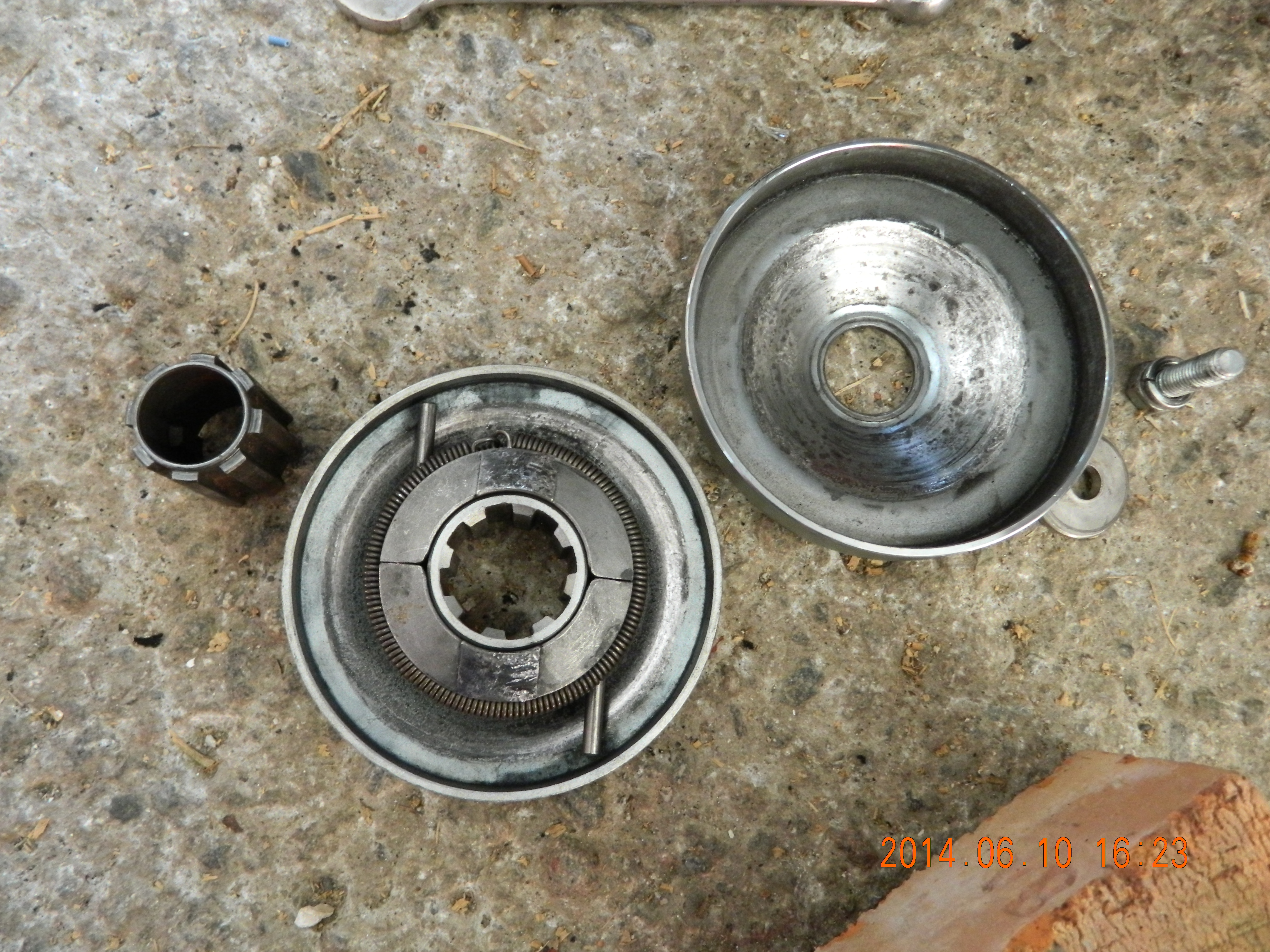

Ok I've been doing a bit of research as I don't know these comet systems.
You do have a weight.
When you open up the drive(front) pulley you will find a circular spring device,yes? (spring and flyweight assembly in diagram)
This is what opens up and rides up the face of the outer pulley. If you look one side of it is shaped to fit the chamfer or curve of the pulley/outer cover.
Look at the diagrams and make sure the spring ends are facing in the correct direction. I'm not sure if it can be fitted the wrong way round??
This has to be clean and in fact is supposed to have some light lubrication to allow it to slide.Nothing else needs light lubrication just the inner face of the outer cover and the outer face of the moving pulley.
l'd open it up and fully clean it with brake cleaner or similar and make sure the splined hub is free to move as in the video I posted.
I think what MAY be happening is that it is opening up but not returning smoothly and then suddenly letting go??
Once you do this and assemble it then I suggest you test it by disconnecting the chain and watch the pulleys to see what happens. That way you shouldn't cause any damage.
If it appears to be functioning ok then refit the chain and raise the rear off the ground and see if it still works.
That way you will not be putting any stress/weight on the pulleys or belt and if the problem is at the rear it should now show up.
Once again if that tests ok go for a gentle ride.
These clutches are incredibly simple with nothing much to go wrong
The cvt is brand new, so is the engine. Bought from shops in Holland.
BUT there is no spring in the front pulley. I remember I was a bit surprised when I took the thing apart last time.

Here, some photos, hope they are not too large :-/
Yes, I found a product sheet of the cvt in the engine manual. It said it was a Comet 30.
From there I also noticed the bronze bushing was missing. I think the belt sticks to the axle when I let go of the throttle, and that is causing the too fast gearing down that locks the backwheel. Could that be right ?

Here is the whole bike.

Looks like a lot of damage to the sliding faces??

thanks for the pics. Was very helpful. NICE BIKE.
I had forgotten how the comet primary/drive unit works. I can see the weights and spring.
Bushing may have something to do with it... but I still get the feeling the whole thing is not set up right. On the PDF found below.... the very last paragraph, on the last page, on the right margin of the page is a discussion about spring tension in the sencondary/driven clutch. Take a gander at that and see what you come up with
http://www.bmikarts.com/PDF/Comet_30series.pdf

Yes I was surprised at the wear of the sliding faces. But - they may have been there before I got the bike...back then the pulleys were not in line, and I know the builder/previous owner had to buy a new belt, due to that, suppose he lost interest then...well anyway that could be some old marks.

I think you are too quick in dismissing the marks/damage.
In order for it to work properly it should be smooth and damage like this will only cause problems.
If you blow the pic up there is some serious damage.
I still think your weights are sticking and either this has caused the damage or something is causing your weights to stick.
It could be the rear chain has caught on the rear pulley and caused the cvt to instantly come to a halt and the damage was caused then??
I know you said the former owner shaved some off to give clearance for the larger chain so he was obviously having problems??
I still think you should try running it without the rear chain to see how the cvt performs and observe if it is opening/closing smoothly.
After that refit the chain and with the rear wheel off the ground see if it all operates smoothly.
Don't get sidelined by the lack of bush in the pulley as this is a side issue that won't be affecting the front pulley.
I think you should be looking at getting the damaged parts replaced?

This is the picture you posted some time ago about the pulleys not being in line.
That rear chain still worries me as it's very close the the pulley and despite the former owner telling you about reducing the pulley edge it still looks to me that on the overrun or braking that the top run of the chain will become slack and is possibly touching the pulley and causing it to seize.
This would then cause the front pulley to stop and,as the pulley is still open with the weights fully out,it causes the pulley sides to turn against the weights.
If you blow the pics up and look at the state of the rear pulley inner it doesn't suggest that the edges have been ground off with any precision.
Is there any sign on the chain of rubbing or bits of alloy??
See if you can slide the chain sideways on the sprocket as he may have left the original size sprocket on there which is too thin for a heavier chain??
