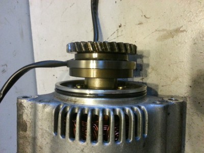

Yea, its from the larger GSX bikes. All the same as far as I can tell. I should have said but was a bit hung over when I wrote that.coachgeo wrote:Mouse..... I assume from another's comments that is a Suzukie motorcycle alt. and not a Suzukie car alt. Took gamble and bought Motorcycle one off ebay, pointed out to me by Petenpol. It's unknown condition.....
There is a cush-drive under the sprocket and that is held onto the alternator with a nut and taper shaft. See the photos....coachgeo wrote:The one on ebay has a gear attached. Does it pull off or did you cut it off orr?
.coachgeo wrote:Is it a Generator or Alternator thus needing something else to wire it up? Dc to Ac converter?
It is an alternator with integral rectifier and regulator. It is also easy to wire up as the thicker wire goes to the battery and the thinner goes to switched ignition.
I geared mine to somewhere between 2-3:1 because I had pulleys for that. I didn't aim to get it to be spinning as fast it would be in the bike and it worked with no problems. Also note that most petrol bikes don't spend much time at the top of their RPM range so I don't think there is much need to get the extra speed.coachgeo wrote:Also the Katana 600 it comes from runs at a much higher RPM. Did you calculate the size of your pulley to keep the RPM's of the alternatorimilar?
Yea, the oil ring is because the gear end of the alternator is inside the bike engine and needs the seal. I never bothered to waterproof any of it because the alternator is external to the engine and is generally exposed to water / salt and grit as standard. It is however behind the engine which would shield it a bit. The shaft bearing has double lip seals so they will keep the water out.coachgeo wrote:Looks like an O-Ring on Alt. Does the Alt need a cap made to snap over the end to keep junk and water out?
This is the back of the cushdrive and a small pully ( I think from a car alternator) with the centre hole enlarged to fit over the centre.
Then simply braze or weld it on.
Make your own mind up how to tension the belt. This is how I did it on the V twin but on the current Kubota Z482 I use a sliding idler wheel. (Note that the minimum radius a belt will work with is larger for a back side tensioner.)

Re: Kubota Charging system from scratch
A little lathe time and it's ready.
I cut down the hub to the exact same outer dimensions of the bearing.
You're going to love this. I was in the shop last night until Midnight working on this build and got up early this morning to fix a Mates Bike Issue. So after he bought lunch, he left and I got back on the Alternator mod. Since I was tired from last night I threw the hub into the freezer in my Motorhome and took a nap on it's couch. Then about an hour later I got up, hung the pulley on a coat hanger, dangled it in front of the blower furnace and heated it up. Got it nice and toasty. Just before the paint burned off the pulley I retrieved the Hub from the freezer and dropped it inside the pulley bearing hole and BINGO!
Let the parts reach room temperature and it is in there to stay. Nothing short of a 40,000 lb press will get it out now.
Front View. (I reinstalled the "C" clip just to see if it would go. So don't worry it's not holding anything together.)
Rear view.
Then bolted it back on the Alternator.

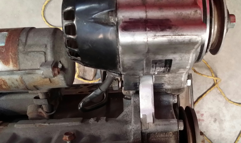

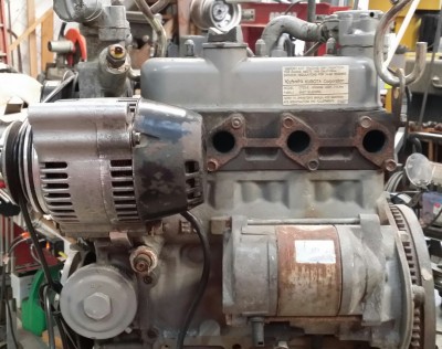

few more pics from curtusCurtis in Texas wrote:Almost have the alternator ready to mount. Will post pictures when I get it done. Broke my special little sander I need to finish it. Looks like I'll be buying another little belt sander. No surprise, because I've abused this one for years.
Alternator housing slotted to create a tightly tucked close into the engine alternator. This is pivot point for adjustment. Mounted to OEM tab on block (tab end modified slightly for clearance). Pic is shot from above with alternator swung out wide on pivot point created with this slot
Front View. Note the Alternator housing's mount tab sitting closest to block. This will be the one utilized for belt adjustment setup. Will at some point cut off 3rd mounting point on the Alternator housing to keep nice clean lines and unnessisary width
Just enough room for Headers. Note how using the Triumph Alternator end cap puts the breather holes toward the bottom where the Suzuki were more exposed to the elements. But then again. Ground muck kicks UP off the tires while clean rain kicks down... hmmmm. so maybe Suzki would be better after all??

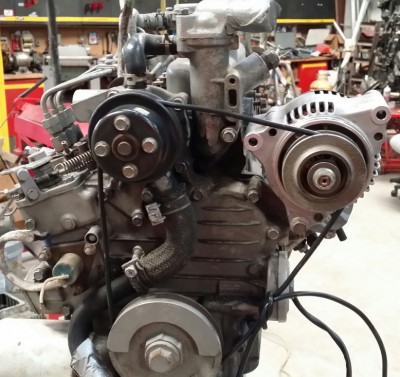

Alternator almost done. I want to build a brass insert in the engine tab for the bolt to ride on since the tab is aluminum. Here's the Alternator with the new belt on.
It will work like this but for a longer trouble free life I think the bronze bushing will be just the ticket.
Here is the adjuster I made out of aluminum.
Doesn't look like much in the picture, but I milled it out of solid 1/2 inch aluminum plate. Might anodize it before we ride the bike! Then it would look a lot better.
AND, I might still cut that extra mounting hole off of the alternator. But I think I'll wait to see if it causes a problem once we start mounting the engine in the cradle. FYI the alternator sticks out just a little more than the starter motor, measured off the face of the block. And I"m only talking about 1/2 (26 MM), so I don't see it as being a mojor obstacle.
So George, we can pretty much call this problem fixed. Well, we do have to test this alternator to see if it's going to work, but, even if it doesn't it will just be a matter of getting it rebuilt.
