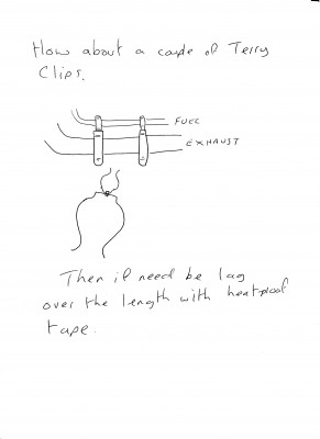

How about this idea?

Eddy Wane wrote:How about this idea?
Yeah, you could put Heatsink compound under the clips to help transfer.
Re: A way to heat fuel
I like that idea, althought I dont think it will put that much heat into the oil, I think the pipe would have to warp around the exhaust pipe, but then we have the issue of overheating the veg.
You would need to form the copper pipe in to a coil larger than the dia of the exhaust pipe so that it is not actually touching.
Possibly another idea might be to wrap the exhaust with a couple of layers of heat wrap which might bring the temp down to acceptable levels??
